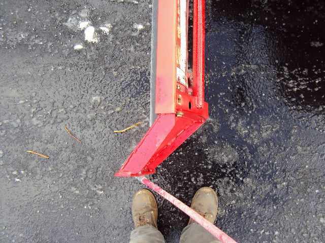

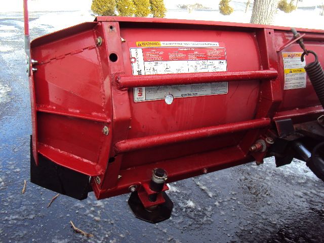

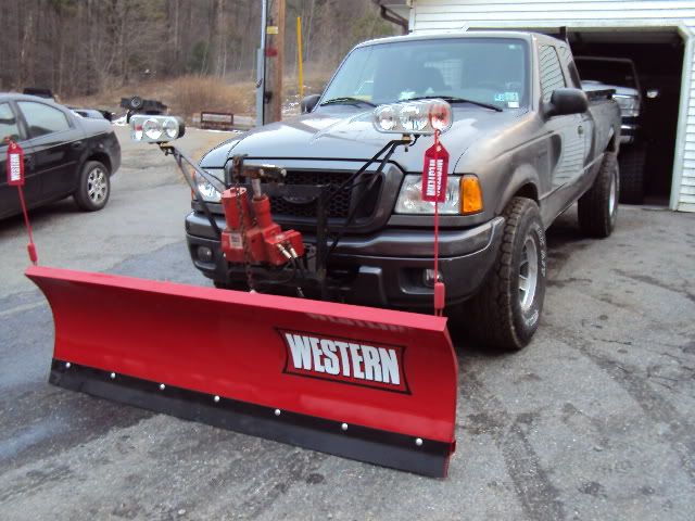

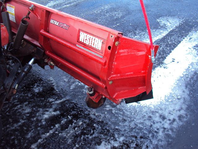

I put a Western 6.5 SUV blade from a 94 on my 04. had to widen the frame by ONE inch. The harness was all plug in. I was sick of plowing with the 4 wheeler and Constantly having to get one and off to angle the blade. I am more than pleased with how the ranger plows(this is my 3rd with a plow). I will say my torsion bars do not like it though(even have the #1 torsion bars in) and I have Timbrens too. Now I know why they only sell the plastic plows for the 98+ trucks.
I am in the process of putting in the coilovers and debating on doing the 4" super lift.
I also added some custom wings to make my plow 7.5'

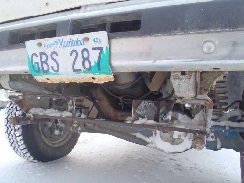

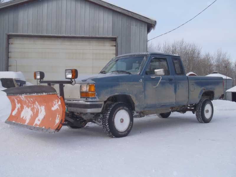

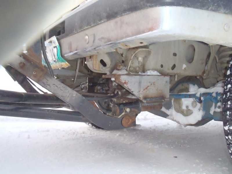

For what it's worth (Note that it's STILL dirty from fall........)
NOTE the two electrical connectors..... the Semi 7 pin version is Low, High, Running, Left & Right, plus Ground.
On the far side is a 4 pin version (2 each tied together for the winch.
I used metal cover connectors for a reason.... plastic ones get so cold they break ! (found that out the hard way the first year...)
