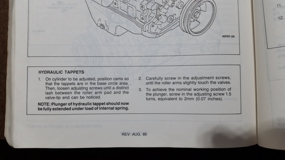

I appreciate your suggestions, but we need something better than just feeling when you're 1/3 of the way into the stroke of the lifter's piston. Each 360° rotation of the adjuster is approximately 0.0465", and Ford says 0.070" (1-1/2 turns) is the needed adjustment. I feel safer going with a calculated adjustment, than with guessing when you're 1/3 of the way. I know this isn't rocket science, but a little science has to be involved nonetheless. If you were to experiment with your fine tuning, and then determine exactly how many turns past zero lash you averaged, that would be information that most people could use.
@gaz
It pained me to read my service manual and be told "NO VALVE ADJUSTMENT IS POSSIBLE"...INCORRECT.
I don't know what service manual you have, but I have the 1987 Ranger/Bronco II Shop Manual, and it clearly says they can be adjusted, and gives the procedure for doing so. In fact, every manual I've ever owned gave the procedure.
STEP #1
