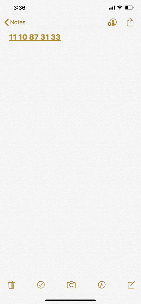

Here’s the codes it was throwing. Disconnecting the vacuum in the egr makes no difference
11 System checks OK
10 place holder not a code
Memory codes
31 EVP signal is/was out of range
33 EGR did not open/ respond during test or if memory code, did not open intermittently
87 Fuel pump circuit fault (check inertia switch)

Because its an emissions system 31 usually means EGR sensor didn't show it was opening(not that it open too far), which is confirmed by code 33, it didn't open when tested or when driving
If you swapped out EGR valve and sensor(EVP) and got the same codes then must be wiring, or connection at EVP or Computer
But shouldn't cause running issues
87 means the Computer didn't see the 12volts from Fuel Pump relay closing and sending 12v to fuel pump on pin 8, if engine is running then erroneous code, may have been set during other testing if you pulled FP relay or fuse

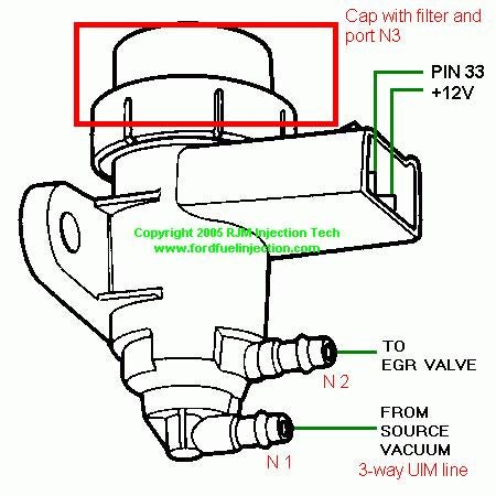

Don't forget the solenoid that controls the EGR. It's what the computer uses to apply vacuum to the EGR valve. It's usually mounted over on the pass side fender. And it has a foam filter under a plastic cap that gets dirty and is never cleaned. When the valve blocks vacuum to the EGR and wants it to close, it has to let air into the line so the EGR will close. This air comes through the valve through that foam filter. Here's a picture.
evr_diag-jpg.38033
