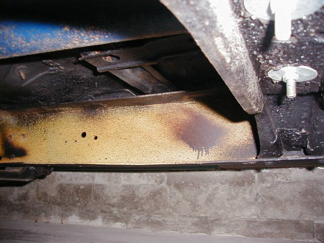

On the Ranger I removed the body/box, had is sand blasted then an epoxy primer/sealer put on...after that I painted everything with yellow rust paint...especially in the frame rails, then painted the outside of the frame rails and any front-facing parts with Rubber guard...
I had pics but lost them when my HDD crashed...but it looks much better...and probably won't rust out for a few years anyways...the only pic I have left shows the inside frame rail...
