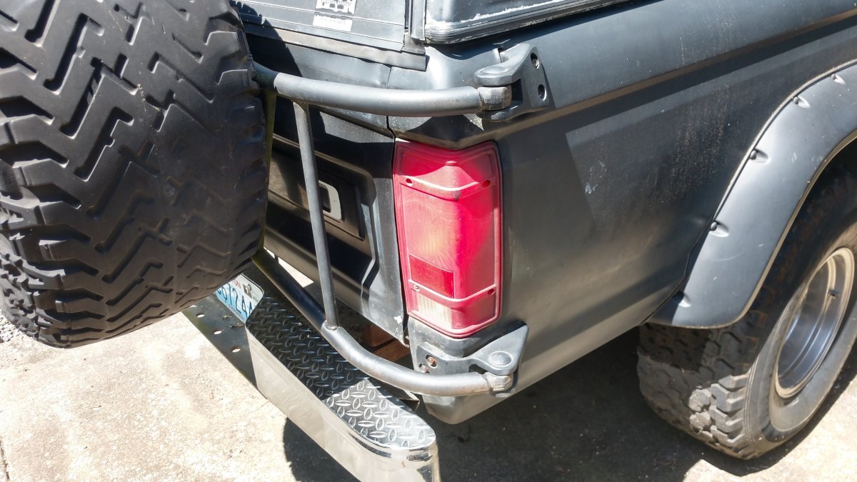

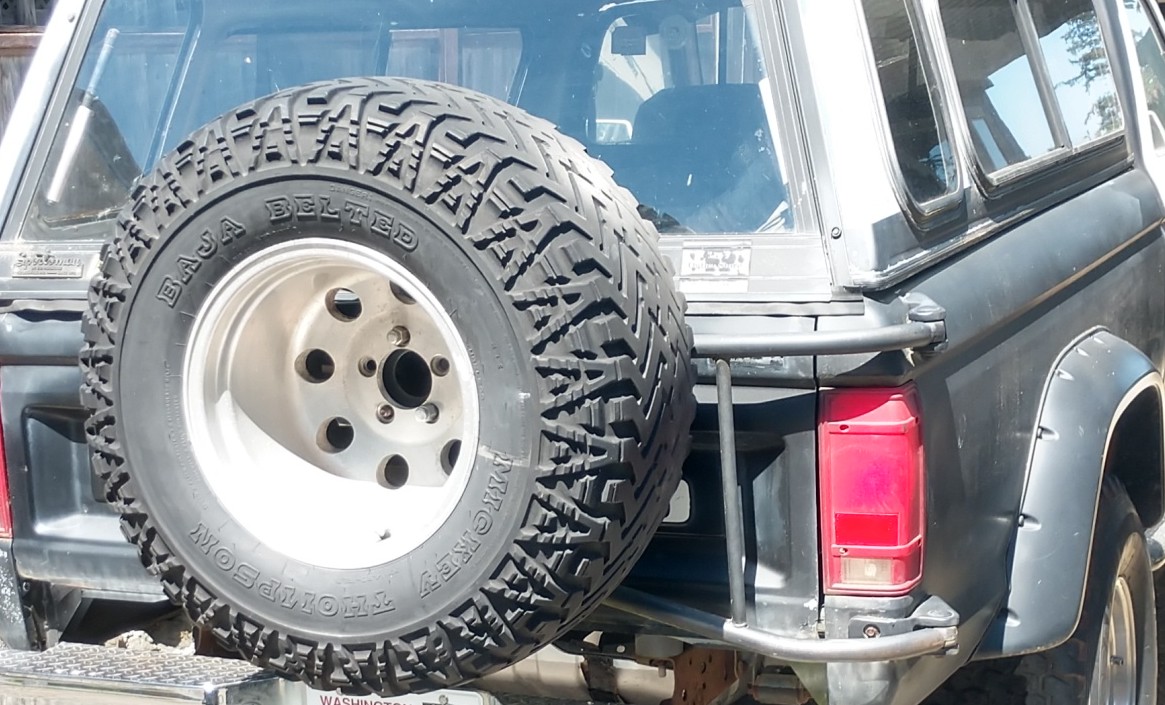

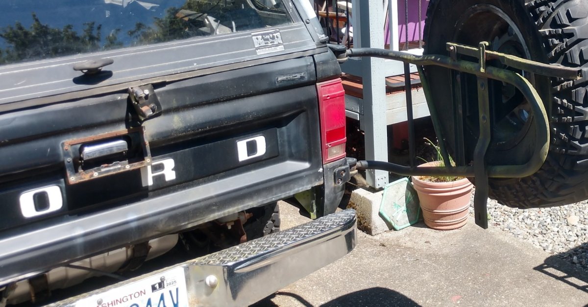

I didn't want to pay for the swing out tire carrier bumper so I used a BII tire carrier on my Ranger to make more room to haul stuff. Not my best work but it has been installed since 1994 or 1995.
Works great, later it inspired me to use the 23gl BII fuel tank behind the axle.

My installation could have easily been improved in 2 areas:
1) the upper bracket mount uses 3 fasteners. If I had a welder at my disposal, I would have attached a gussetted support for the 3rd fastener, which is not visible as it is under the quarter panel skin.
2) I would also have welded a perch for the latch bracket on the tailgate, to better spread out the force of the hanging wheel.
NOTE:
It has always had at least a 33×12.5 but that bias-ply Baja Belted is a 33×13.5...this setup is not bothered, in the least, by the weight of the wheel.

If you source a tire carrier from a BII, get all the hardware bosses from inside the quarter panel (I'm pretty sure everything was accessible thought the brake light access) make the corners for your cuts round and add the interior support for the upper bracket if possible.
The tailgate will support the bulk of the mass, nearly 100%, while the wheel is on the latch. I have always swung it out as gentle/easy as possible to promulgate the least load on the body thought the 2 hinge brackets.
