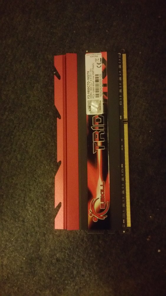

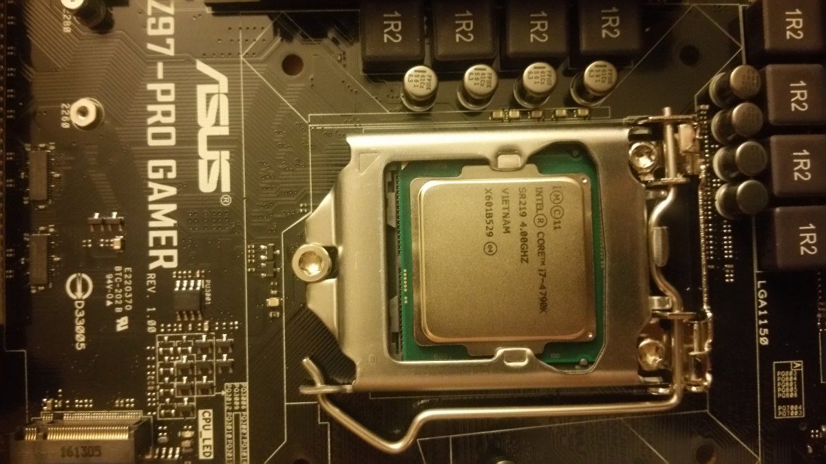

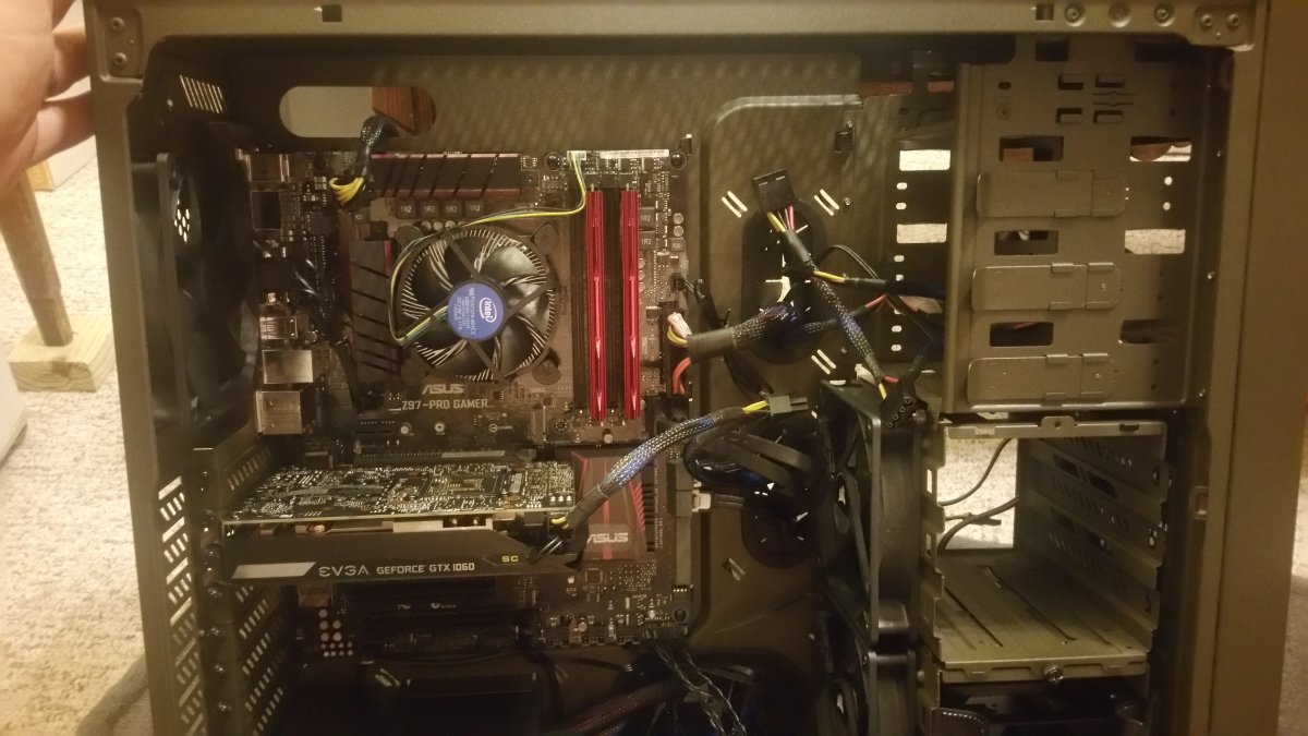

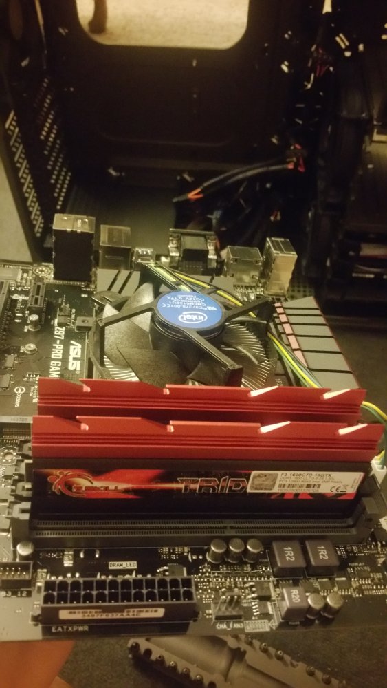

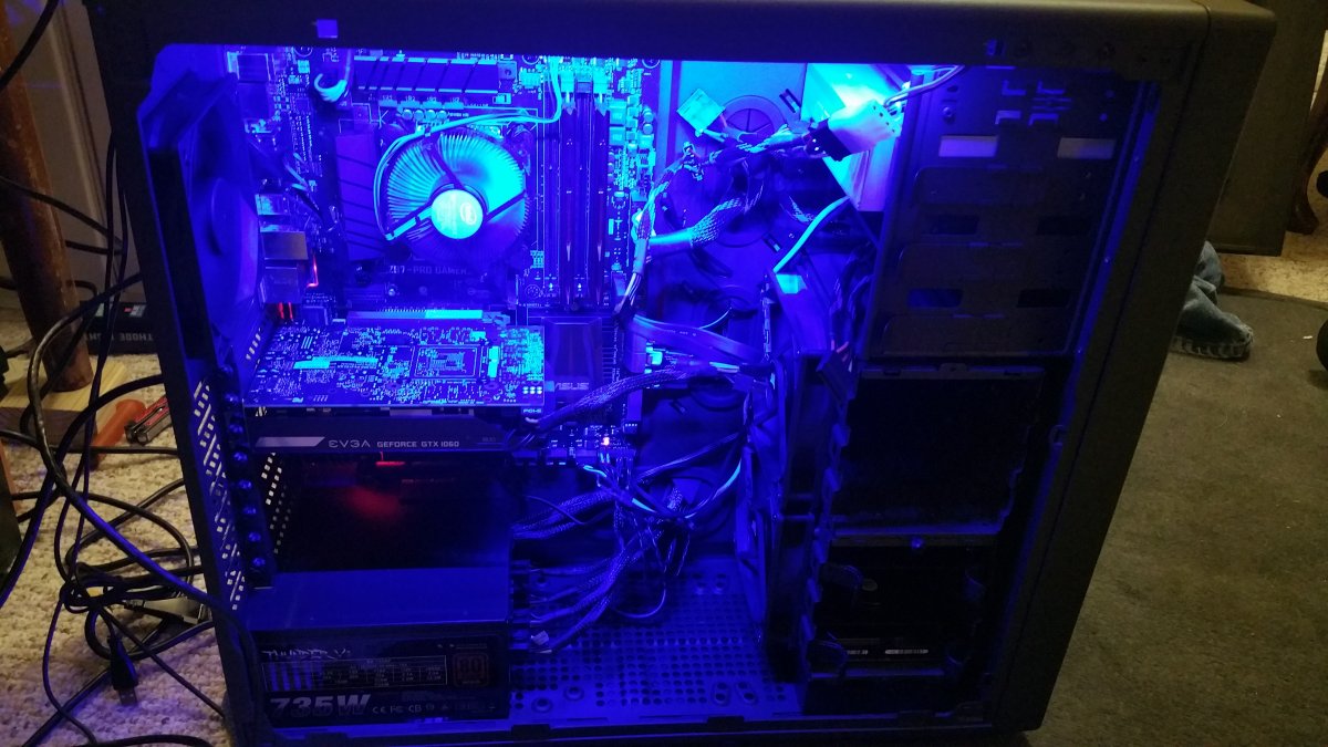

in October of 2016 I decided to retire my old system Dvader 2.2 and build an entirely new system Dvader 3.0. decided to start from the ground up on this one, as most of the old computer was at least 7 years old and the case was 12 years old.
Here are the specs:
Dvader 2.2 is starting to show its age, it does not play well with windows 10, and is starting to act flakey. It is almost 8 years old, so time to build a new system.

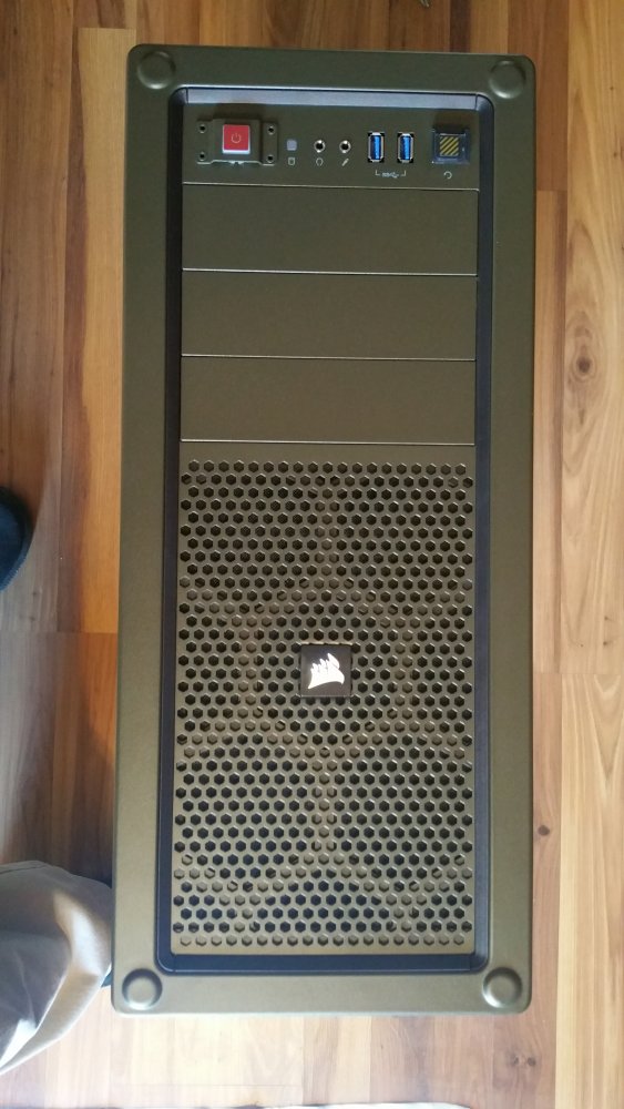

I am really happy with the case. it is all steel, the only plastic on the case is the plexiglass windows and the switches. everything else is metal, even the front clip and drive bay blanks. very well built
Windows 10 Pro on it for an o/s, and I already have Office 2013.

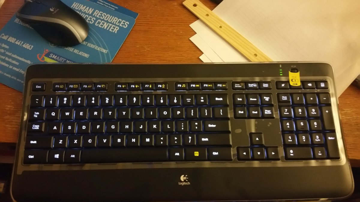

Keyboard batteries last over 2 months with daily use before needing recharged. the mouse has been upgraded with a Logitech M705, the batteries are supposed to last 3 years.
Here are the specs:
Case: http://www.newegg.com/Product/Product.aspx?Item=N82E16811139015
Power Supply: http://www.newegg.com/Product/Product.aspx?Item=N82E16817152047
Mother Board: http://www.newegg.com/Product/Product.aspx?Item=N82E16813132412
CPU: http://www.newegg.com/Product/Product.aspx?Item=N82E16819117369
Graphics: http://www.newegg.com/Product/Product.aspx?Item=N82E16814487261
SSD: http://www.newegg.com/Product/Product.aspx?Item=N82E16820147372
RAM: http://www.newegg.com/Product/Product.aspx?Item=N82E16820231628
Keyboard: http://www.newegg.com/Product/Product.aspx?Item=N82E16823126194
Glow Tube: http://www.frys.com/product/8057964?site=sr:SEARCH:MAIN_RSLT_PG the glow tube has been changed to a blue LED within the first week after I built the pc... the neon one from Frys was a piece of junk lol
For monitors, I have an Acer 24" and an hp 22" the Acer was about 120 bucks, the hp was free.
The thing I am kicking myself over is that I did not go with an M2 PCIe SSD. the cost at the time drove my already over run budget for the build by over $100 bucks. what is realy interesting now is that I can get a PCIe M2 drive that is 1 TB for less than I paid for my 250GB SATA III SSD 3.5 years ago... may have to upgrade.
I also have a 3TB Western Digital SATA III spin drive for data. so far that has held up pretty well. As I get some money free, I want to get 2 more 3TB drives and a Raspberry Pi and make a network storage drive that any device on my network can access. this will be great for my digital movies, pictures, and music.

I love my new build. Got the fan control set where I want and it hasn't gotten above 51c. Looks great on your end 97.
