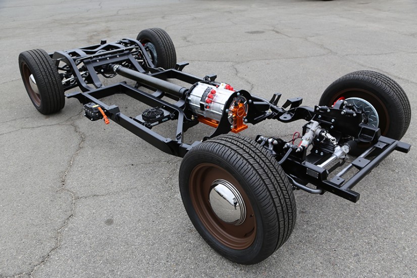

ICON are the only ones that I've seen who tackled splitting the battery up in their Tesla powered Mercury. They started with an 85kwh battery pack. Not sure if they still have the same capacity or not after splitting it up, but they estimate a 150-200 mile range which would be much lower than the ~260 mile range the Tesla would have with this battery pack. Some of that is worse aero, some of it comes from drivetrain inefficiency (driveshaft and ring/pinion differential) but I'm guessing a chunk of it also comes from splitting the battery up.
Again, they used a full custom chassis to make it all work together:
But they chose to split the battery, with some in the "engine" bay, and some in the trunk/passenger compartment:
That's cool and what I was saying by make the batteries fit. The folks at ICON are hardly the only ones doing it, and they definitely weren't the first. Another example that is a little more practical IMO is the Z car recently built by throtl on YouTube. There have been a bunch more examples I've come across over the years, that's just about the easiest to provide.
As for the reduced range the points you make are valid. I'd say that they likely sacrificed some battery capacity in favor is styling. That car is probably driven 50-100 miles max per outing, probably half that, so they could give up capacity to fit the styling they were after.
