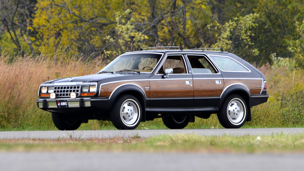

@Blmpkn can have his eagle
That would be a Gremlin, I believe. Or it could be a Pacer. But, the Eagle also had a two door sedan.
Gremlin and pacers were before the eagles and were 2wd and just came in two doors
