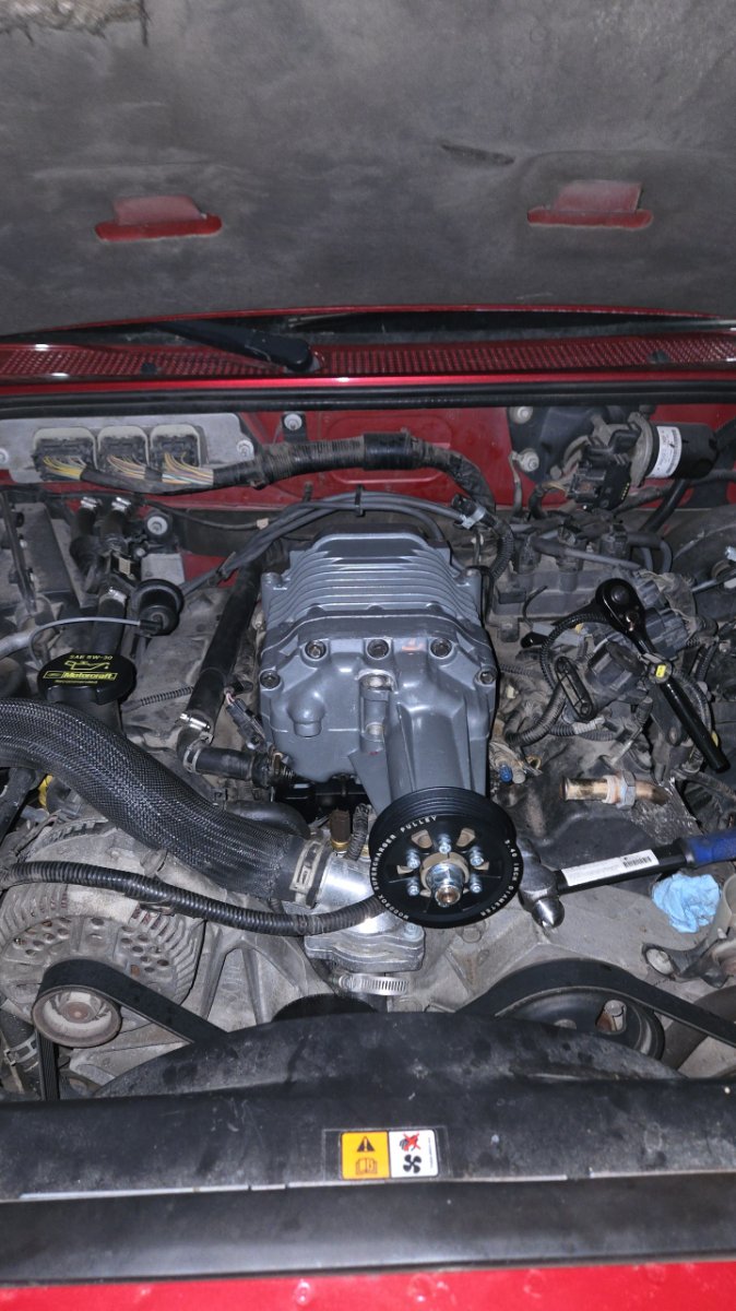

Received Tracking. Here's an old pic of the engine bay, post surgery for a new water pump, thermostat housing, and every coolant hose. And another old pic, just prior to new valve stem cores on all four corners🤣

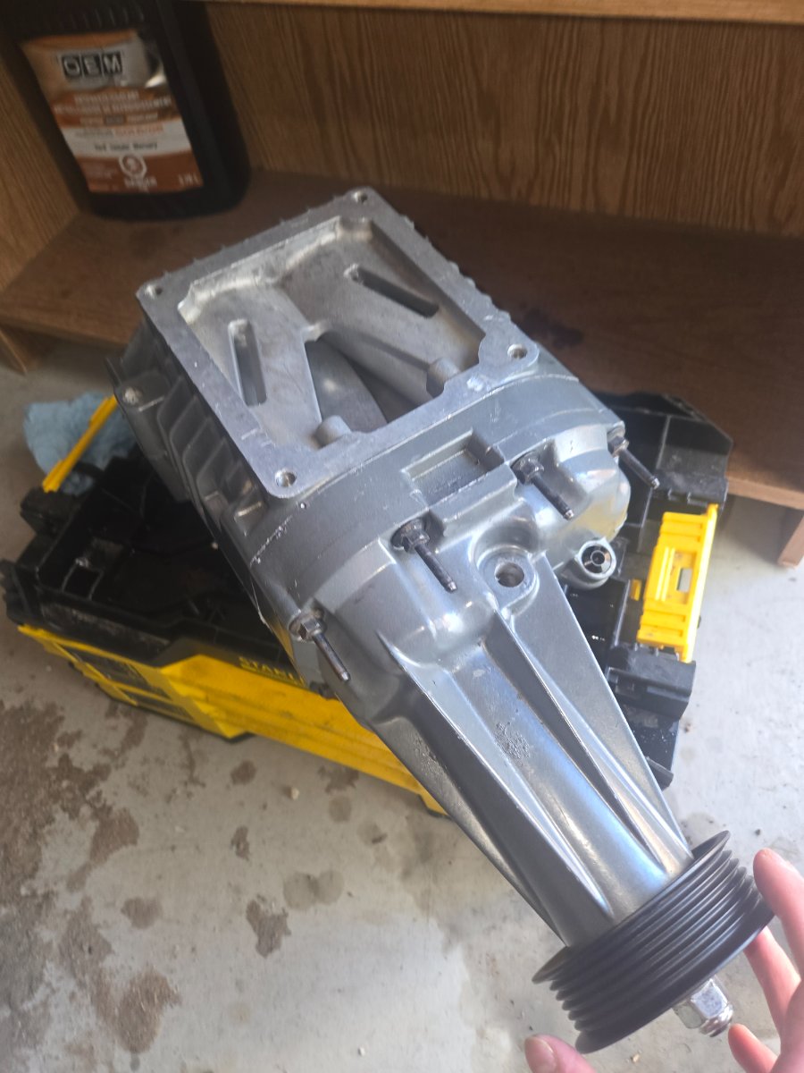

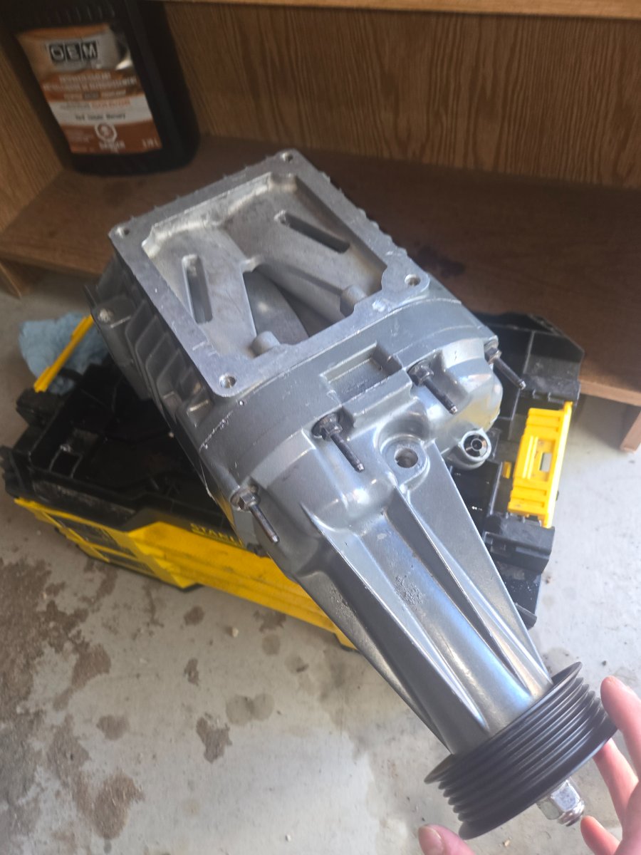

Now the next step, once they arrive, is case needle bearings. I greased the old ones and reinstalled them after mangling the new ones from my rebuild kit by treating them like ujoint cups🤣
The blower sounds great with a rebuilt snout and an impact on the old pulley, but its typically better to play it safe when dealing with a 30 year old blower. It's a shame the remanufactured units are perpetually out of stock.

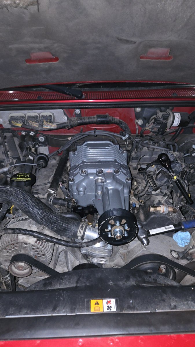

Some progress, some older pics. We're at the "odds and ends" stage now. Oh I guess I should run new hose for the evap valve to intake, oh I guess reusing the ford quick connector makes the most sense, oh I gotta retrim the brake booster vac line so the egr doesn't melt it...
That looks good sitting on there.
Lol it's been running great so far! It only left me stranded once! I made a mistake of installing the hub when it was -4C outside, couldn't heat it up enough with the torch to seat the hub. This lead to me throwing a belt on the coquihalla, and subsequently shredded the belt 20kms from my destination! Had a belt delivered to me, turned out fine. Ended up putting a torch on the rad angled at the pulley hub. Walked away for 10 minutes than hit er with the impact with a screwdriver to hold the hub still. Seated perfectly, temperature for this day was about 28C

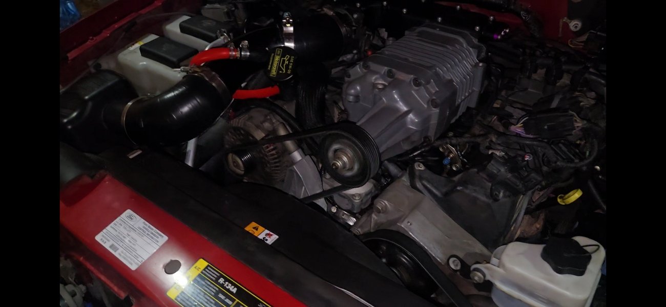

Okay, let's discuss idler pulleys for a second. The bearings on idler pulleys just love to walk out on me- the only decent off the shelf option has been AC delco. I found deleting the dust cover on the idler pulley significantly improved the way the belt rides. I ended up replacing my alternator bracket as it was bent... crazy, right? Even crazier was the bad bearings in my power steering pump that was perfectly serviceable and leak free.
I've put 5000km on it since I last put her under the knife, and the belt has done nothing but track true. I still feel as though I need to throw an aftermarket idler pulley on with snap rings, but that's an eventuality, not an urgent priority. Worth every cent, to anyone considering the purchase:)

That's looks really well done!
