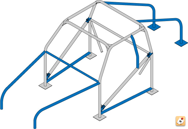

How much material would it take to build a cage like this

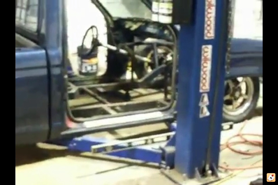

And i plan on building a tube chassis of 2x3 tubing and tying the cage in to the frame like this and building my own floor pans after i weld the cage to the 2x3 tubing.
