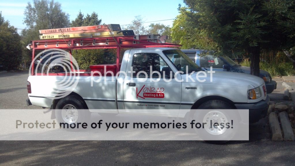

Yeah I have a 2001 4x2 ranger that just got some 31's on it. What year is your truck?
I can throw a pic up here of mine if you want.
That's a 2001 with 31's. I thought it was stock but it actually has about 1" of lift.
