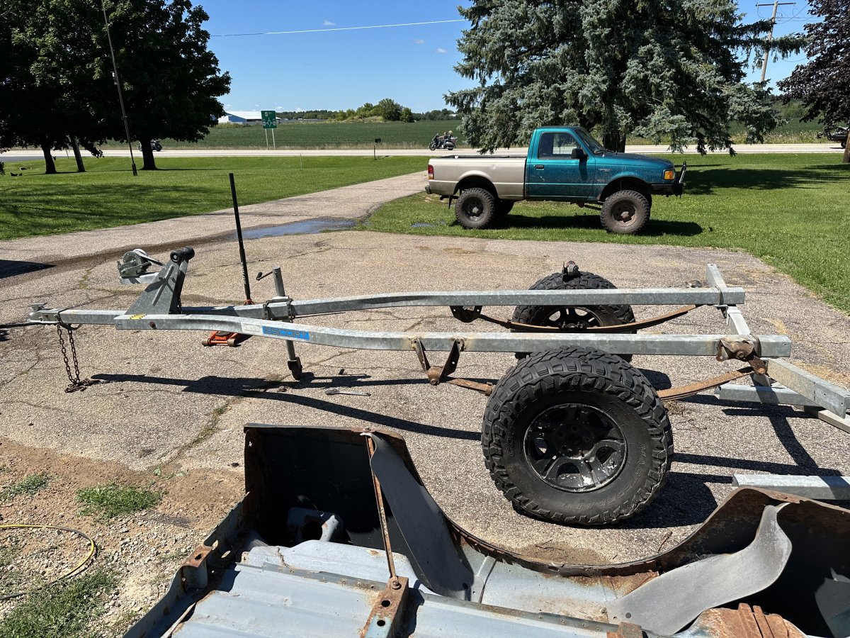

So a couple years ago, I had boats and boat trailers falling in my lap left and right. I kept the two best trailers with the intent of building a new utility trailer. The utility trailer will end up being somewhere around 6’ x 10’ or 12’.
The other trailer is galvanized, about 16 feet long and the rails are 33” apart outside to outside. This happens to be almost exactly the width of the rear frame rails on a Ranger (32-7/8” if I’m not mistaken).
Plan is to use the original bed off of my truck. It’s rusty as all heck but the floor, supports and entire inner structure are solid. The axle will consist of an old 7.5 I have laying around with the old leaf springs from my truck.
To mount the bed, I’m going to drill holes to match the original mounts in the frame, sandwich treated 2x4’s inbetween and I’ll cut access holes in the frame to get nuts on the bolts.

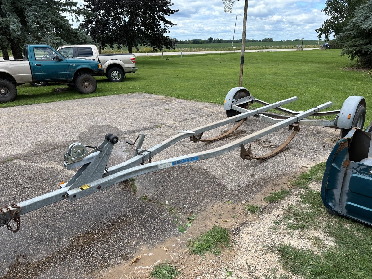

here is the start

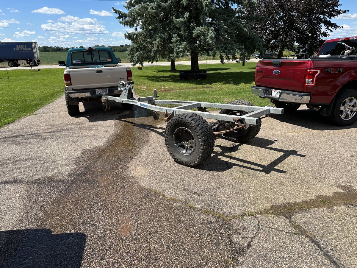

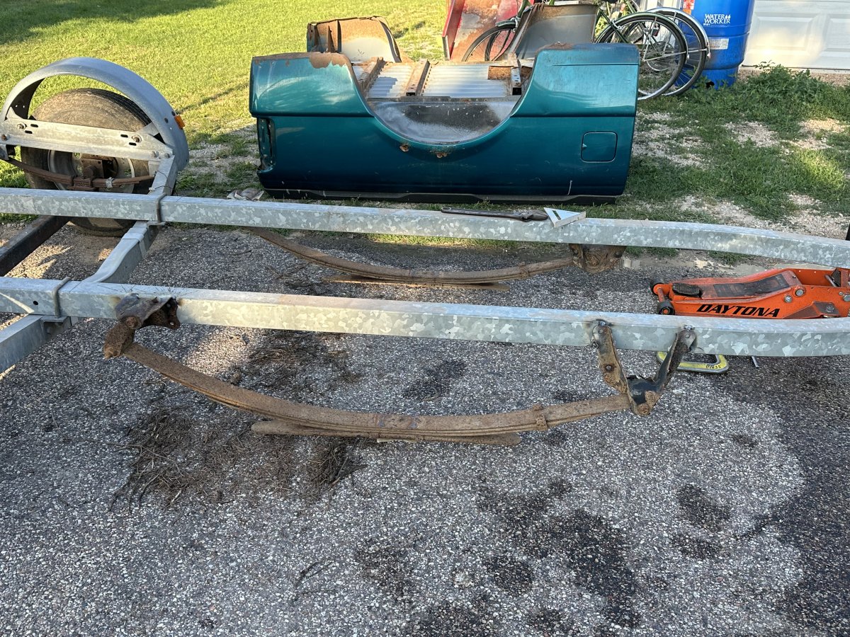

springs tacked on. I need to add some angle iron to the front hanger to stiffen it up. Probably also run bolts for safety in case a weld cracks.
Hopefully get the 7.5 under it tomorrow and cut the back of the rails off. I’ll keep the super heavy boat trailer axle for my utility trailer. That may end up being a tandem axle.

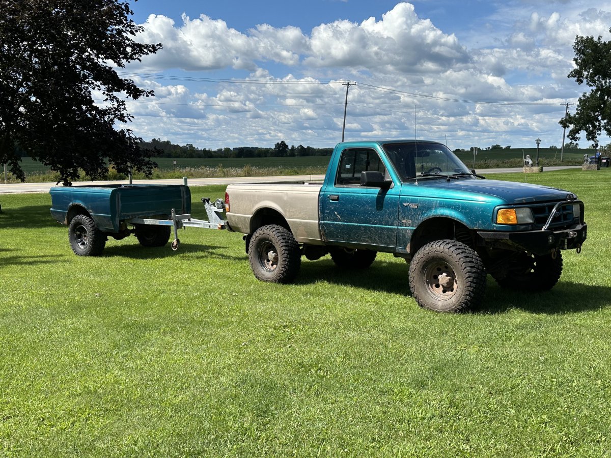

About half way done. I need to shorten the tongue yet and bolt the bed down then it can be wired up.
That thought also crossed my mind. Truth is, it’s probably going to stay how it is and never bother me.
