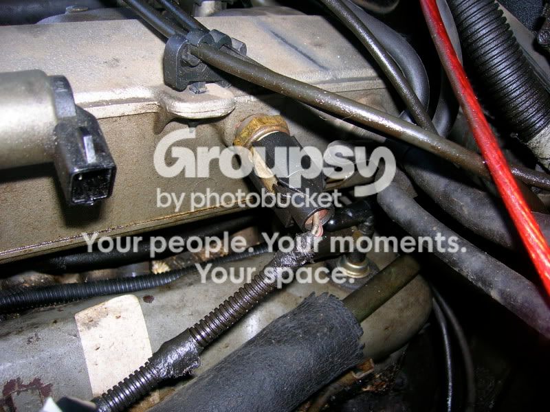

started the tear down today. its ready to be pulled out. there was 2inches of oil in the coolent res. on to the pics
well, looks like a nice head gasket job.
