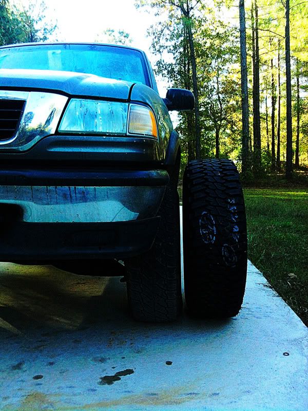

Here is the only pic I have of the truck from close to when I got it 4 years ago. It had Maxxis Mudder 31x10.50's which were the worst tires I've ever owned! They measured 29x11.50 and were loud and heavy and just junk. Don't buy them.

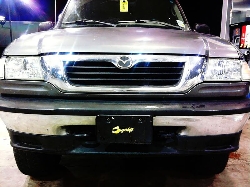

Here is the grill I picked up from the u-pull-it place. The headlights and grill combo were higher than I wanted to pay at $120 total but still cheaper than new online and in like new shape.

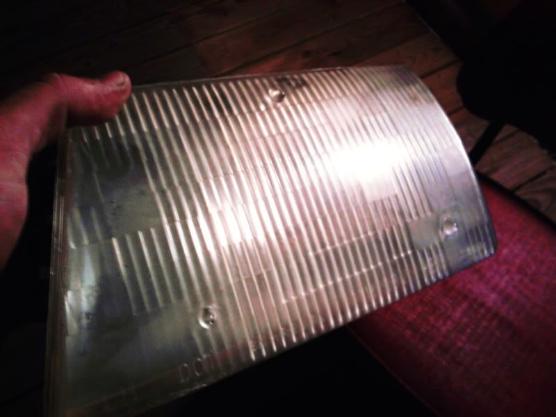

The old lights were grungy and buffing them out didn't help. Even clean the etched glass just looked dated.

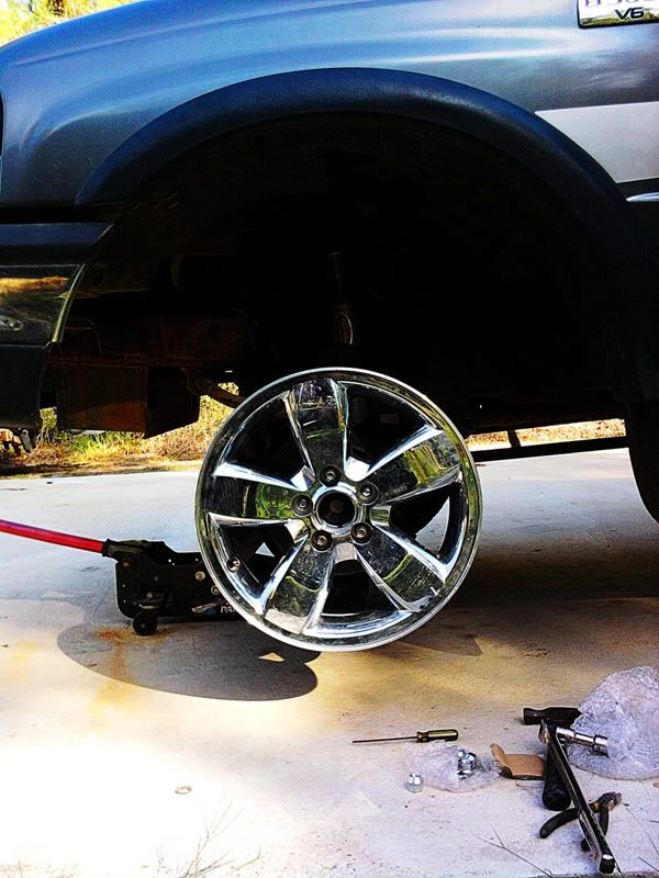

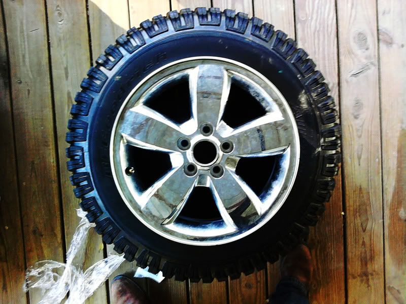

Rims in. $220 shipped for all four!
Rims on. Had to take the vaccum hub off to get them to fit. Also found a potential issue where the tires might rub the spindle because the rim had little offset so billet spacers were ordered to clear the hubs and solve the possible rubbing issue.

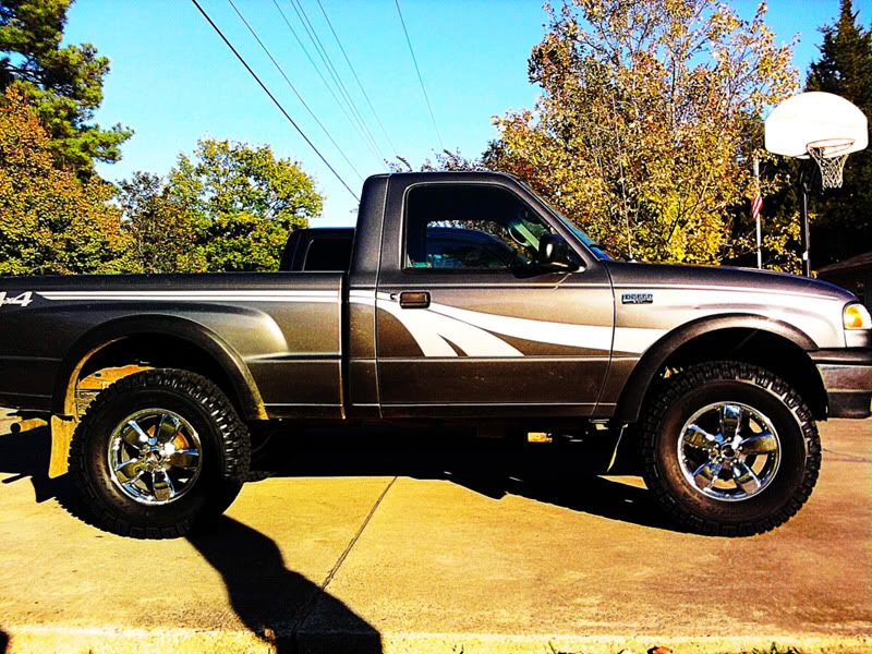

Installed. I'm so happy. It looks insanely good in person and the tires are freaking huge. 33.3x11 with a 9" tread width

Headlights: Those who say you can't swap newer headlights into your older model are dead wrong. It's a straight swap from the 2002 I got my headlights out of. The clears are much brighter and really update the trucks look. Go to a u-pull-it near you and get a set!
