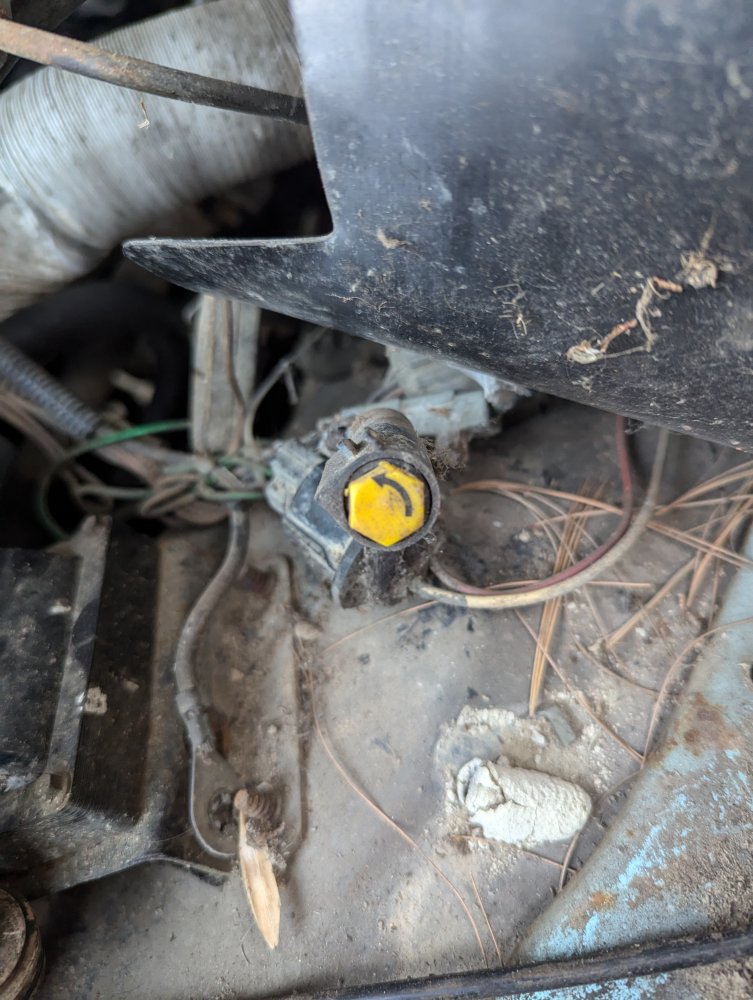

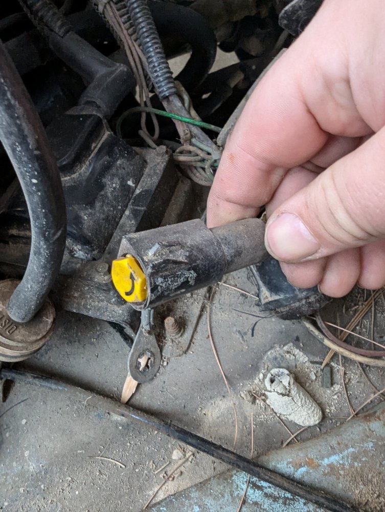

Anyone have any idea what this thing is? I found it tucked by the ignition coil. I'm kinda hoping if I turn it enough the Sequel will revert to its old glory lol.
That's not original. It's an electrical plugin. Looks kinda like the one meant for an underhood light. The yellow part came from somewhere else. Looks like the kind of plug that comes on rebuilt power steering pumps.
