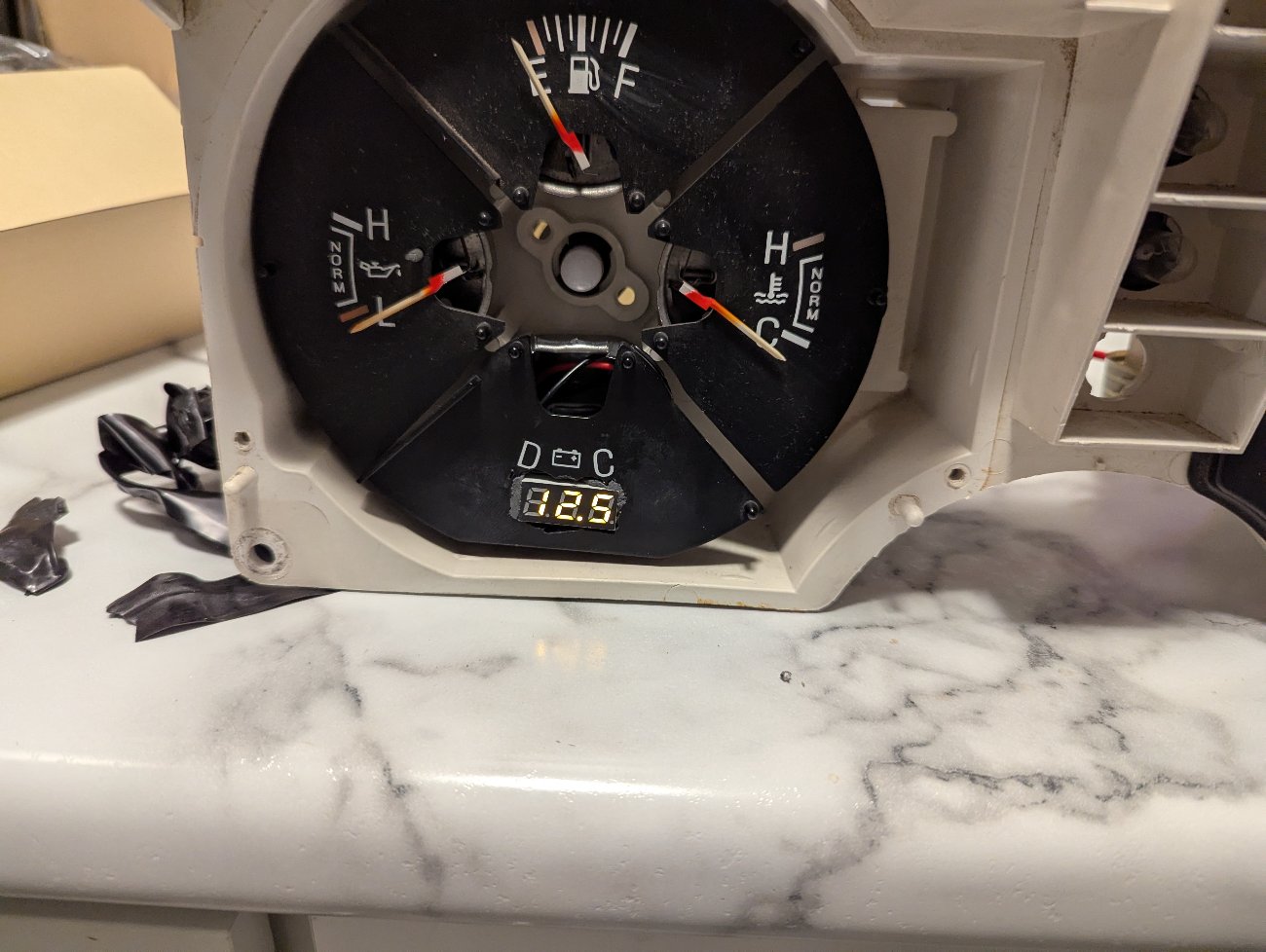

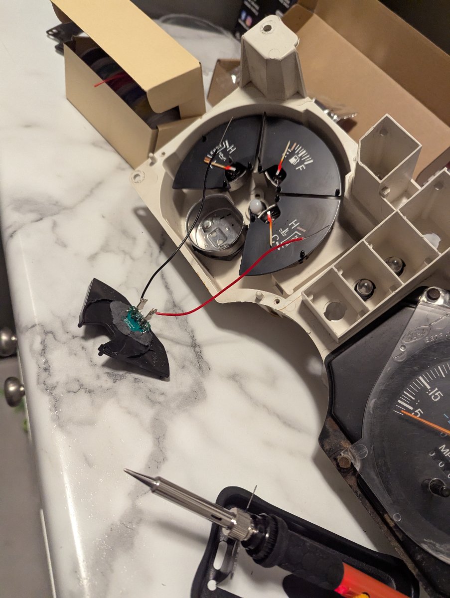

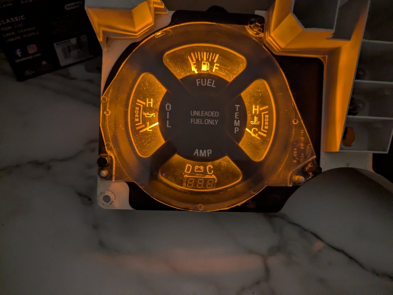

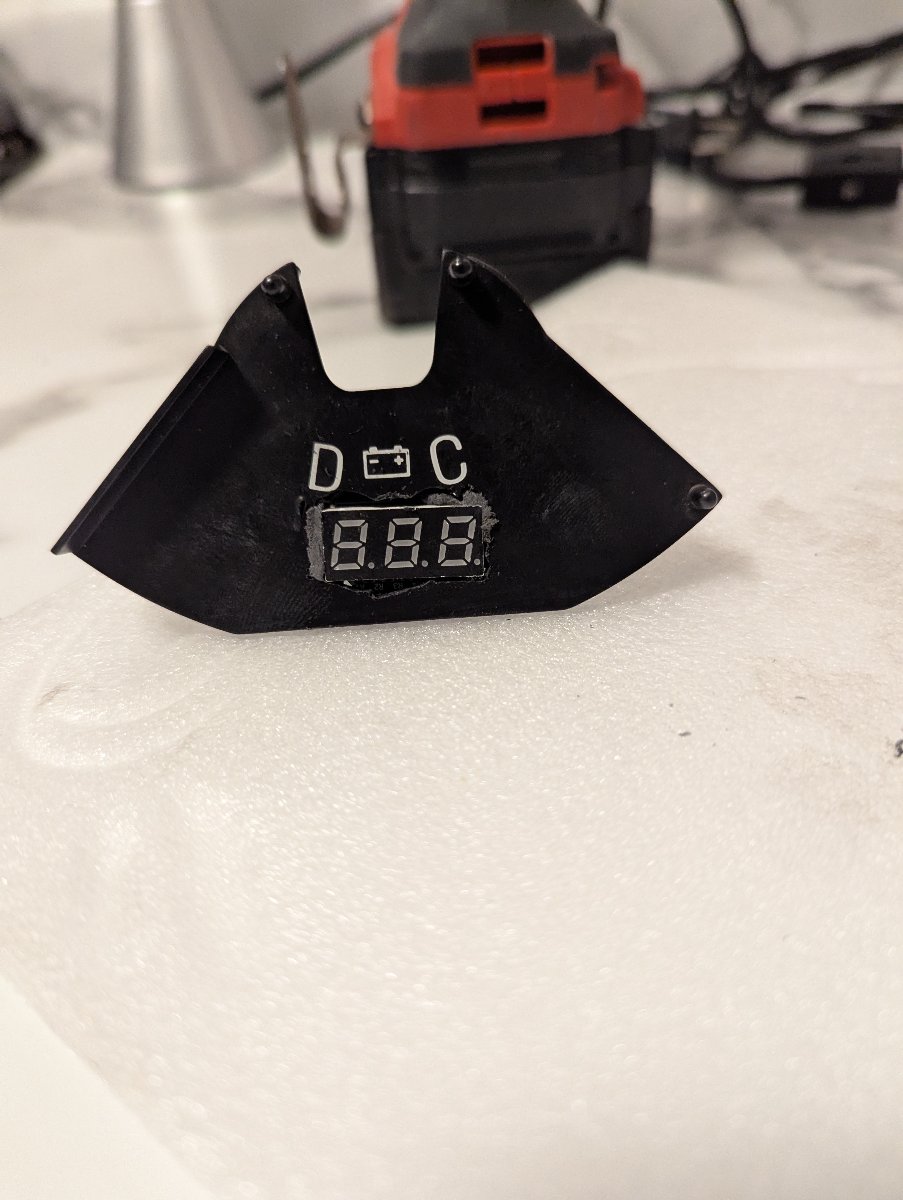

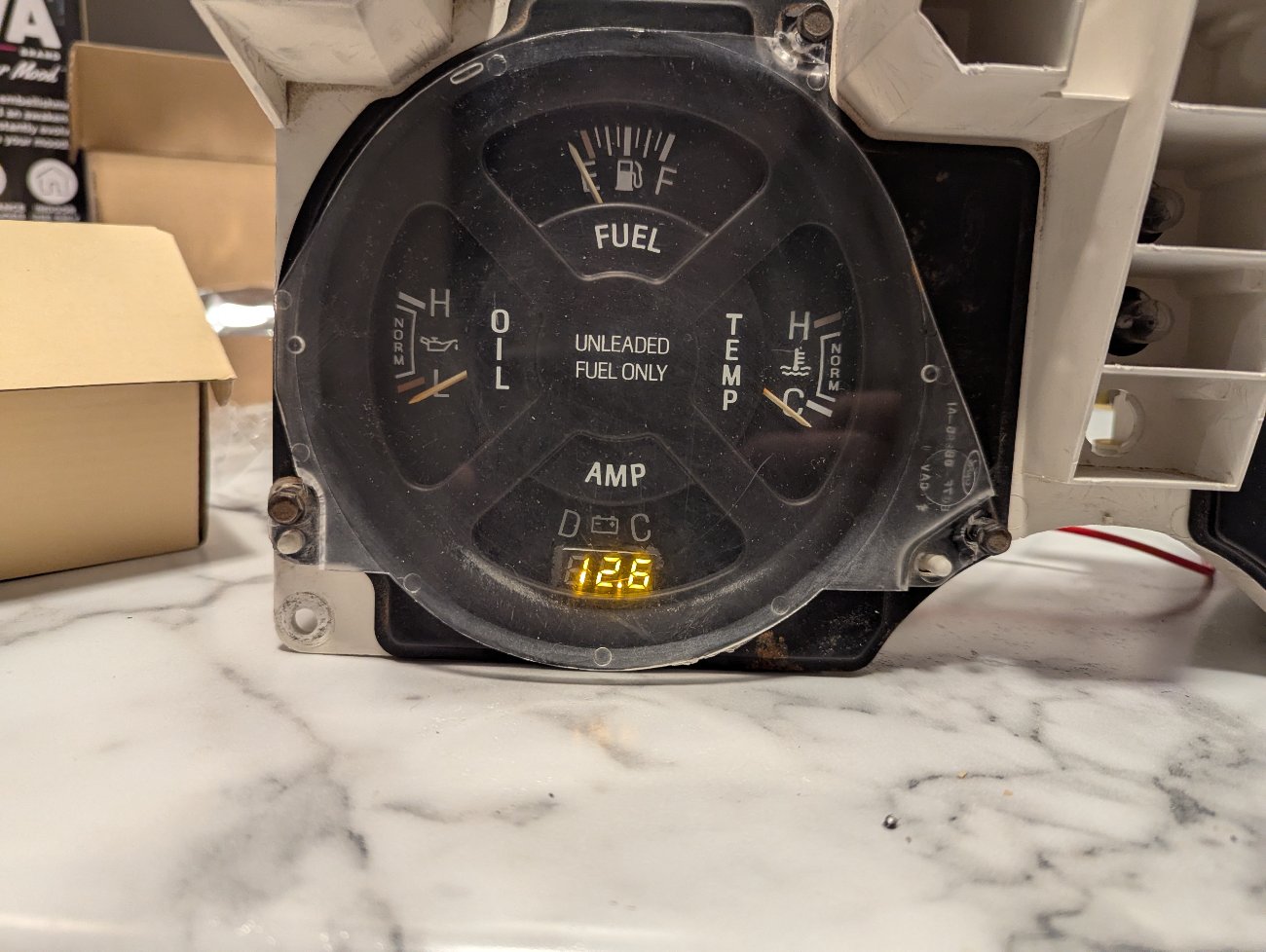

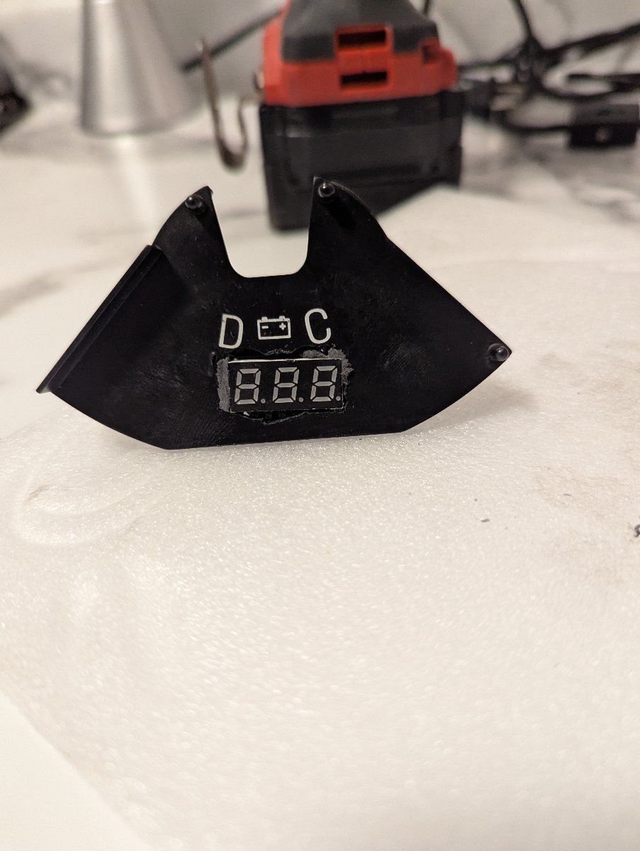

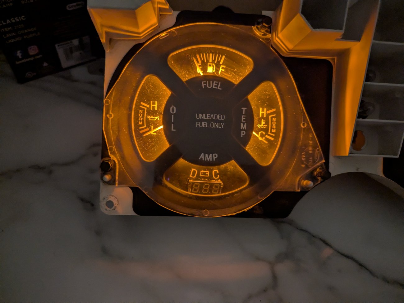

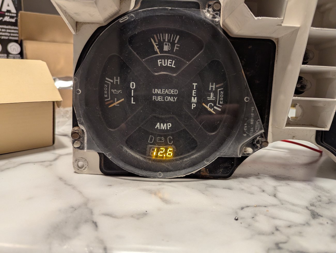

That's why I destroyed my ammeter gauge and soldered in a volt meter into it. All in all very easy, I just have to remember to ground the yellow/light green at the voltage regulator. Why they don't make a drop in kit, I'll never know, but boy this would be easy to manufacture.

I'm curious now, what exactly was the issue? Not trying to question your resolve, I'm only willing to hear what happened knowing it's a possibility I may have to do something about it to someday.
Problem: ammeter never worked
Plan: replace it with a voltmeter
Solution: voltmeter in place

Much like everybody who does anything, I'm unable to get back to my bronco ii and finish up the voltmeter at this time. It is in place and connected to the cluster but I haven't been able to verify that the voltmeter works. I mean all in all it was fairly easy, I think 86-88 has a warning light that is wired similarly to the ammeter.
