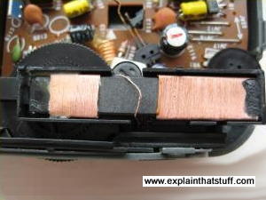

OK..... just a question here. I've always understood that the AM antenna is internal, and the FM antenna is external. Have I had this misunderstanding for YEARS?
for your pocket radios,alarm radios and boom-boxes and what not then yea, they have an antenae like this
but the one in your ride gets its input from the FM antenae also. dont believe me, go unplug your antenae from ur radio and see if AM works :)
