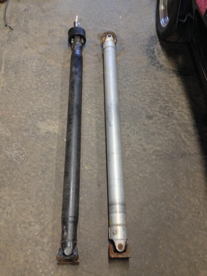

Last weekend I scored an aluminum driveshaft off a 1991 Ranger with a long bed. The good news is it looks to be a drop in replacement for the steel unit in my 1995 long bed.
The bad news is that being a JY unit, it does have some dents from the forklift. There's about 3-5 of them, all shallow gradual (no creases) dents less than 1/8" deep.
Can this be resolved by taking it to a driveshaft shop and getting it rebalanced? (it needs new U-joints anyway, the stock ones are half frozen and fresh grease didn't help)? Or did I blow $25 of a hunk of scrap aluminum?

I have pics which I'll upload later.
Pictures:
Closeup of damage:
Side view of deepest dent:
Wide and shallow...

I have to agree with adsm, anything beyond the tiniest dent and it's scrap. Even if you could rebalance it, dents can severely weaken the shaft (creates points where it could twist & collapse under torque). Those dents look pretty major to me.

I'd be OK with using it as a spare but dented driveshafts are like playing with fire, there is every possibility that it'll twist in half under load at some point and hit all kinds of stuff under the truck.
I have broken enough of my own and seen many others get twisted off. It's amazing how even tiny looking dings can cause catastrophic failure.

Yes, there is a reason driveshafts are perfectly round. The dents do make an area that is weaker and will initiate a point of failure at a lower load. That driveshaft is scrap unless you use it at somewhere less than 50% of its designed load rating. Just know that even light loads at high rpm can fail it.
Junk it is then. I'll exchange it under warranty at PAP this weekend.
