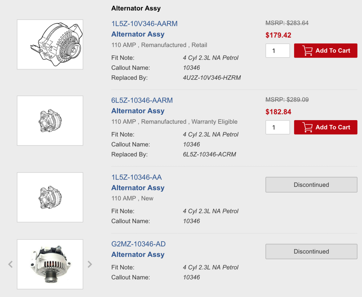

As for the alternator I got, I had to get one "for" a Mazda B2300. The reason I did this is because all the searches I did for 2007 Ranger came up with an alternator that did not have the same frame / shape. I recently discovered some rebuilt Densos that have the same frame only after REALLY digging. The plug, pulley and fit are all the same.
The top alternator is what was coming up in most cased. I have the second one, but the only one I could find new was for a 05-09 Mazda B2300. Was hoping new would be better and it was OEM but after reading everyone's frustration online, IDK how to get good parts anymore.
