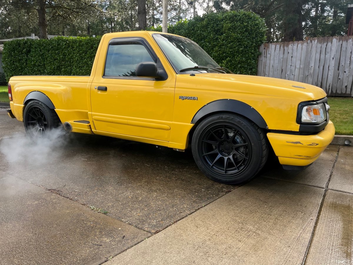

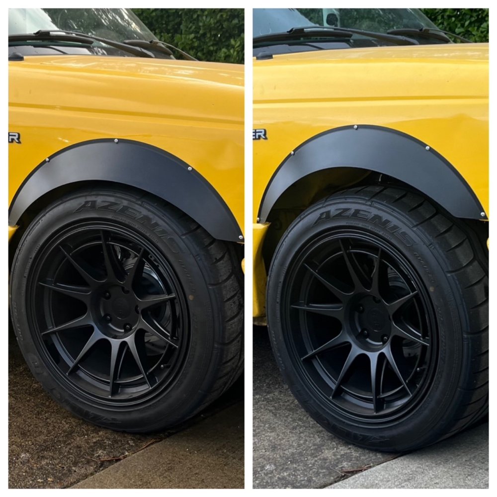

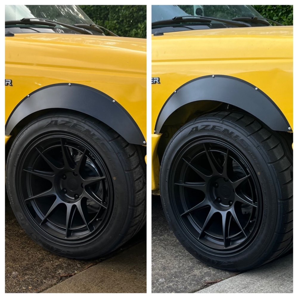

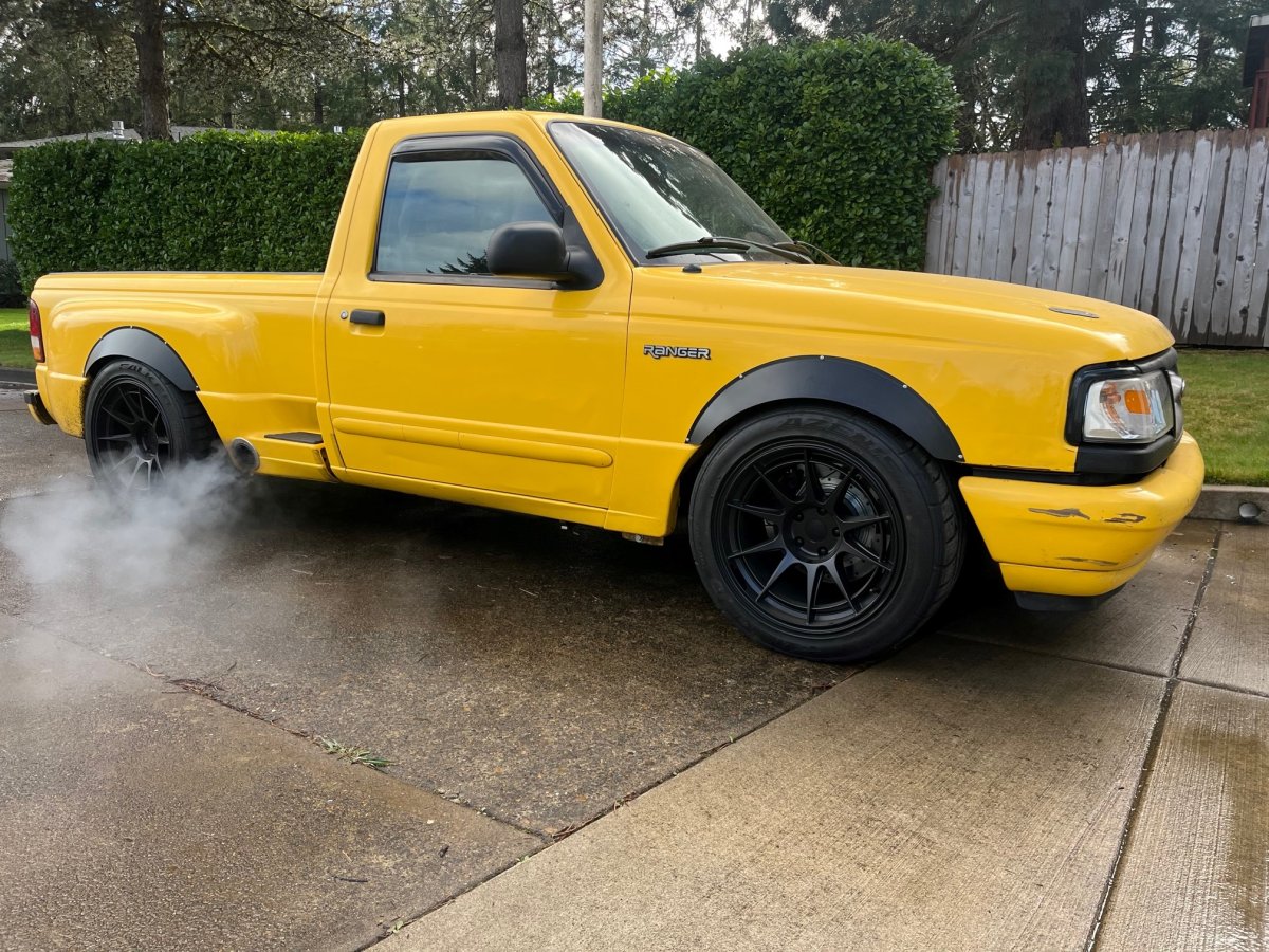

Finally purchased and installed some Racecraft drop spindles. So expensive but also damn nice quality. I'm still surprised how low this AJE kit doesn't go. Front end is as low as it can go unless it's just for show. And these are beefy tires plus my flares are lower than the stock fender wells. But overall the height is perfect where it landed.
I still have various things to do. Like bigger front sway bar, a rear sway bar, remove seat tracks to get seats lower, dyno tune, modify and paint front bumper/front end, tint windows, buy/install roll pan, redo steering column setup, and buy a new power steering rack. Its just money though right? o_O

Appreciate. For the most part I did spend the money first time around, but there's still some things I wish I did differently. Things like the side exit exhaust are cool but ultimately a pain the ass. I think I finally have it dialed to where once warm its perfect and wont move too much. I also spent a lot of time on the fuel cell location, which now I wish I would have just tossed a cell in the bed and been done with it. Wouldn't mind redoing that but I probably wont. Get your truck running! That'll light a fire under your ass for sure. My steering setup really needs changed. I cant drive the truck hard through the twisties yet. Big fast turn no problem though. I cant wait to get my sway bar situation done too.
People seem to like the truck. Hope to get it to some bigger shows/meets this year. Get plenty of attention at local events. It's funny though when I pull up to meets people usually kinda smirk at it. But once they investigate their attitude changes. Its fun. Also hoping to get kicked out of the track this :p. Be awesome to build a cage and get a little more serious about the 1/4 mile but its a lot of work for something I maybe do four times a year.

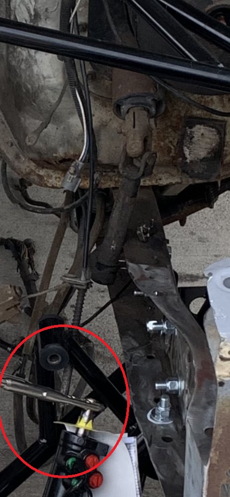

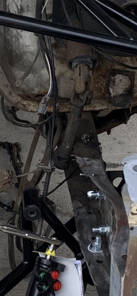

Need help guys. Gonna try and move the ranger into the garage this weekend buuutt I don’t have a complete steering shaft. What did you guys do for yours or what do you think would work temporarily? It’s still the stock 90 ranger shaft out of the firewall and a sn95 rack and pinion on the other end. Worst case I’ll rent a dolly but it’s only like 200 yards up my driveway to the garage 😂

Need help guys. Gonna try and move the ranger into the garage this weekend buuutt I don’t have a complete steering shaft. What did you guys do for yours or what do you think would work temporarily? It’s still the stock 90 ranger shaft out of the firewall and a sn95 rack and pinion on the other end. Worst case I’ll rent a dolly but it’s only like 200 yards up my driveway to the garage 😂View attachment 90662
If I understand this question correctly, I would turn the truck around on a trailer or dollies so that the read end faces toward the garage, then winch it most of the way in.
Id think you could make a temporary shaft pretty easy. But until you get the manifolds on I wouldnt make the final product. I took my column all apart essentially shortening it so much it doesnt come out of the firewall. I'm really tempted now to buy the race column off ebay that bolts up.
Just push the tire in the direction you want it to steer. Sometimes an old rim and tire and use a bar thru the holes to force it.

After the drop spindle install there was tons of rubbing. Could barely move it around the driveway. I probably had to raise the front end an inch, plus do some trimming. Even at that height I will rub on the inner wheel well if driving hard. Pretty sure I need to cut most of it out. So ill say it again and again, this kit really doesn't allow you to get really low. Or maybe it would be different if I was running skinnier tires up front I dunno.
Still need to source a sway bar from a explorer. Should help with rubbing. Also need a rear sway bar.
