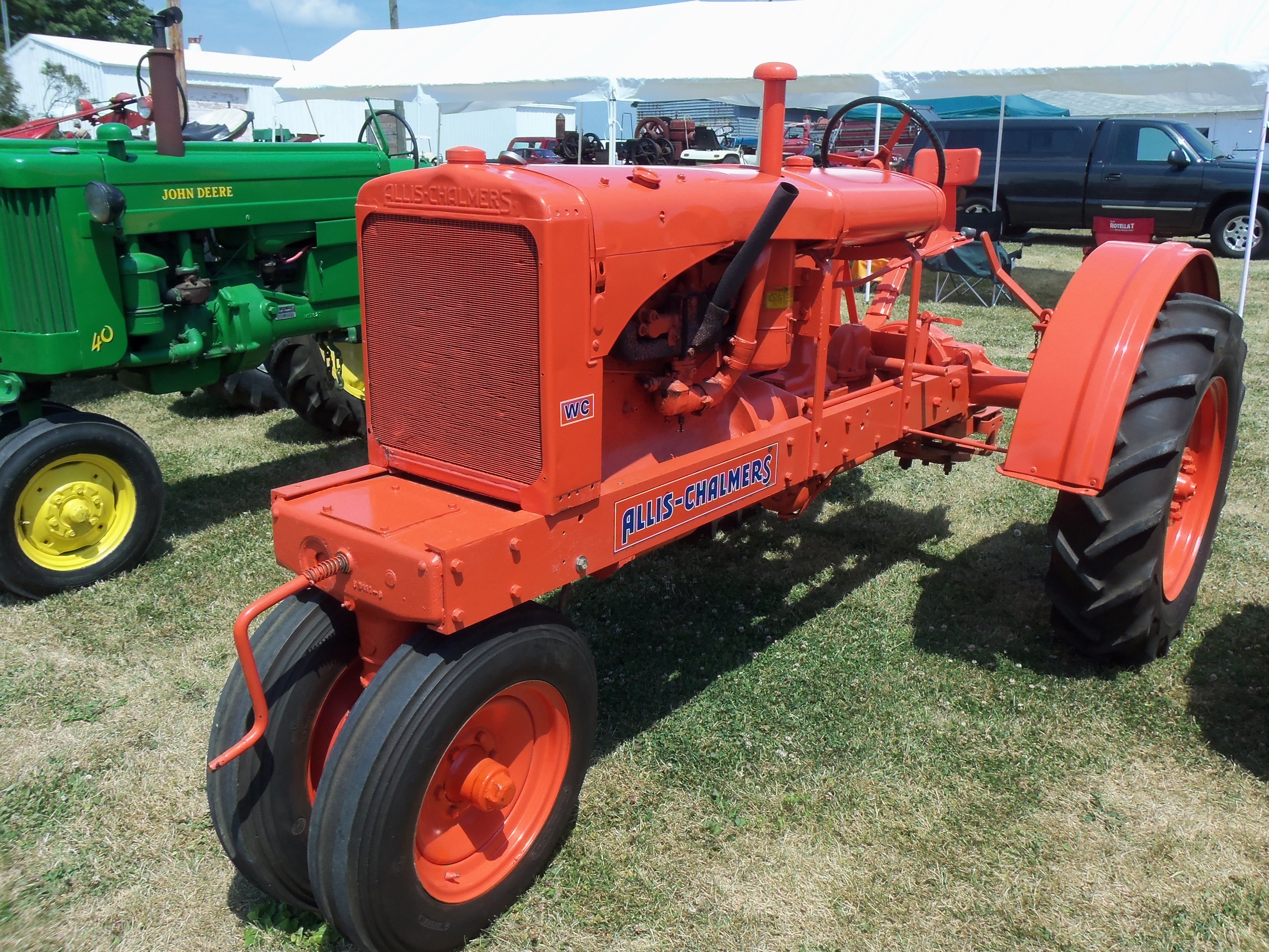

Old farm tractors basically ran open manifolds until people started giving a crap about not going deaf by age 12.
The only tractor I have really heard of having noted valve burning problems was the dual exhaust Oliver 70
BUT with all the sideskins on them they were noted to like to overheat too...
