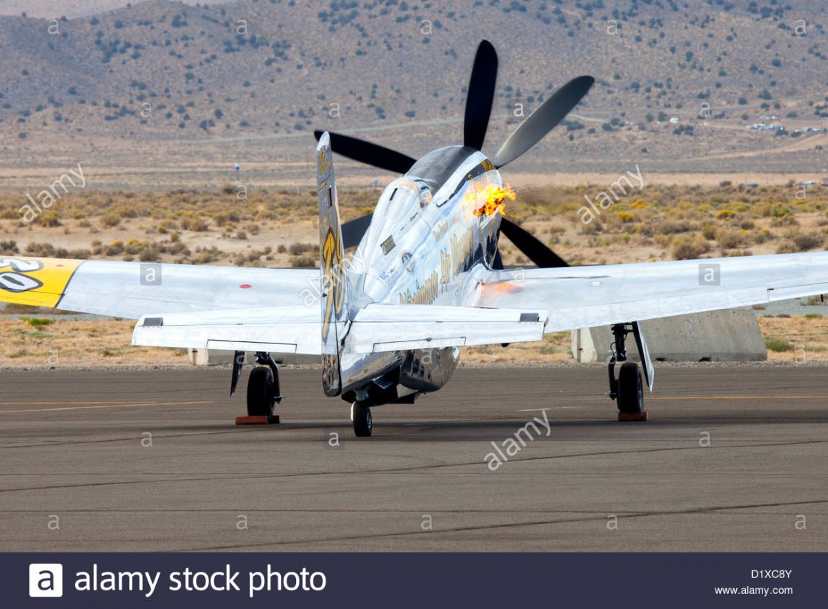

So the next question is how short can I go?
I have a love for the P51D mustang and want to stick with a theme on the Model A.
65638
I had an idea for zoomie style headers that curved back up to exit the side panels but it may be a fools errand with fitment even with a 32 grill which would make my hood wider.
Well on cars you can have people walking by when engine is running and exhaust temp coming out of a short pipe will be 700-800deg at idle, over 1,000deg under load
So that's a concern
Up facing exhaust is a concern for rain/water unless kept inside all the time or you put plugs in pipes when its not being used
You could certainly make pipes that "look like" P51 exhaust but use them for intake air or just show
No no..... this certain vehicle is suppose to be a flame throwing monster....
It wouldn't be a hotrod if it wasn't "hot" then it would be just a rod.... and that sounds lame.... lol
If you wanna stick with the theme then the car needs a Merlin V12 there's no other way around it...
Sounds good
So you are not doing just to burn the paint off peoples cars in a parking lot :)
