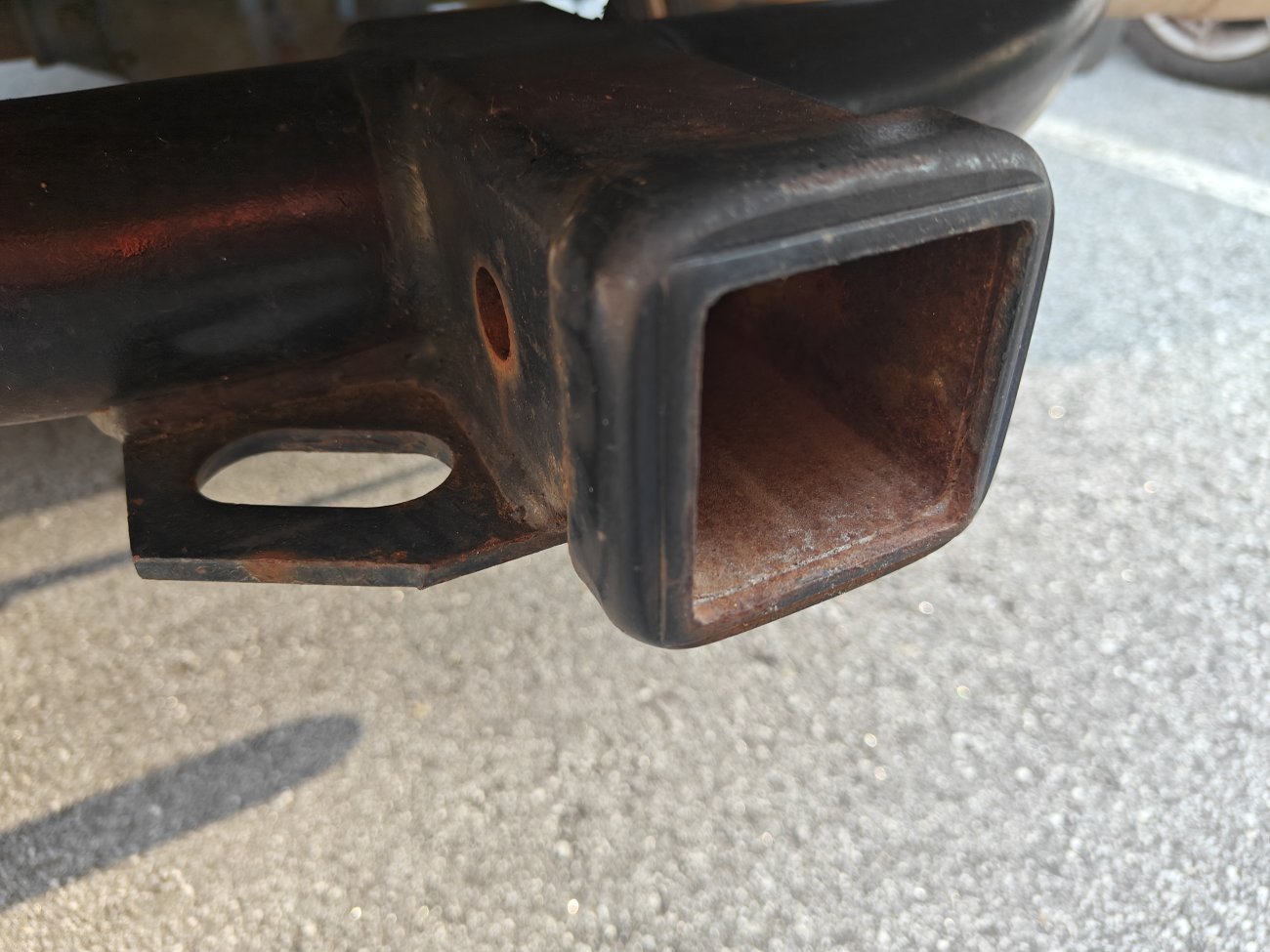

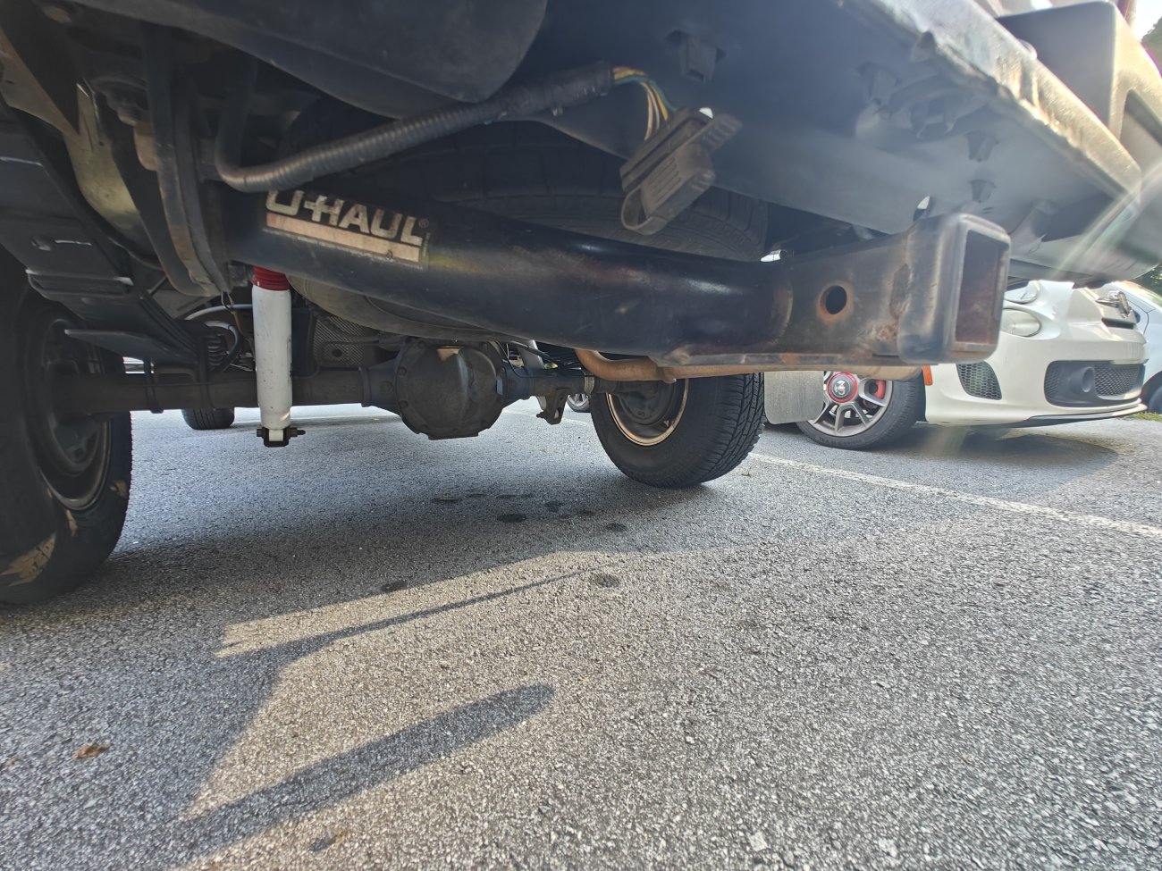

Told you I had a hitch. Anyway, I thought I might try to remove the rust and use something a little bit more durable to coat the receiver. I thought about powdercoat, but I've heard that it can chalk and flake off. I thought about bedliner, but my concern there is how thick the coating is and whether that renders the ball mount unusable. Then there's the old school, 🦆 it and RustOleum the thing after a coat of rust converter, then just hit it again if the rust comes back.
I'm overthinking it, but have you met me? 🤪
I would go with Rick's method of using the brush on rustoleum possibly thinned some so you can get in the nooks and crannies and just spot treat later... I need to stock up on some different color options, spray paint is just so short term and unreliable as I'm finding out...
Keep it minimal in the socket, well check a hitch insert in there first to make sure it isn't tight to start with... they're not all the same and some are super tight to start with...
Thanks! I didn't consider that the receiver might be a tight fit. I haven't come across one personally where that was an issue. I'll stick my ball mount in there and see what the fit looks like.

Personally, I would not coat the male and female sliding parts or ball with anything. It's just going to rub off in use. Rustoleum is plenty good enough for me for the rest of it.

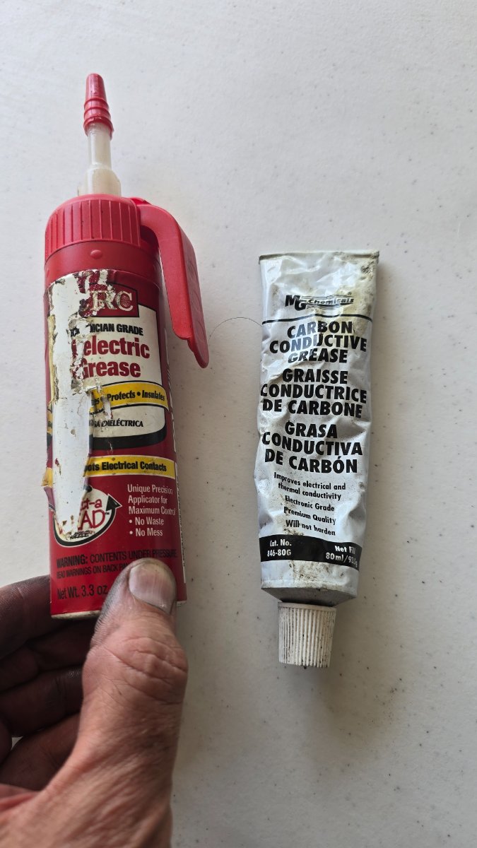

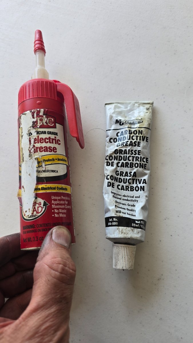

Dielectric grease is an insulator. You could use cobductive grease. But, I must say that stuff gets all over you like anti-seize.
The reason dielectric grease is used so popularly with electrical connectors is to lubricate the seals and keep water out. Since it is non-conductuve, it won't short across contacts or to ground if you get sloppy with it. But should not purposefully put it on the actual contacts.
dielectric on the left / conductive on the right
