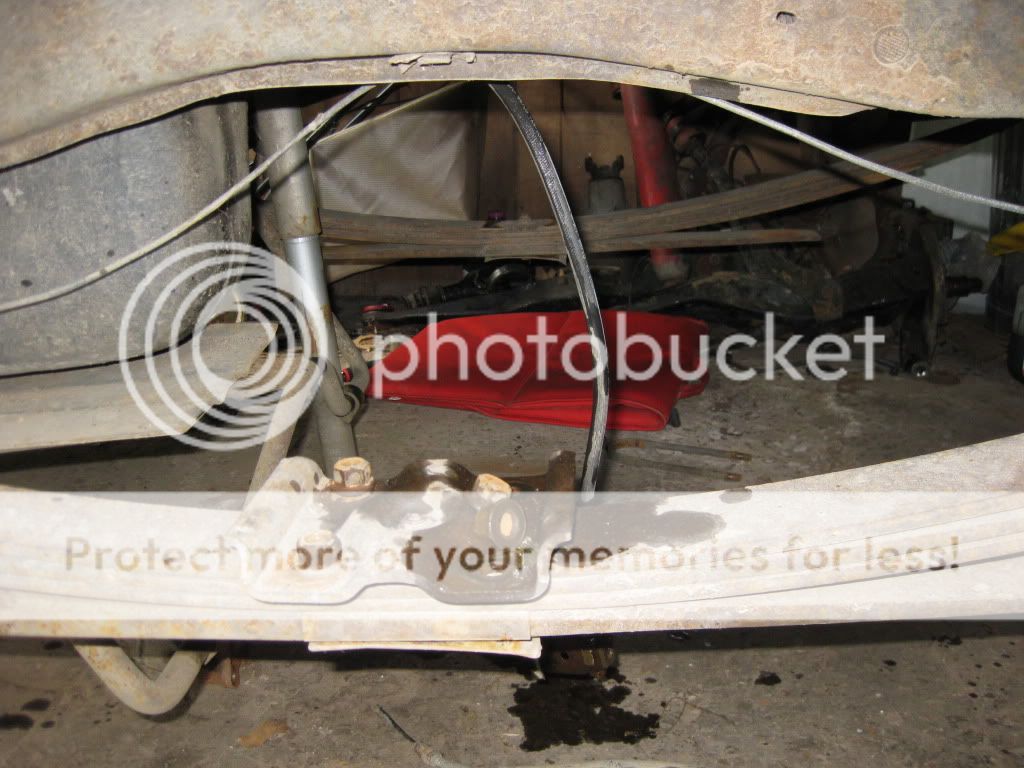

Oops, rear axle fell out:
adsm08's Ranger build up
I guess that's what happens when you spend your morning removing everything that holds it to the truck. :icon_rofl::icon_rofl:
Here is the new axle almost ready to go in. I have to ream out the holes on the spring perches because they aren't big enough, and I don't have my helper to help get the new axle off the stands and onto the dolly.
Also, gravity did the majority of the work of placing the 7.5 axle on the dolly. I'm not quite sure how I am going to put the 8.8 up in.

do you have a floor jack? every rear axle I have ever put into place by my self was done with a floor jack under the pumpkin...just lift that fawker up there. simple.
Well I didn't put the truck on stands with the Force.
My problem isn't getting it in the truck so much as off it's current stands. It is heavy and my back is not as strong as it should be. The springs are actually low enough to the floor that I could probably just use the U-bolts to draw it up to the truck, but my biggest obstacle to continuing today is the holes for the dowel on the lift block. The holes are too small and I don't have a drill bit that big. I also don't have the money to go get one until tomorrow when my pay check clears. I spent all my money from the scrap yard on fluid and new parking brake shoes.
