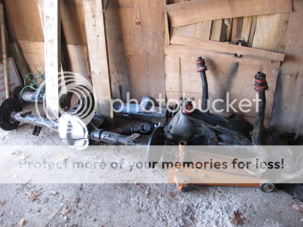

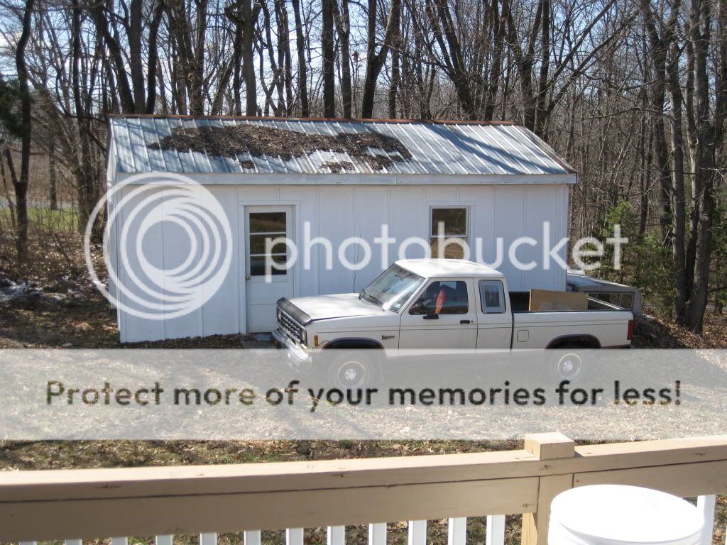

Got the scrap heap out of the garage. Poor little S-10, looks like she is about to bust a spring with all the scrap iron I have in the bed. I think the back of the truck has dropped at least 3 inches.
Then I moved my axles
adsm08's Ranger build up
and Kip's (newer) truck out of the way,
so now I have this:
Room to do a heart transplant. BTW, does ANYBODY want my old trans or transfer case. The trans needs a bearing and seal kit. The t-case is PERFECT, come take them away. Both are manual.

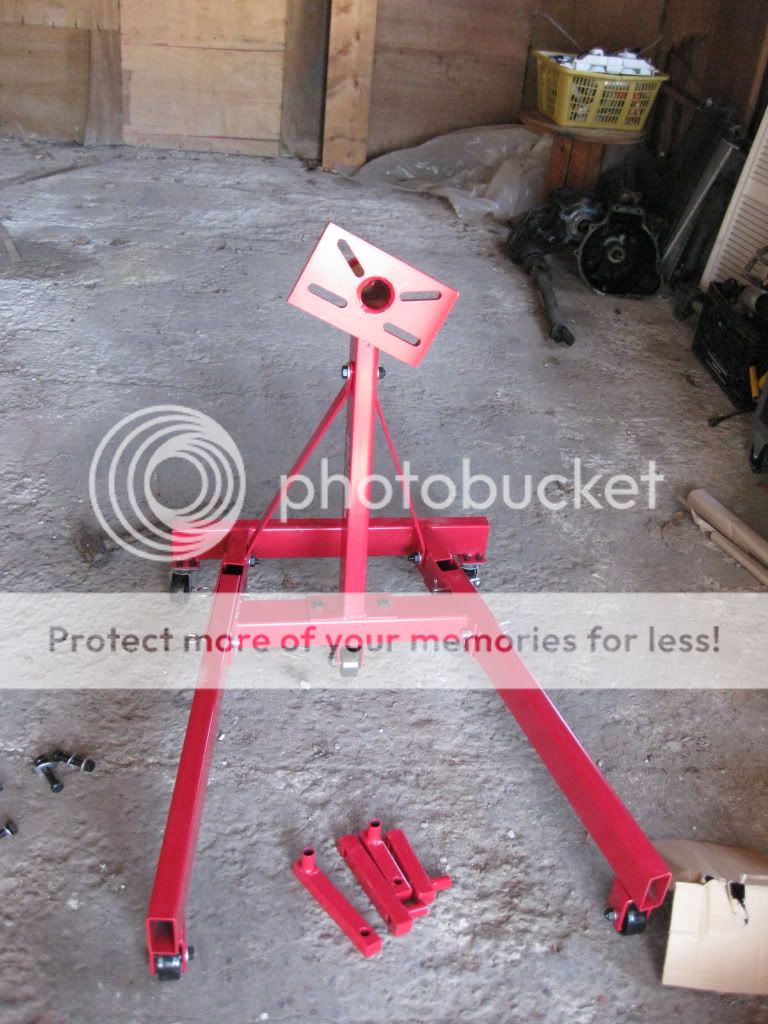

Then I set to work on putting together my new toy...
What could it be? I already have a tool box. I already have a cherry picker.
Anyone guess what it is yet?
Still can't guess?
If you haven't figured it out yet, you may need a new hobby.

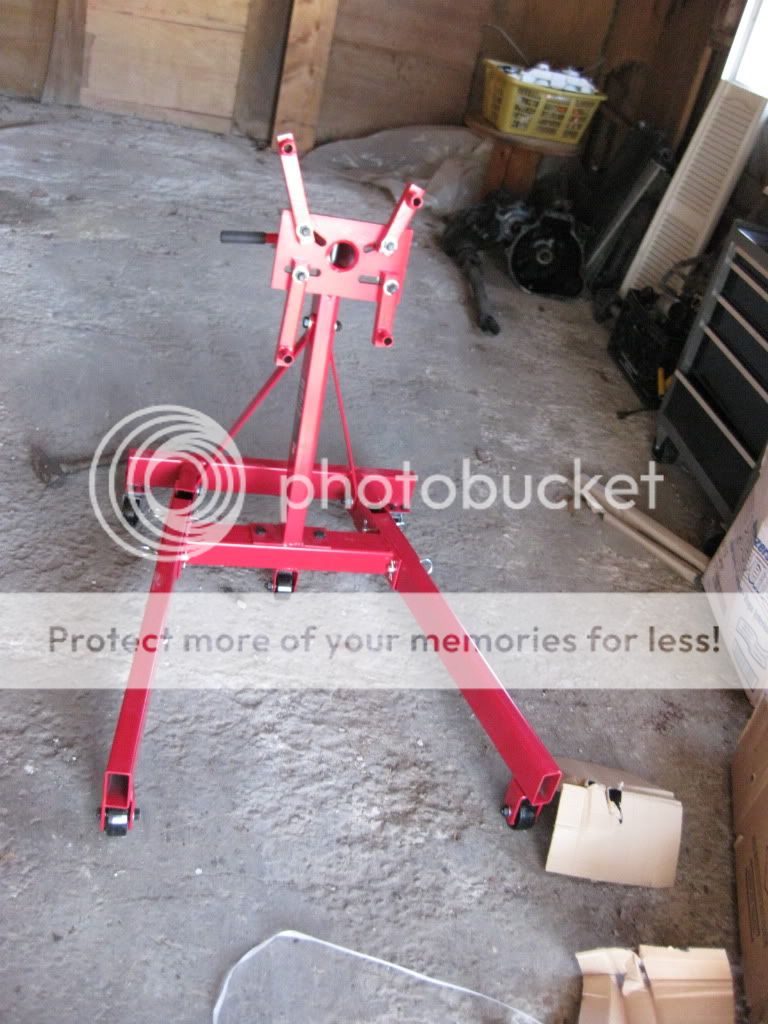

Here it is complete.
If you haven't figured it by now, you won't.
Gots me an engine stand.
And now I have a garage to work it. It's just about perfectly Ranger sized. Now to build a bigger one with a lift or two.

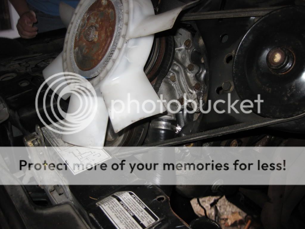

Brought the engine home today. Little annoyed with myself though. Didn't strap is down tight enough and it tipped when I went over the bump from the lot to the road, engine tipped over just a bit, but it split the seam on an almost brand new fan.
It will be ok for a while, heck my current one has looked like it's about to fly apart for years, but I will need to do something with it. Preferably sooner rather than later.

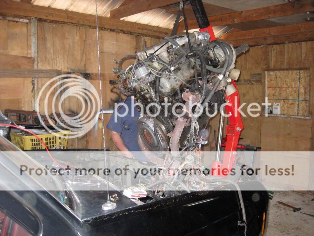

Old engine hanging over the truck, about to come out:
Me in the engine bay. Decided it wasn't worth the risk of re-using the slave:
New engine going in:
My wife and Kip trying to figure out the angle of the dangle:
We had some clearance issues. The truck this came out of has the front end off forward of the fire wall and it's old TFI still got hit and broken. I finally had to break down and remove the dizzy cap, the upper intake, and the headers to get it to go in.
