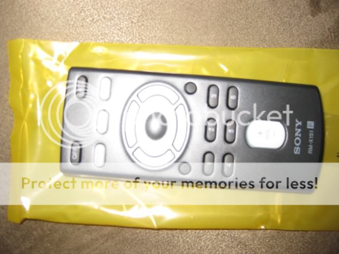

The remote:

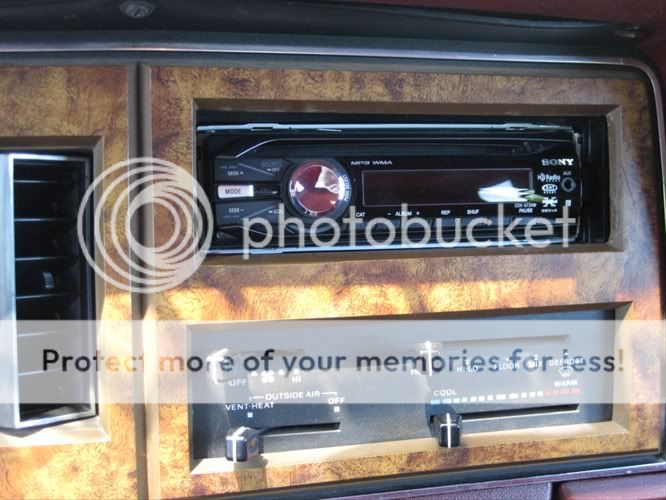

And installed:
adsm08's Ranger build up
It sits back in the dash kind of far, but the sound quality is great, and the CD player works. I haven't played with the HD (not many HD stations around here) or the MP3 player control, but I'm happy with it so far (hasn't even been in for an hour and I only have a 1/4 mile on the truck since then though).
I love you Grandma and Grandpa :D:
EDIT: Looks like I need a separate HD tuner for the HD function to work. I guess that will just have to come later, like I said, not many HD stations around here.

You shouldnt need an HD tuner if its HD ready, bt you do need an HD antenna due to digital signal as opposed to analog, same as the tv.s The newer tvs have digital tuners built in, but need a digital antenna. Sony makes the best head units in my book.
See that's what I thought too, but then I was flipping through my input options and HD wasn't in there. So I went back and read the manual and it said that I need a separate tuner plugged into the RCA jacks in the rear for the HD to work. I think it's just a ploy to sell more stuff. Not too worried about it since there are about 3 HD stations close to me and I prolly wouldn't listen to any of them.
You wont have an HD input neccesarily unless your gonna listen to an external HD source such as sat radio. The HD antenna will use the same plug as your analog so no probs there, If it says HD ready on the front of the radio then It will pick up with an HD antenna. Now if someone told you it was HD then its bullshyt.
