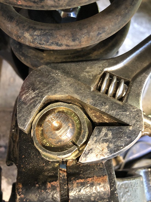

Axle is out of a '95 Ranger, I can't turn one bushing without the other turning?
Like an idiot I just stuck them in like they are without "zeroing" them.
Is there some kind of a trick to it? Are they in a bind because I didn't zero them?
You need to hold the lower part of the bushing while you turn the upper part (use an extra-thin wrench or pliers or something).
Lacking that, it's probably easiest to just pull the bushing out and readjust it with it out of the axle.

I did get the PS back out, and hit it with penetrating oil last night, it is can be adjusted with two wrenches now. Like before I installed them the two parts won't come apart for anti seize.

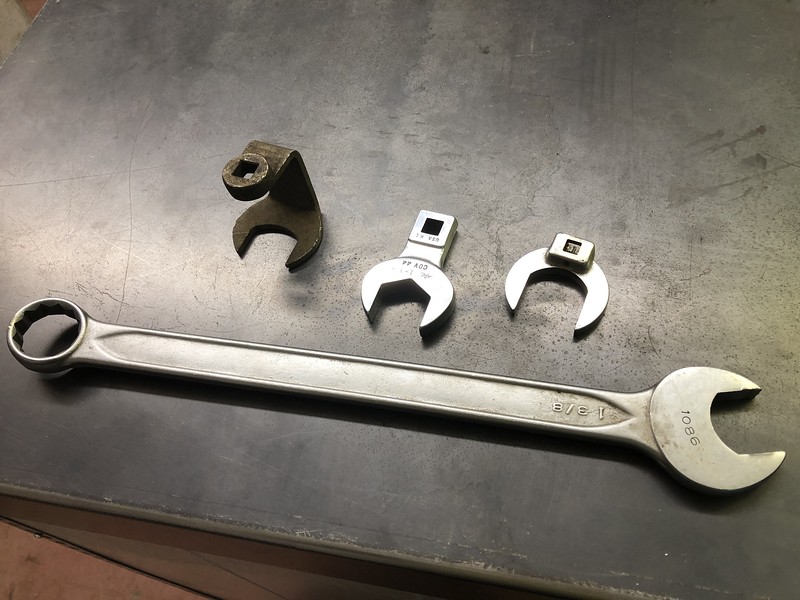

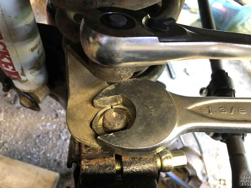

I was talking to dad about my problem, he asked what size I needed... and came up with this:
Very cool crows foot wrench ends.. I know the bushings won't come apart, that's why I worked the anti-seize between them using a moly-spray to thin it. Worked well.
Not sure what the "correct" tools are but this setup works perfectly.
1-3/8" weird crows foot and 1-1/2" wrench.
