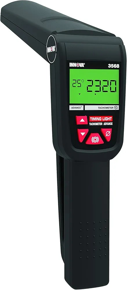

My timing light has a digital tach... simple.
I think I own a timing (don't ask me where it is... and it isn't digital) light but the only vehicle that I have that needs one is my boat...
But yeah, at work we have those and that is a definite reasonable option, would be a good way to set the base idle screw...
