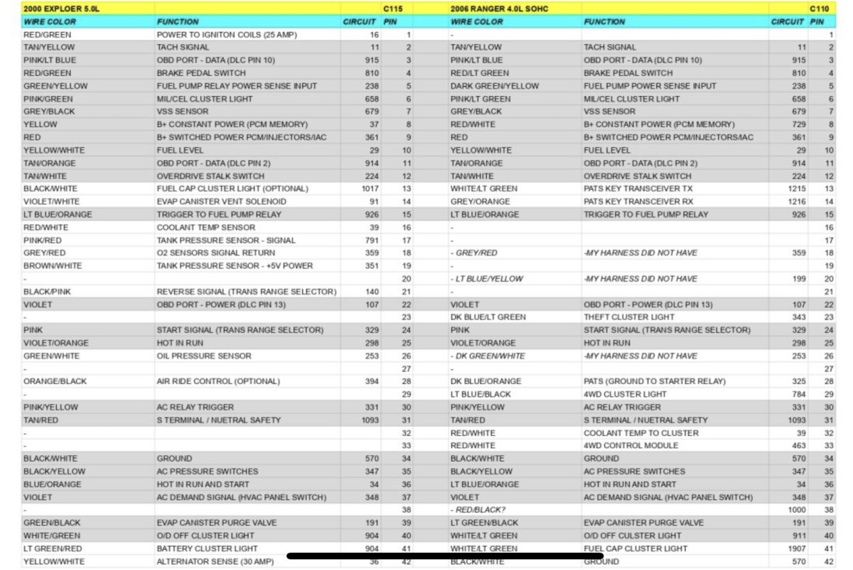

Does anyone know how to add a PATS module into a 2006 Ford ranger FX4 level ll. The PATS is out of a 99’ v8 Eddie Bauer Explorer. Where do them wires go that are outlined in blue that’s where I am confused, and my pigtail does not have a wire in a number one pin that is pink and orange for the starting/charging system. I think it might have something to do with hooking up to the OBD port under the steering wheel. I just got too find out which wire goes where there are three wires, and I think two of them are color-coded the same as the PATS module.
FYI in case you were wondering the first picture below is the wiring pin location for the 42 pin connector in the engine bay for the ECU wiring harness

I figured it out right after I posted this. It’s really pretty simple because the 2 OBD wires that connect from the truck are the same color as the PATS module. I just spliced them in right behind the OBD plug-in. It’s been working for a while now so I can honestly say it works. Thanks for all the help.
