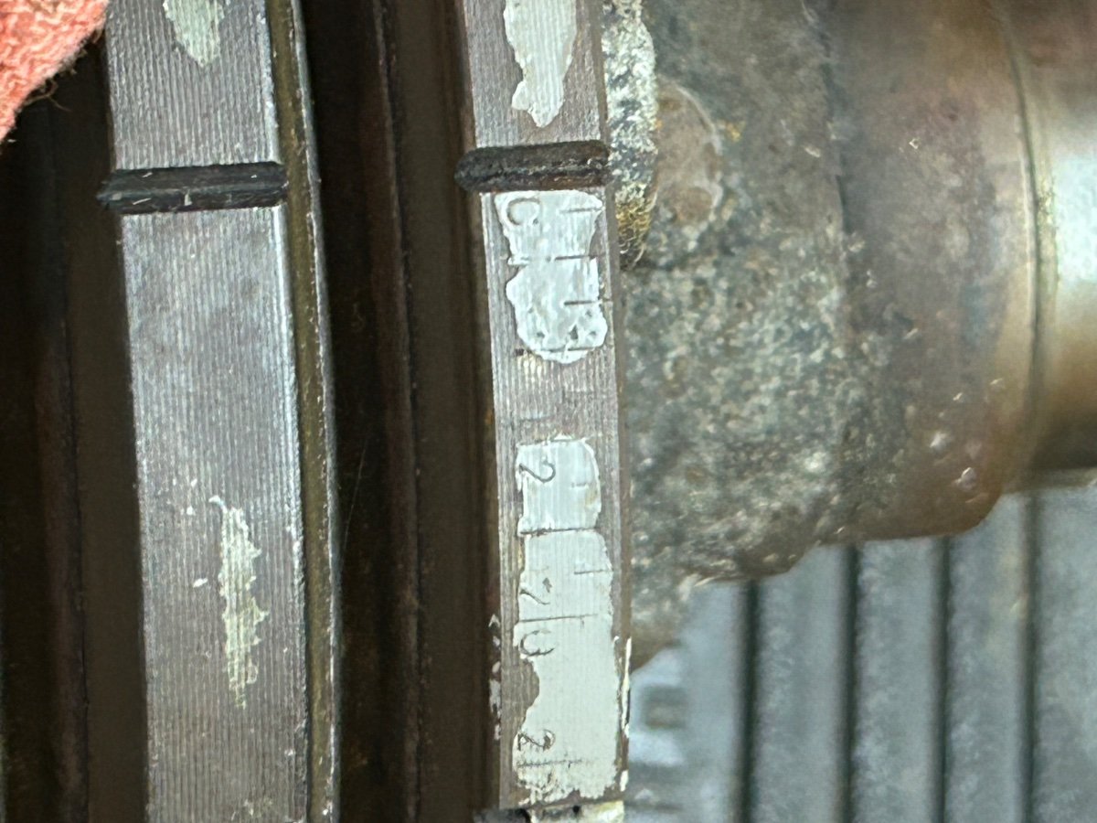

No, I think the simplest way I can explain it is that the timing marks on the crank are way off. The original TDC notch is now in the BTDC range, and true TDC is further down the crank. In other words, the original timing marks are probably no good to me at this point.

I’ve included a picture of my old crank pulley to show the timing marks.
Yes mine looked just like that except for the gray paint.
