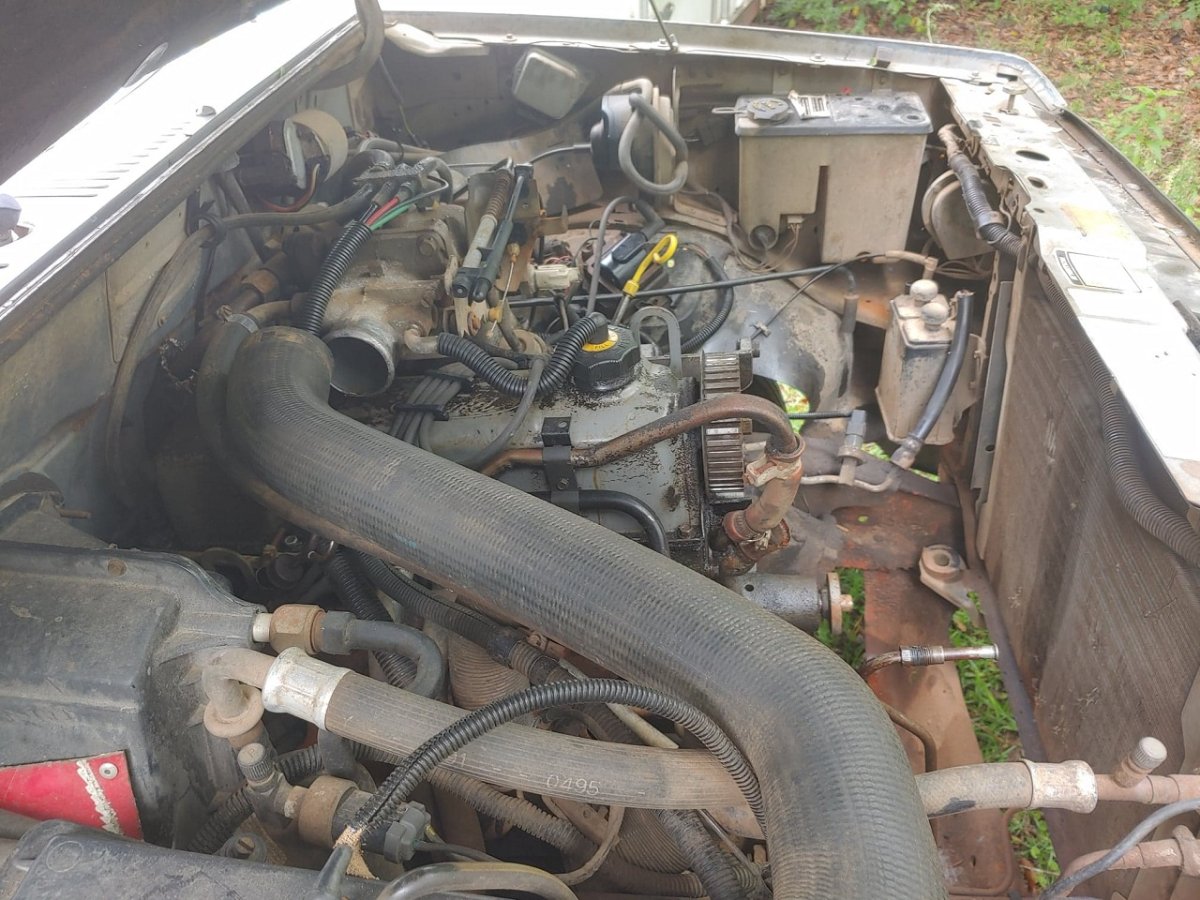

need to clarify, the AC housing caught fire, not the blower motor housing, Is the BM resistor IN the AC housing? APPRECIATE help!
Yes. I don't have a picture that shows the resistor. If you see the red in the bottom corner of this one, that is where the resistor is located. Looks like PO on my truck created a patch out of an old road sign.
OH man, vacuum out, n replace.... CARP lol Thank you! That was what got it!
