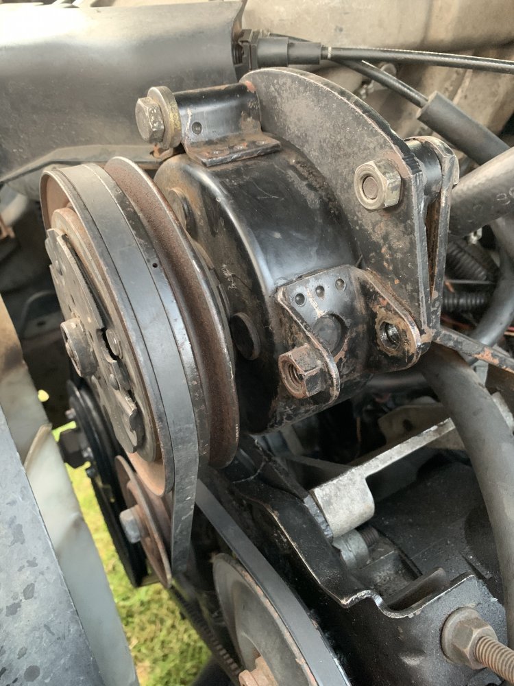

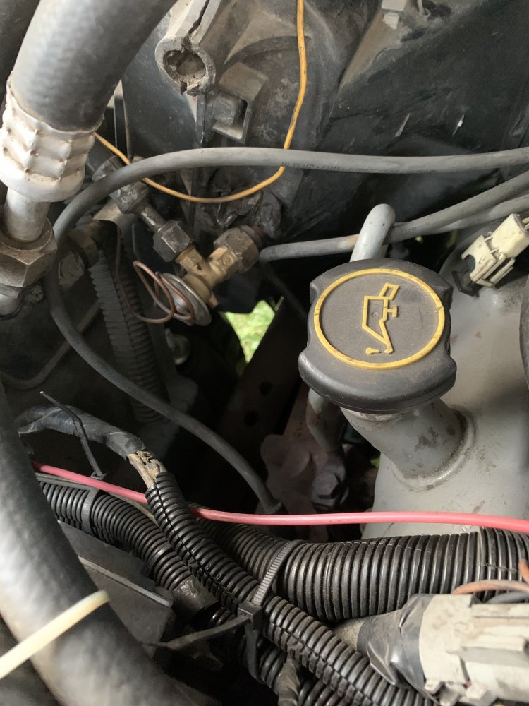

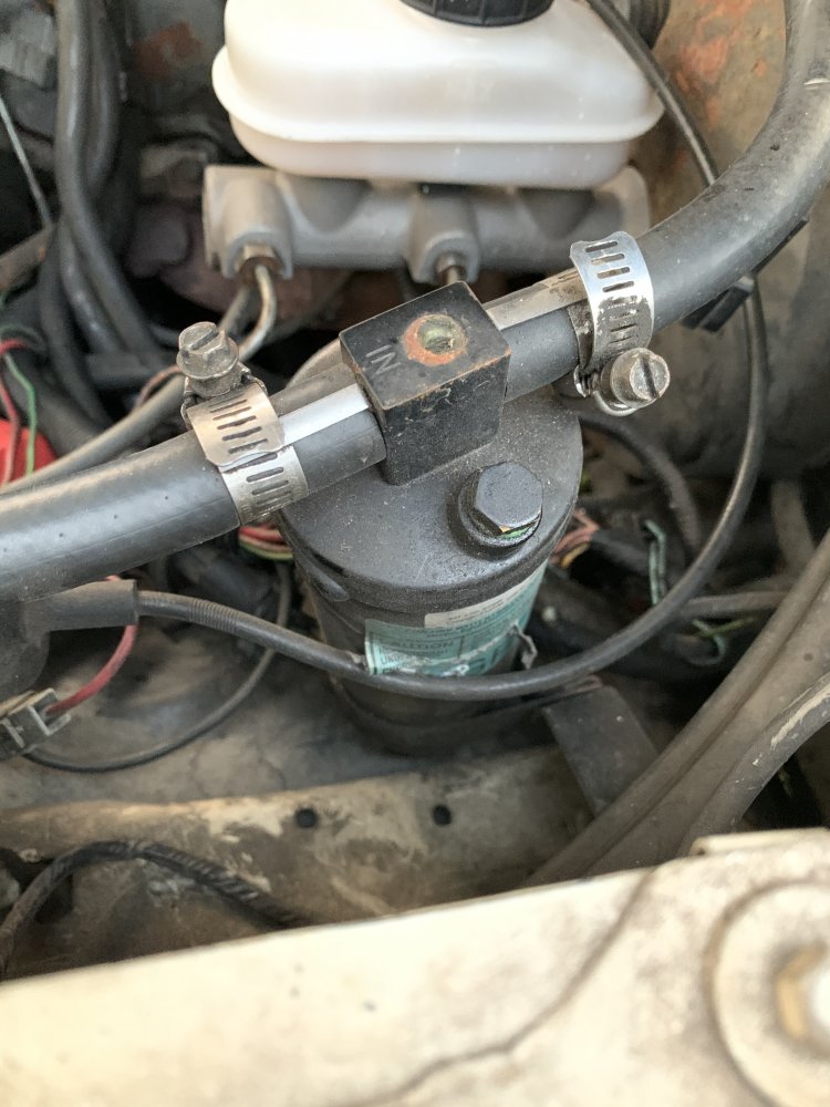

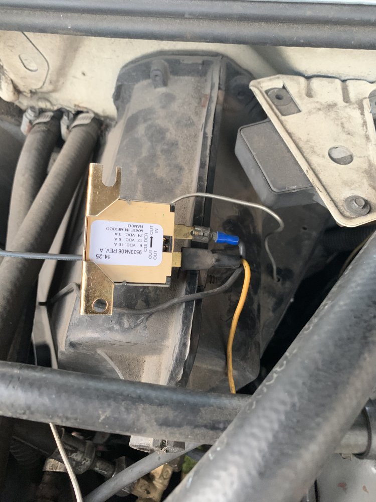

Here is the basic parts to my system. I have a different pump for some reason then you would usually see on most trucks I think. Anyway I am not sure if I am suppose to have a cycling switch on my dryer or not. It didn’t come with a thread part to put one on. It does have a cap you can see on the picture. Am I suppose to take that off and put a switch there. Or does this sustem not have one. Also on the thermo switch. You can see how it is mounted on the picture. Question is where is the long probe thing suppose to go into or wrap around. As you can see it’s shoved into the box. And is this all suppose to be isolated from heat. So am I missing some part or is something in the wrong location. Seems to cool alright. But the compressor clutch never turns off. One last thing. If there is some info on how to adjust the 2 screws on the thermos switch. Thanks. Can’t find anything on this system and not really sure if it is factory.

No, for sure, not factory, anyone's factory, it is pieced together from older AC systems
The thermostat, 9533n406 rev A, is just a generic AC thermostat, I would think that it probe should be on the Evaporator, inside the box, and it would shut off compressor when it was cold enough(35deg) then turn it back on when hot enough(45deg), would need to be touching metal on evaporator
Does either compressor clutch wire match a thermostat wire?
The thermostat is what turns compressor on and off, not a pressure switch(cycling switch) from what I can see
So its either hook directly to clutch or it activates a separate relay, follow the wires
And there should be a switch inside the cab to activate AC to begin with, you didn't mention that
You could certainly burn out the compressor if system ran dry, leaked, with no pressure switch to shut off compressor when level got to low
There may be a pressure switch on the compressor, look at the wire on it

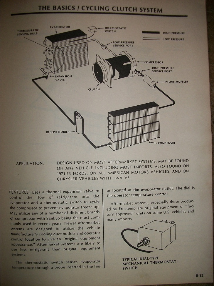

Your AC system isn't factory installed, and I can't tell if it's an aftermarket kit, or a system just cobbled together from aftermarket parts. I "think" what you've got is a cycling clutch system, with an expansion valve and a thermo switch. See the attached diagram; it's from an old tech manual, but a better understanding of the system may hopefully help you out in working on it.
Your third picture, the expansion valve sensing bulb should be attached, with a clip, onto the metal part of the other, larger low pressure line, where it goes into the evaporator housing. Once attached the sensing bulb is usually wrapped with a sticky cork-impregnated tape.
The thermostatic switch, your fourth picture, I don't recall ever seeing that type. In what I used to install, these were usually a dial control and part of the operator's AC controls. As your picture shows, the sensing probe goes through the hole in the evaporator housing, and the end should be inserted into, and touching, the evaporator fins. The thermo switch does look like it might be a newer component, compared to the rest.
Again, I'm not familiar with that style thermo switch, but you could try adjusting it. I'm guessing, but I would think that adjusting the "cut out" should cause the compressor to turn off when the evaporator gets too close to freezing. When the evaporator temperature raises to reach the setting of the "cut in", the compressor is turned back on. Unless you can find instructions for that switch, it'll might take some experimentation to dope out how the setting controls actually work.

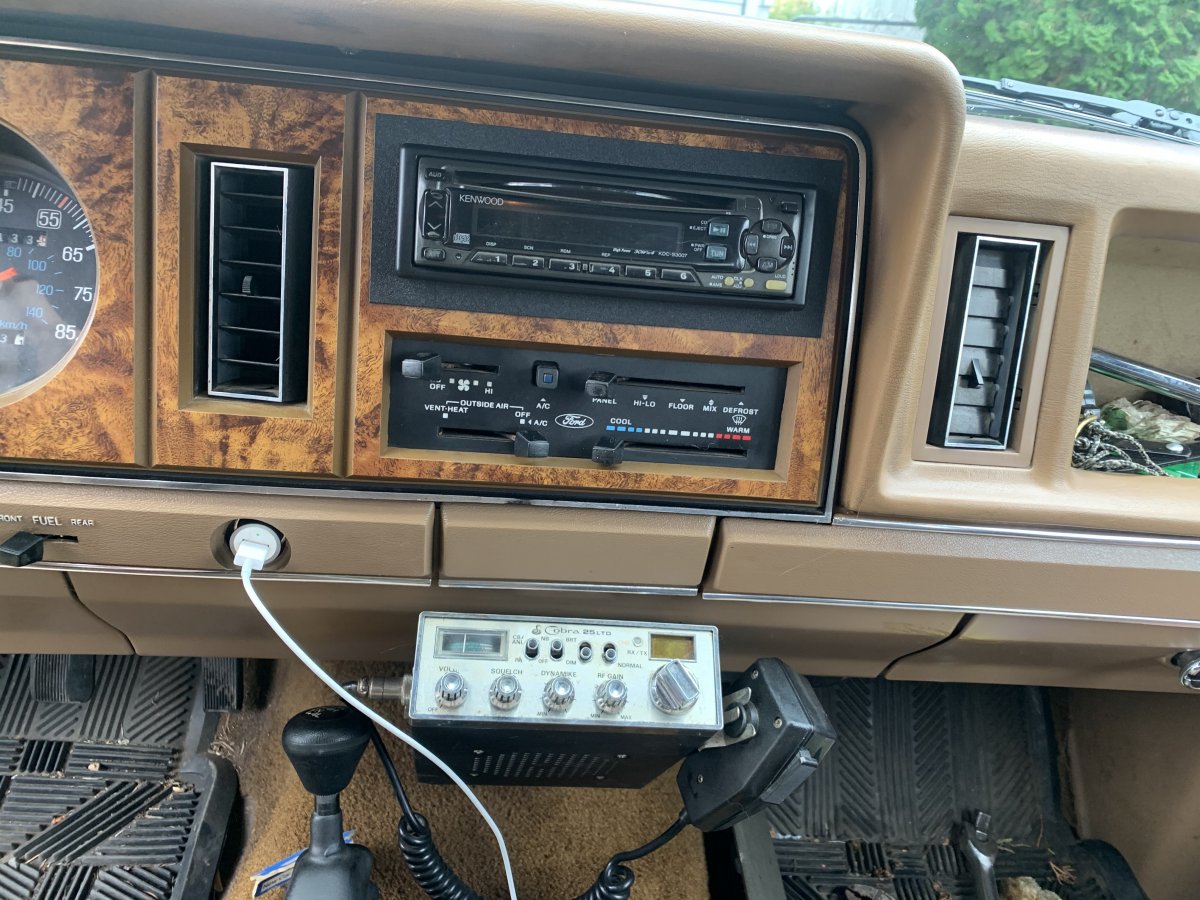

Here is a picture of the controls. Is this a factory setup with the ac switch. I think I may have it figured out. One thing though I did replace the orffice tube with a stock one. But I am using 134 instead of the r12. From what I have heard you are suppose to switch to a larger one when using the r134. Is this true. If so I ca replace that and just figure out this thermonswitch and I should be good

The Panel in cab and evaporator housing(heater box) in engine bay may have been stock, or pulled from a stock AC Ranger of similar year
Condenser(in front of radiator) may also be stock or pulled from stock Ranger
But the rest of the system is not stock
But there rest of the system is not stock
