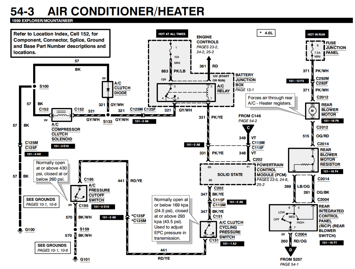

Today I completed the wiring for PCM bypass for AC operation.
The PCM received a 12v signal from the console switch to turn on A/C. The PCM the bussed the A/C cutoff switches together with the A/C power relay. Essentially the PCM is the remote control for the A/C system. Its gets to intervene at times when Ford wanted it to during your drive for a variety of reasons, none of which I care about.
So the bypass takes the 12v signal from the console switch, that 12v fires a relay I added. That relay is N.O. and when I turn the knob to A/C, it fires connecting the A/C master relay power to the A/C system. Then the pressure switches solely have control over cycling. Like OLD SCHOOL A/C.
I fired the A/C up today, short cycling constantly. Per the Helms manual, I see NOTHING in the circuit except pressure switches, to interrupt the system.
For more than an instant, I though, shit, I broke an AC line and over the last couple of months of work, I have leaked down! So I put gauges on the system (which I had rebuilt exceptionally well over a year ago) and it is full to the brim and quite happy!
Now the only thing I have changed since EFI removal is adding an Amazon 30A relay which replaces the PCM switching duty. I used the same versio of relay for my Overdrive column switch momentary conversion to low side switching, relay works phenomenally. I have not diagnosed ANYTHING at this time, not metered anything.

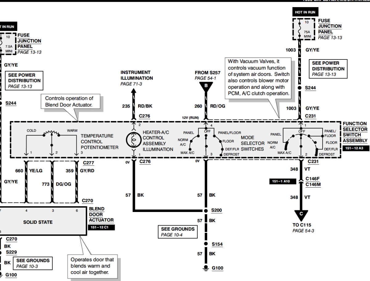

I wanted someone to validate the bypass method and my understanding of the PCM interaction with AC on/off control. I have added a few Helms excerpts for reference.
So Cir 361 is high current for lots of items- it drives the A/C system main relay coil. That coil applies power for the compressor clutch. VT wire cir 348 is 12v from the rotary control on the dash to turn AC on/off. 348 goes high, told the PCM to strap Cir 31 to 347. That completes the cutoff and cycle switch path so they can then control the compressor activity and regulate the system w or w/o a PCM.
I replaced the PCM with a relay, period.
Unless there is a bad relay, and there could be I guess, Ill check..... is there anything I am missing on the AC circuit???
I appreciaet your feedback and thank you in advance. I will report tonight re: relay testing. Screen Shot 2024-09-22 at 4.31.34 PM.pngScreen Shot 2024-09-22 at 4.31.20 PM.png

Find the low pressure switch, unplug the wiring connector and make a little jumper wire and jumper the terminals together in the wiring plug. If the compressor stops cycling, you know it's the switch.
If you find it's the switch, most of these switches are adjustable. If you are confident you have enough refrigerant in the system, look inbetween the terminals of the switch, a lot of them have a little screw in there. You can turn this screw to adjust the switch. Remember where you start from, and turn it a little bit and plug the connector back in. It will either not cycle as much(you went the correct way) or it hardly runs at all(you went the wrong way).
The only danger is if you adjust the switch too far, your evaporator will turn into a block of ice from too much cooling. If it's not very hot outside and or you have the switch on max and the cab is very cool, it will cycle the compressor.
P.S. If for some reason you do not have a lot of airflow over the evaporator coil, it will also tend to cycle. The evap coil does like to get clogged with dirt after years of use, and that will make it cycle.
franklin2, I did just that when I walked outside after posting last. I put gauges on and ran the car. 35-40 and about 180 on high. I tested the relay system, it is launching with 14v available, no issues. Then I decide to bypass the LP switch with a jumper. Ran like a champ, blowing wicked hot air. Shut off and checked static pressure, even both sides at 105.

Anyway--- thank you for the pointer to the LP switch.
Great part is---- the bypass relay works superb!
