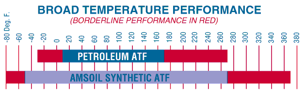

This is from Amsoil--they feel petroleum fluid is good from 10*F to 170*F with bordeline performance from -30*F to 270*F. I also researched other manufacturers sheets and this is concurred with. Thats why I said as a practical matter you can't overcool the fluid. The stuff isn't engine oil, it's already thin. It's hydraulic fluid.

And don't run it through the auxillary cooler first--run it through the fluid-fluid one. The fact is, the fluid-fluid is more efficient than the fluid to air. Under most circumstances, the cooler in the radiator is going to bring it down to the coolant temperature--or close to it.
Imagine this--you are going up a hill pulling a trailer, your foot is to the floor and you are making 150hp. The converter clutch is unlocked and the converter is doing its job--multiplying torque--its slipping 10% probably.
It's the same thing as taking a 15hp engine, connecting it to a fluid churning device and running it to full power while the fluid churning around absorbs ALL that power. It's going to get nuclear hot and destroy the fluid. You ever do that calculation in physics class where if you shook a glass of water and none of the heat from the shaking was lost, how long would it take to boil the water? This is the same thing on a grand scale. The fluid temperature can very a hell of a lot depending on what you are doing. And the fluid needs to be fairly cool. That's why Ford and eveyone else puts the auxillary after the fluid-fluid exchanger. You want it to be cooler than the engine, not the same.
I concur with Will. Transmission fluid temps does need to be lower than the raditor temps. Ideally, a good transmission will not run hotter than 160*F and no hotter than 180*F under towing.
My father learnt this lesson the hard way. RIP one tranny after being cooked.
If you plan on making the tanny work harder. I suggest sythenic fluid.
Will you are mistaken that the FLUID temperature is at issue when it is the temp of the metal parts and the seals inside the trans are more important.
Of COURSE Amsoil is going to say that pertoleum oil is only good to 170ish...
They sell synthetic!
