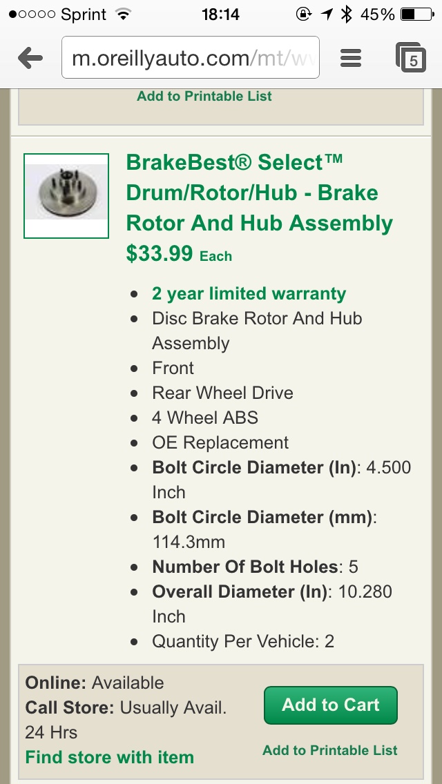

Hey guys, about to swap the 95-97 knuckles onto my 93. I jumped and bought the cheaper rotors and turns out they're for an ABS truck. I don't have 4 wheel abs as far as I know and the parts I gathered for the swap are also non abs. Will the rotors work or will I have to return them for the more expensive non abs ones?
Only difference is the tone ring....everything else is the. Same

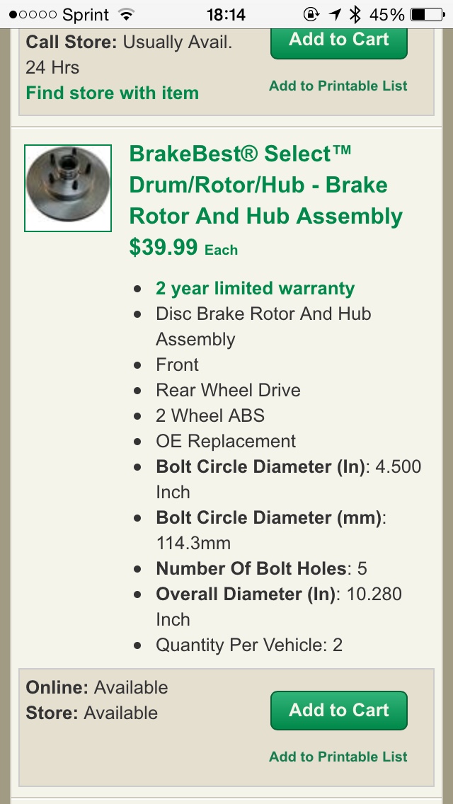

I think it's weird that the ABS parts were cheaper. When I checked O'Reillys the non-abs one was $43 and the abs rotor was $69.
I thought it was pretty weird too after finding out I got abs ones.
priced for a 97 rwd
