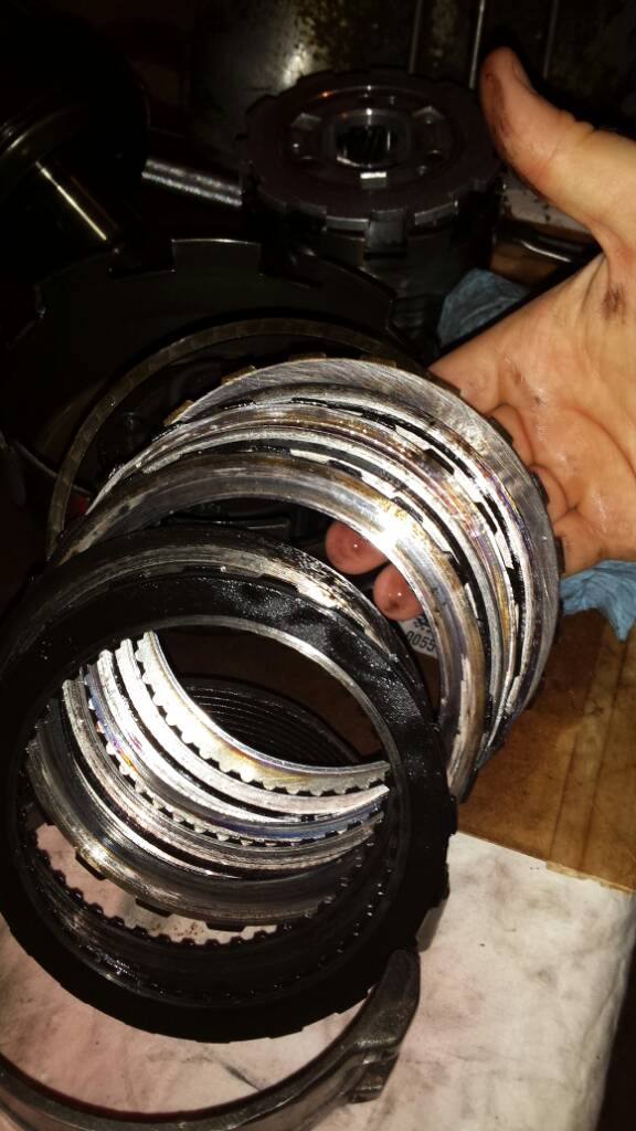

Just to close out this post because I've ran across many posts with no solutions noted and it drives me nuts. I rebuilt my transmission. My friction were worn down to nothing so that was the issue.
