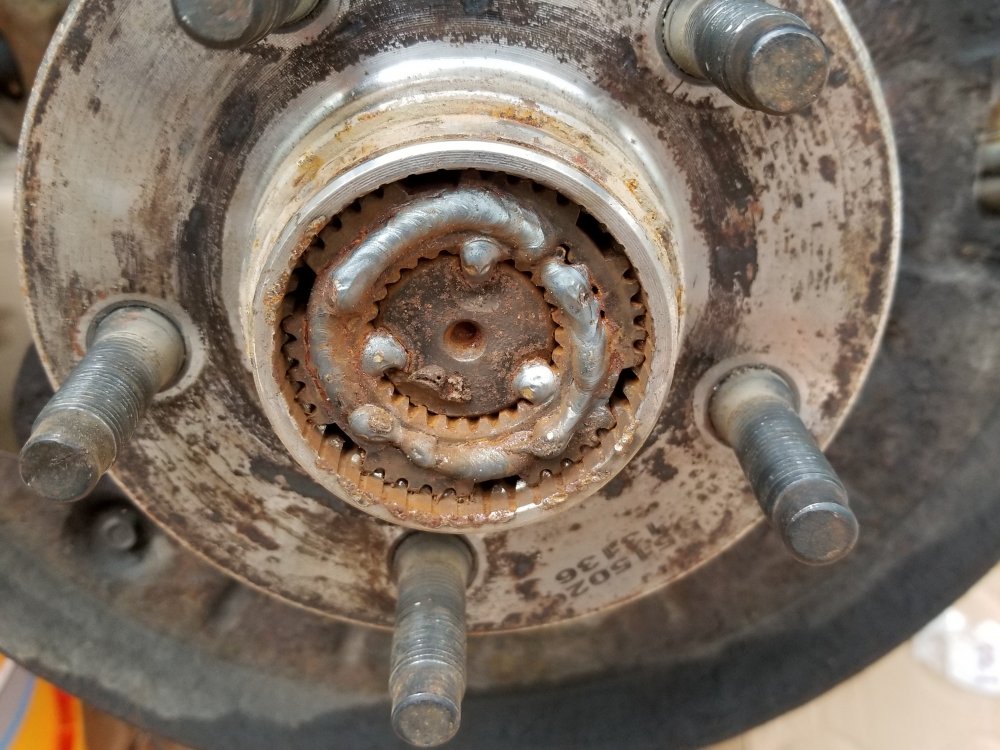

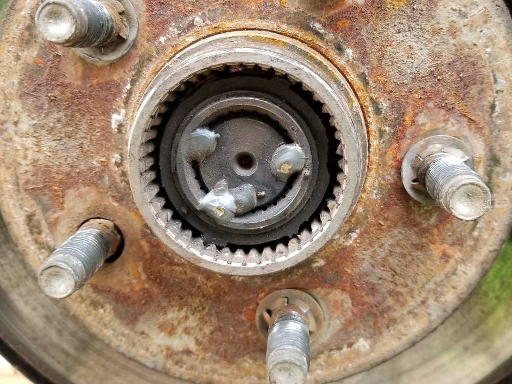

Hello i'm new to the forum and new to ranger ownership, after picking up a 98 3.0 xlt with 143k miles this summer past. Unfortunately neither one last so I'll get down to the issue at hand. This weekend i wanted to lift up the front end to replace rotten ball joints but instead i was horrified by what i found.
So here's some pictures to do the explaining.
31105
Passenger side,
31106
Drivers side.
Beneath the cover it looks like the hubs have been welded on with something on the spindle! Surely this isn't right?
Has anyone encountered anything like this before? What would a mechanic do if i brought it in to the shop vs. What can be done with simple tools? And importantly how much could it cost?
Man, that's sure a tough break, the very reason I always choose to do my own work.
You'll probably have to do some semi-major replacements. If it were me being faced with this I'd look for replacements at a wrecking yard, tool up and tear it down.
You'll get better answers than this, hopefully, that's just an idea what I'd be thinking about doing
I bet the PVH hubs took a shit and someone couldnt be without 4x4.
Probably looking at new hubs and CVs at minimum.
20 year old brake rotors too... just gonna have to pull everything off and replace it. Rotors, hubs, and axles.
I think I'd get my industrial sized dremel out and remove the 3 tacs first. See what happens. Replace what you need to then. You probably have to do grind the welds anyway to get it apart to replace so at least its not wasted time.
