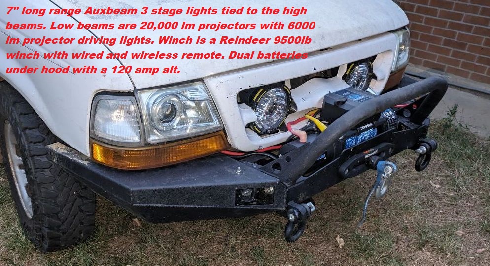

Also, this is a farm/ranch service truck that I am building. At this point, body and paint is the only thing left to do, aside from this heat issue. But this list of mods to date are as follows: The truck has a 4" suspension lift. P235/75R15 (30x9.50 basically) Yokohama GeoLander mud terrain tires. The rear axle was swapped out to a larger 8.8 Ford rear axle out of a Ford F150 that was cut and narrowed to fit the Ranger's width, and then had 4.88 gears with a Yukon locker installed. Custom 1 ton springs added to haul the 1800lbs of tools in the bed. Additional mods include a Reindeer 9500lb winch, dual batteries, an 8000 watt DC/AC inverter with 3 Renogy 200AH batteries running it. A Renogy 4 panel solar array that charges 40 amps to the 3 inverter batteries. Also I have a 'deadman' switch in the cab I can switch to tie the custom 150 amp alternator's output to the 3 inverter batteries if more current is needed. Lighting is all handled with dual LED light pods on the reverse lights. In addition to a set of 3 stage AuxBeam lights in the grille tied onto the high beams circuit. Also added a set of aftermarket mirrors that have a spot and flood light combo in the front of them them that are also tied to the high beam circuit. Low beams are handled with aftermarket projector headlight assemblies that house a pair of fan cooled 22,000 lumen LED lights and is also assisted with a pair of aftermarket 12,000 lumen projector driving lights in the bumper. Custom winch bumper with matching back bumper. Rear facing 24" Rough Country dual row LED light bar for inconsiderate drivers that come up behind me with high beams on.

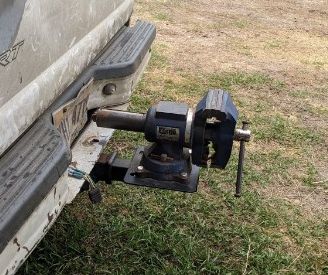

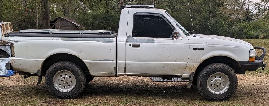

I have been working on this truck for about 6-8 months, building it while working out of it. I am currently at the stage where I have all of the mechanical stuffs done...other than this water pump. Body and paint is next. So please dont cut on me for it not being pretty....yet. Part of me doesnt want to make it look good as that will attract attn to it AKA thieves.

Nice looking truck.
