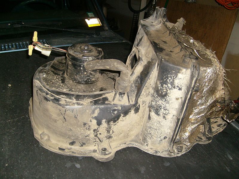

does anyone have one of these apart that could snap me a pic, I had it up on the lift today but just couldn't see anything up there.
No other drain that I know of but there is the vent tube from the blower motor into the bottom of the box.
