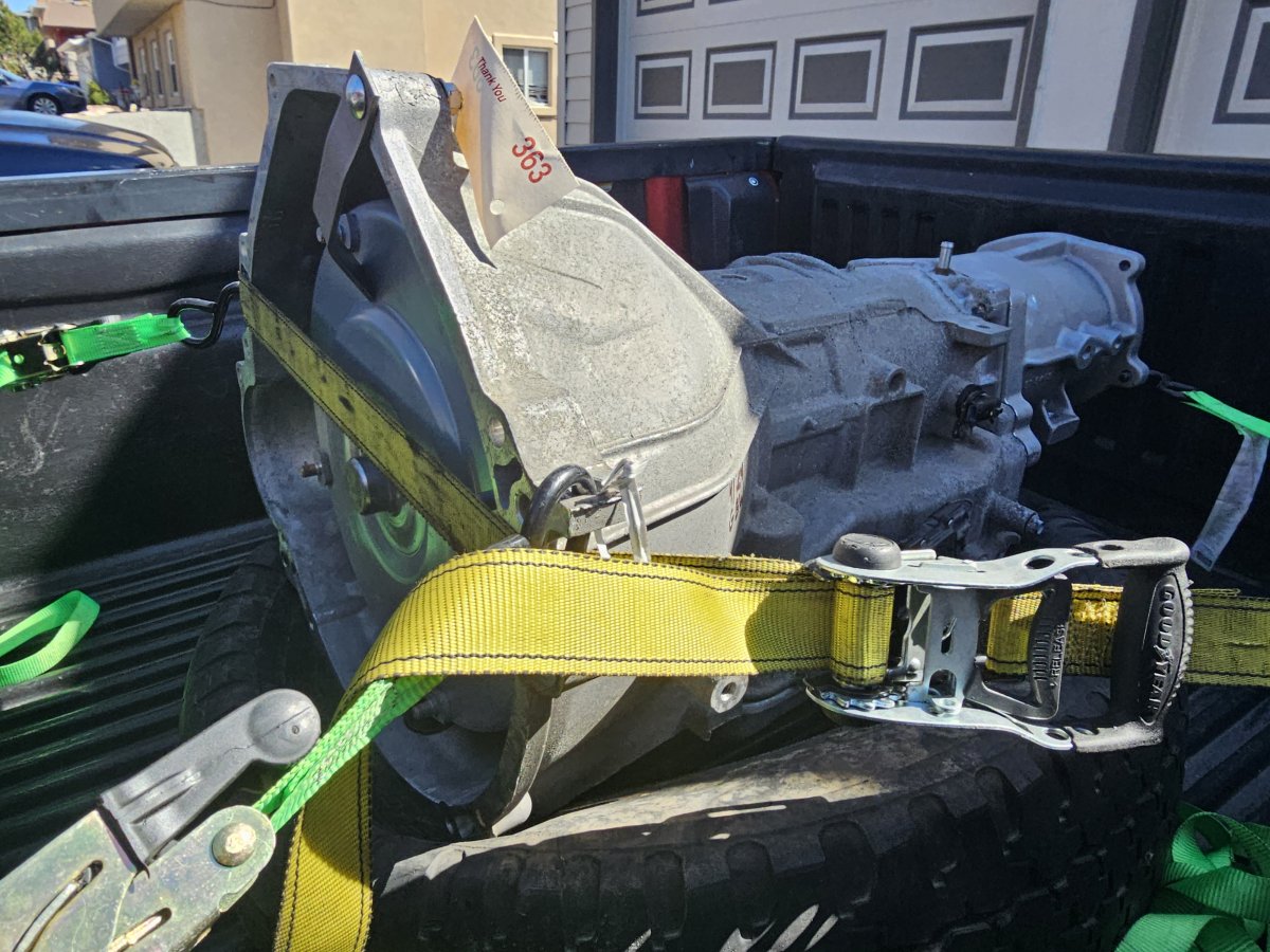

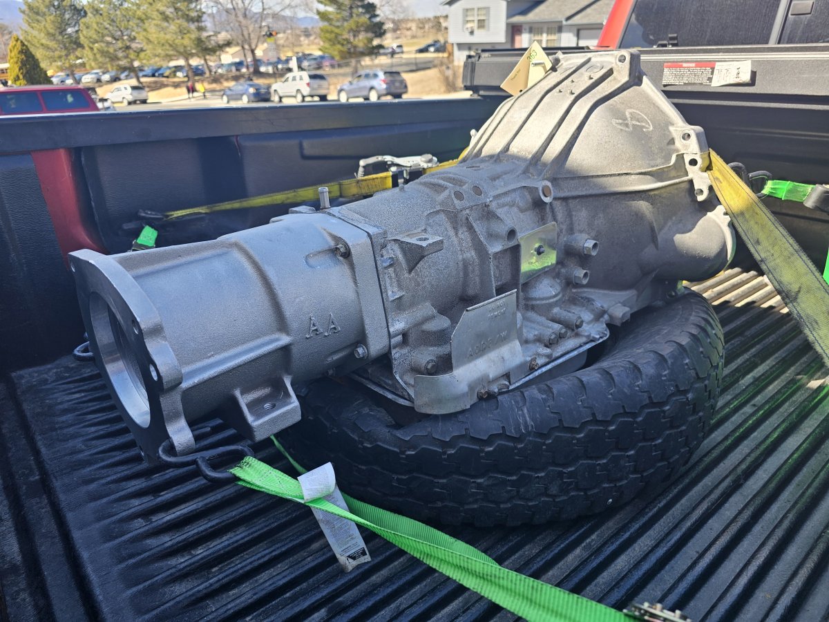

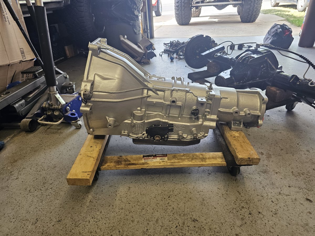

Picked up the transmission today. Here it is, all rebuilt and cleaned up with a new converter and the 1354 adapter installed.
They said the 1354 should be just fine back there. I am retaining the original adapter and output shaft just in case.

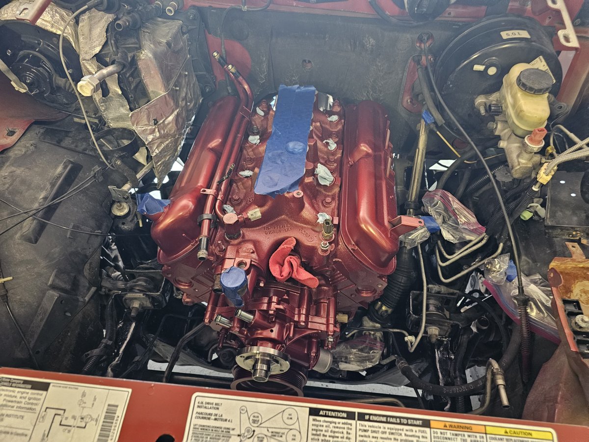

Also dropped off the intakes and valve covers at the machine shop. He has the paint code and is going to paint them to match the truck.

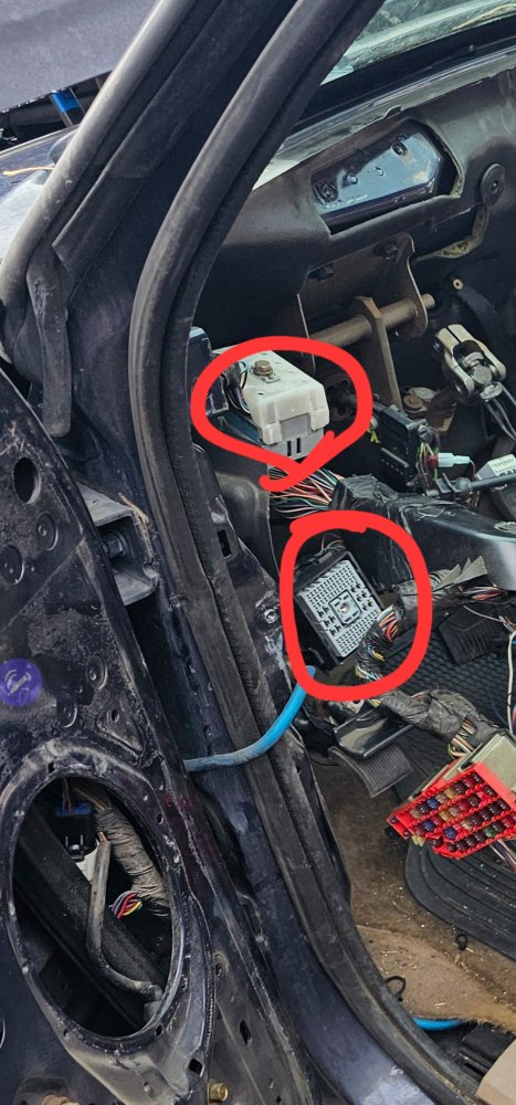

Some more wiring questions...

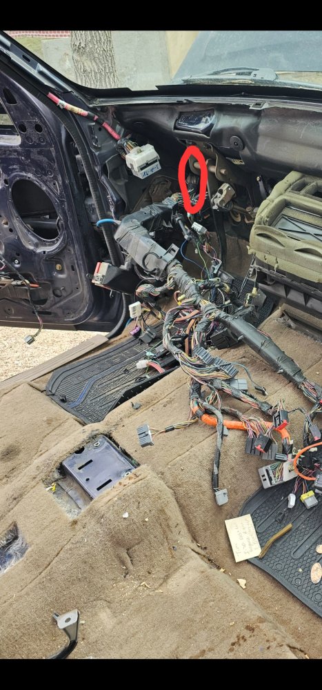

Circled is the bulkhead on the drivers side that connects the dash harness to the door, everything overhead, and the rear of the vehicle. There seems to be a lot more going on here than necessary. What is the best way to weed out what is not needed? For instance, from what I understand, the rear harness for the Ranger is under the cab on the frame. So this section of the Mountaineer harness would be redundant.
However, there are some functions of the Mountaineer that I would like to retain (power seats, power door locks, possibly power mirrors, but I don't want the power windows). The Ranger is manual everything and does not currently have any of these power functions.
And circled here is where the dash harness feeds through the firewall. It doesn't appear to meet the engine harness directly, but connects to another harness for everything else in the engine bay, including the fuse/relay box. This Mountaineer fuse box differs from the one in the Ranger, so I assume this 'third' harness will need to be swapped over as well?

Power mirrors are a self contained system you can easily wire yourself
Pull drivers door power mirror with wiring and switch
Pull passenger door power mirror
Below is a 1999 power mirror setup
Literally 12volt and ground wire to switch, and 3 wires to Passenger door mirror
You can try to separate the 3 wires out of dash harness, but........its 3 wires, I would just run 3 new wires

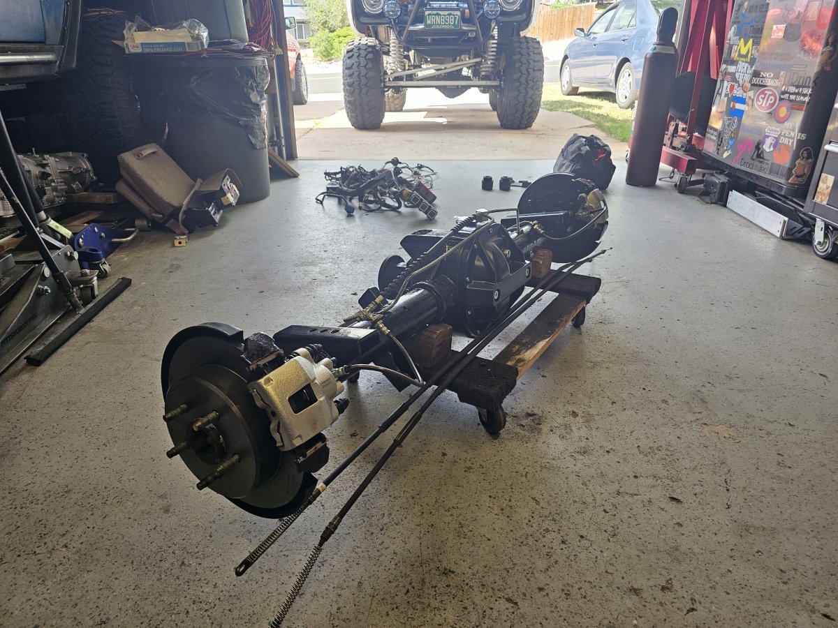

Looks like the Mountaineer parking brake cables will work. I had some left over from an old Bronco project, but it turns out both of them are for the passenger side. RockAuto has been my friend lately.

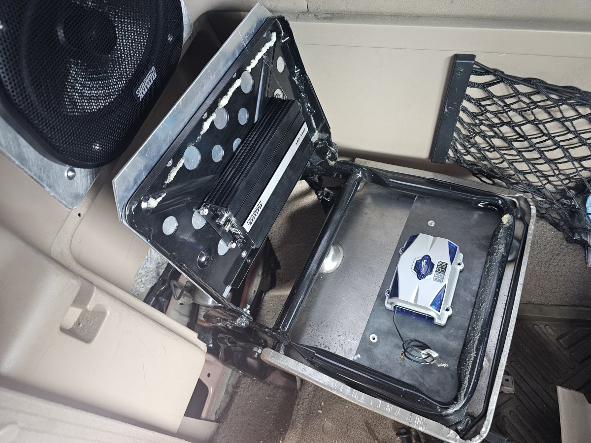

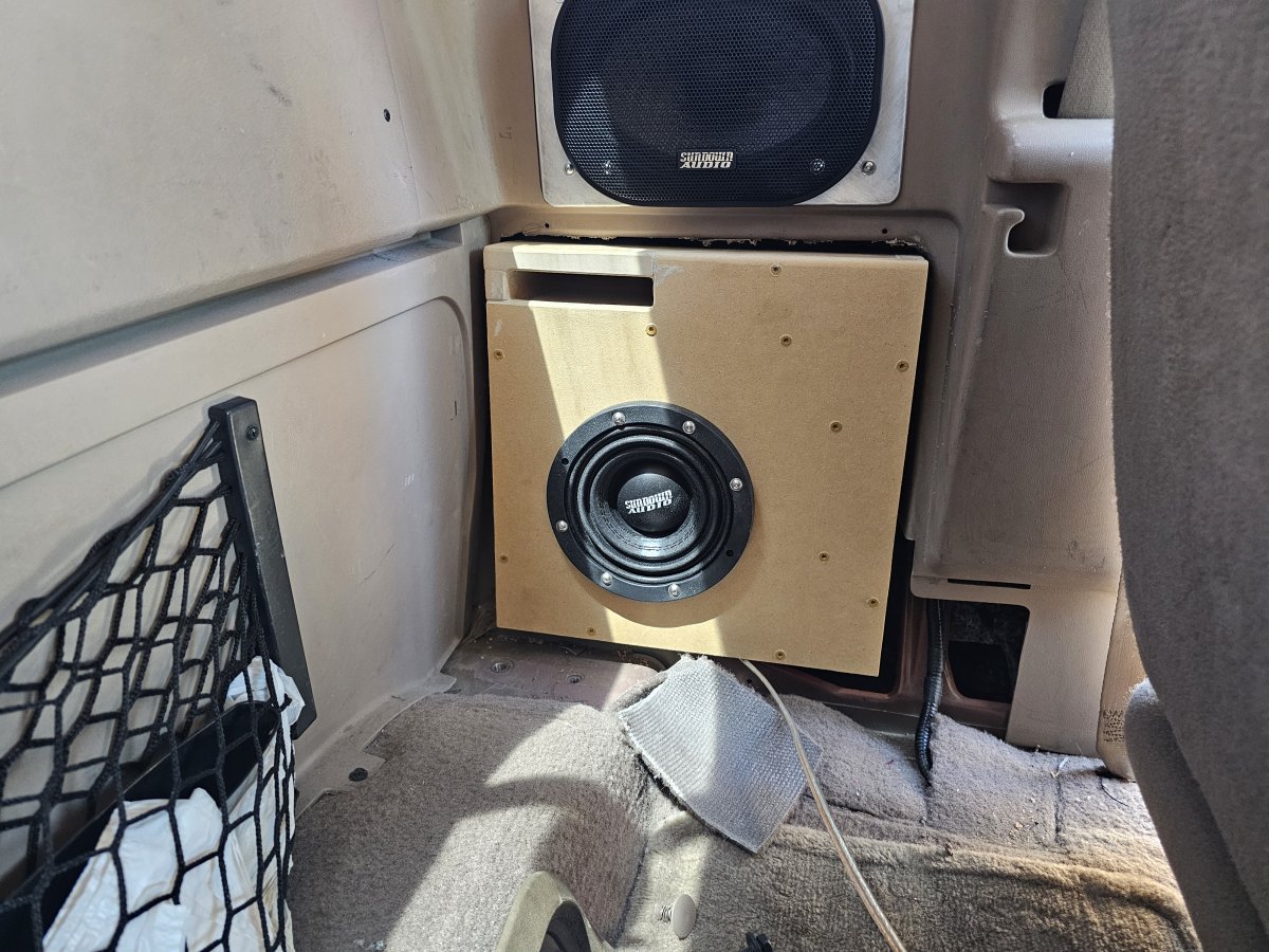

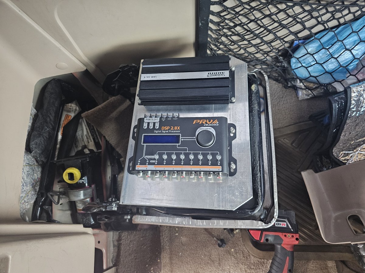

Side project -
...my first attempt at a sub box. Fits a 6.5 nicely in the drivers side jump seat cavity. I then transformed the passenger side jump seat into an amp and dsp rack. Just a test fit and mock up for now.

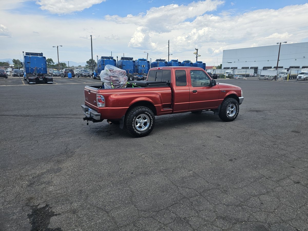

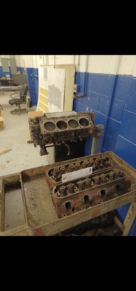

Well, I brought the overhauled 5.0 home last week...
... i found it intriguing, bringing the donor home in the recipient vehicle.
Anyway, I didn't have much time to dedicate to the engine last week due to prior commitments, so I went on ahead and stuffed the Mountaineer 8.8 under there.

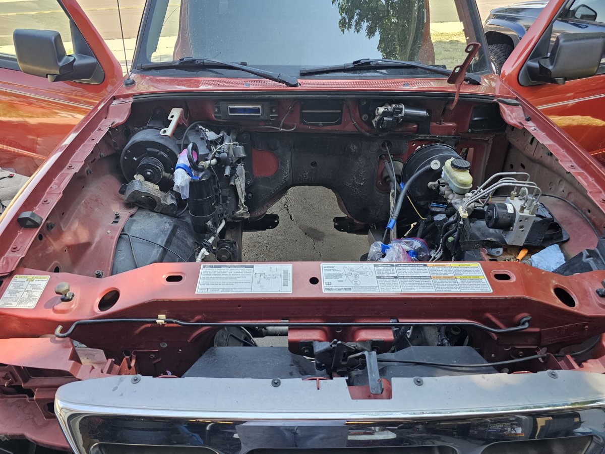

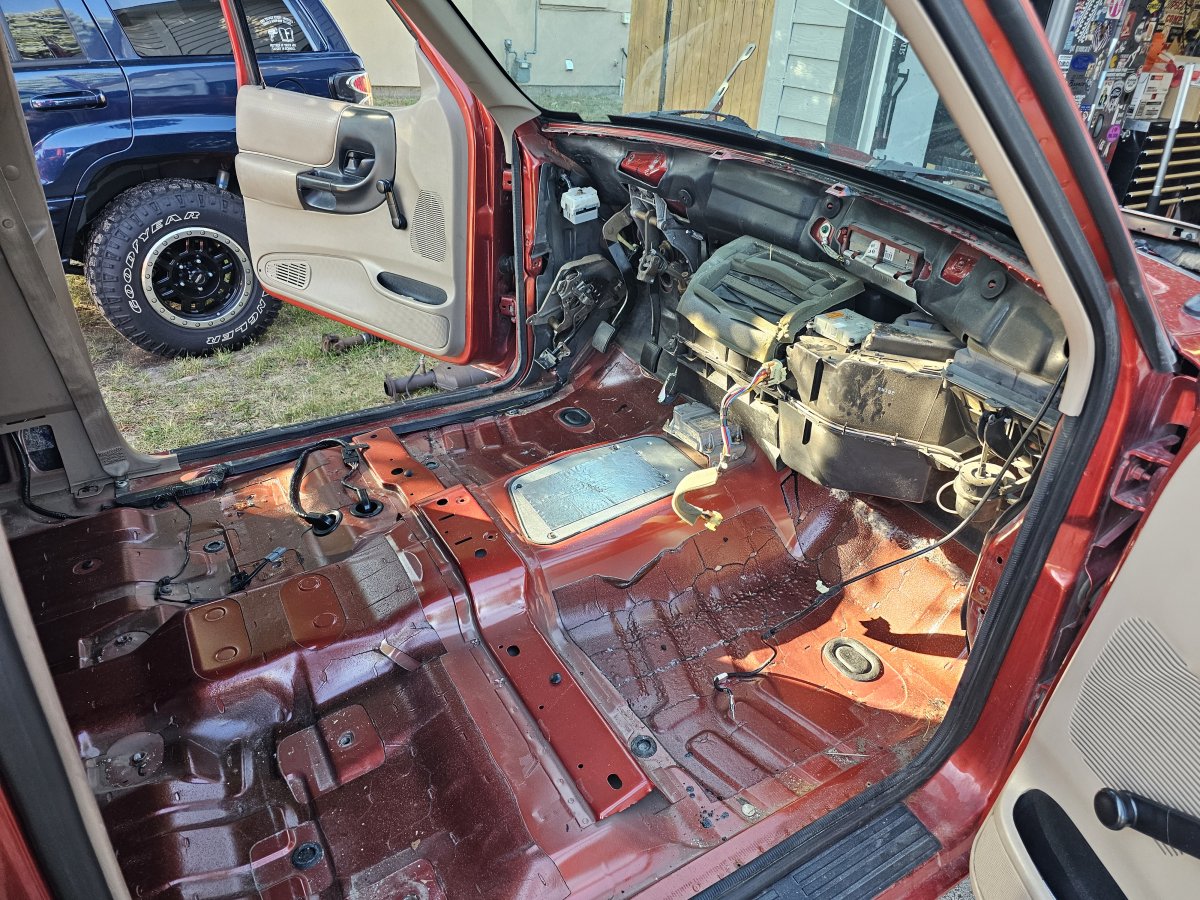

Over the weekend I got the powertrain out.
The interior and dash gutted.

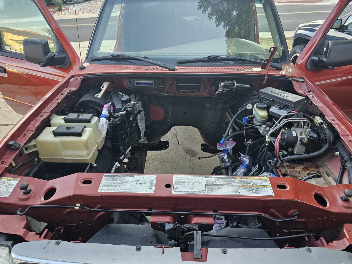

Stripped the engine bay harness.

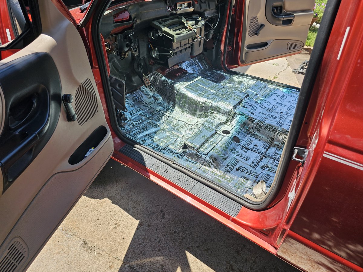

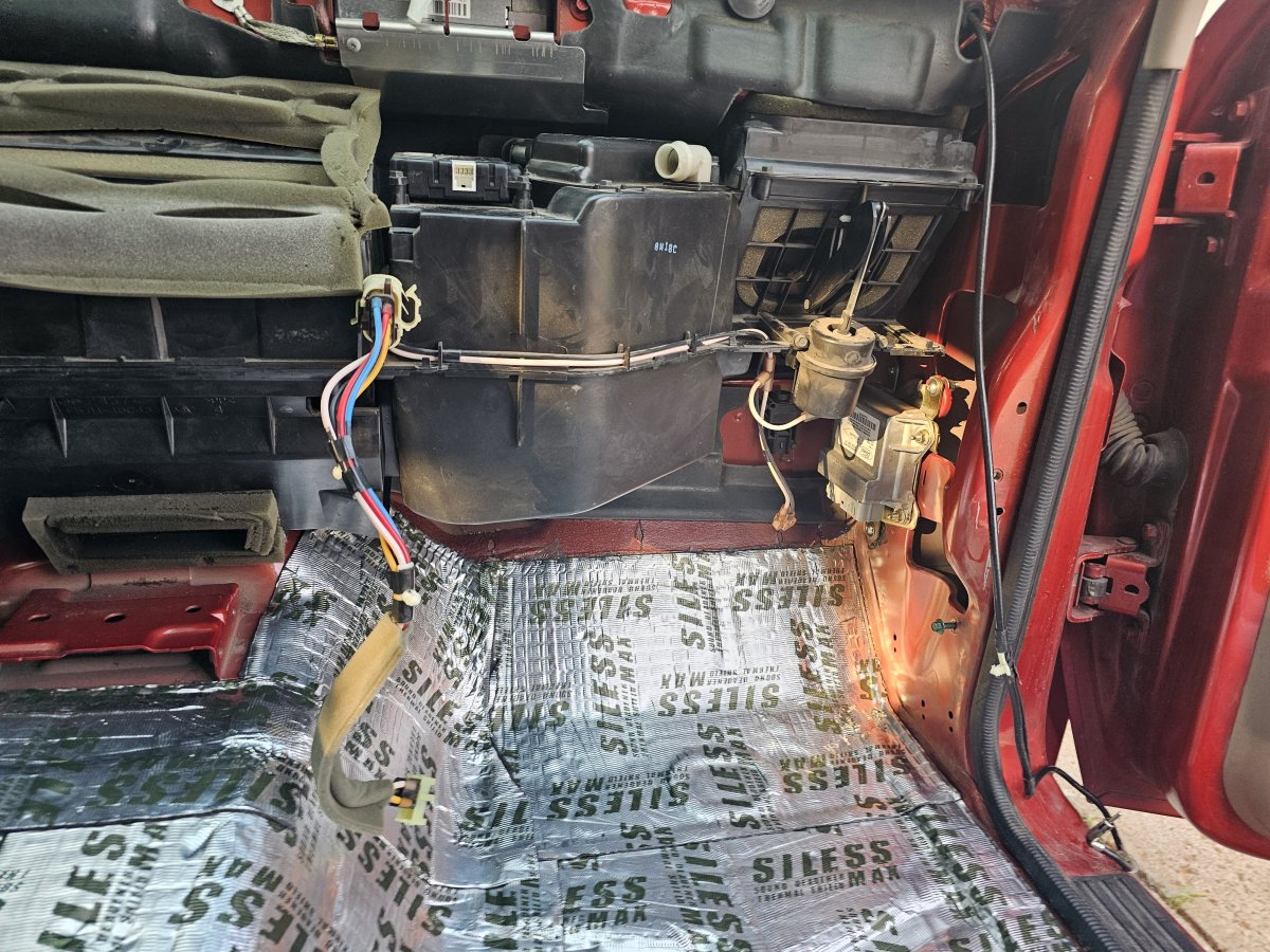

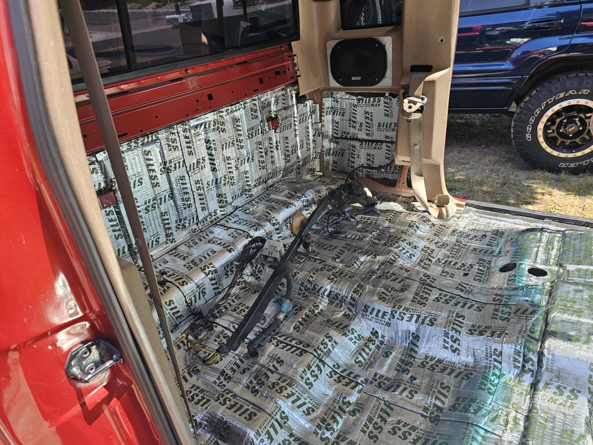

Went on ahead and laid in some sound deadener to the interior. I really thought this would have been more fun...
Swapped over the brake pedal for the automatic, along with the brake booster and master cylinder. The ABS module is the same between the two.
Replaced both motor mounts.
Rebuilt the heater and a/c boxes and replaced the heater core and evaporator. I'll install the new dryer just before I'm ready to charge the system to keep condensation to a minimum.
Installed the automatic trans cooler. The holes were already there even though it was a standard, but the air dam for the radiator is not cut to accommodate the cooler.
Relocated the air bag module from under the dash to the passenger side kick panel since I will be using the Mountaineer center console. As with the trans cooler, these holes were already there, just needed some threaded inserts.
Got the engine stabbed in yesterday and the transmission attached.

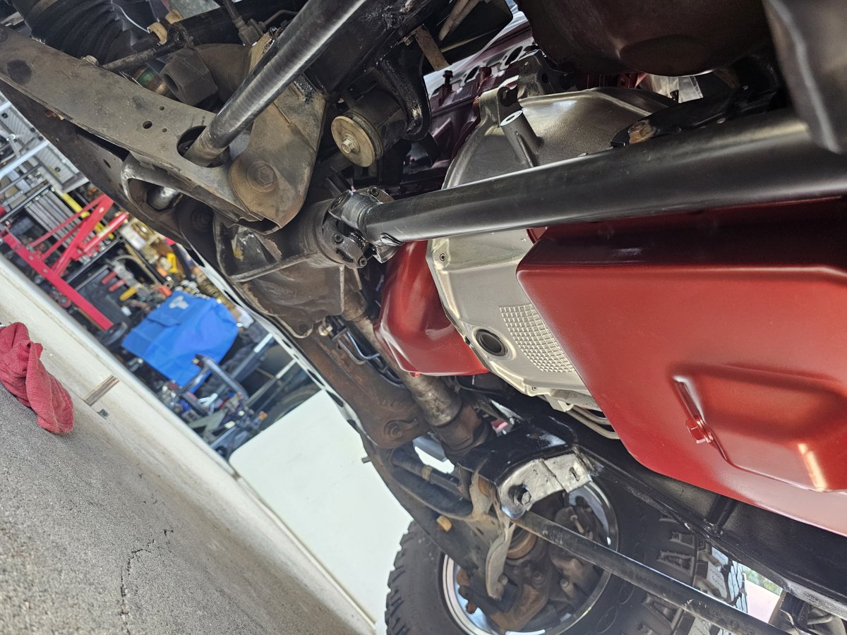

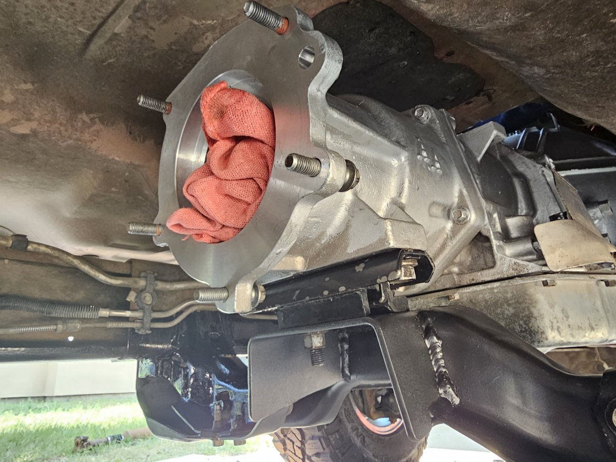

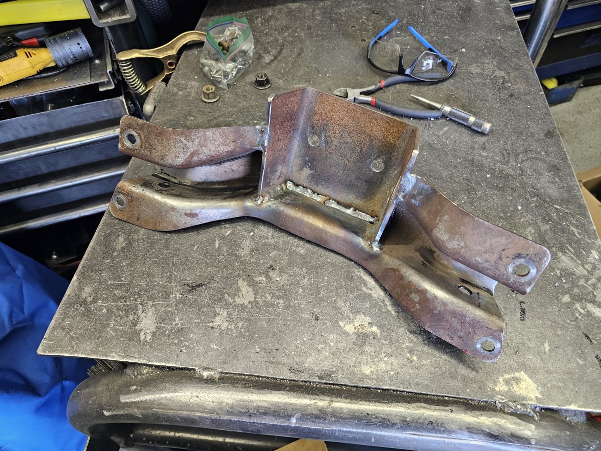

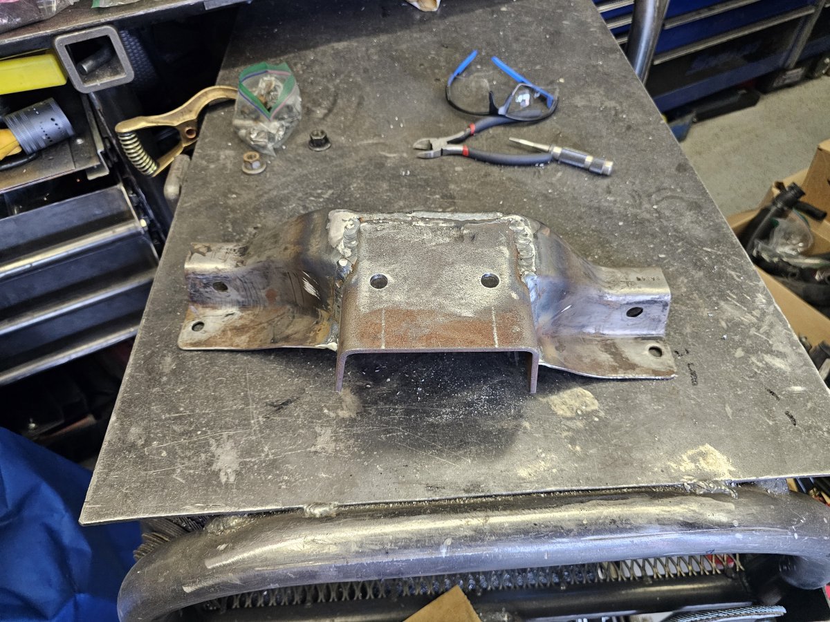

The crossmemeber no longer lines up with the mount after the new adapter. It proved to be at least an inch short. Hacked and fabbed out something that seems to work. Please be kind, I'm a truck driver by trade, not a welder/fabricator.

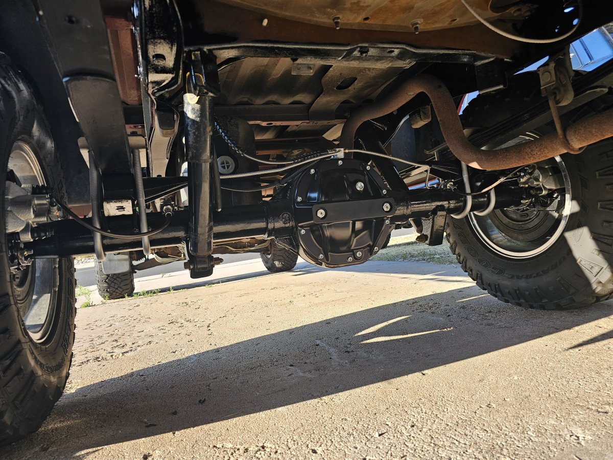

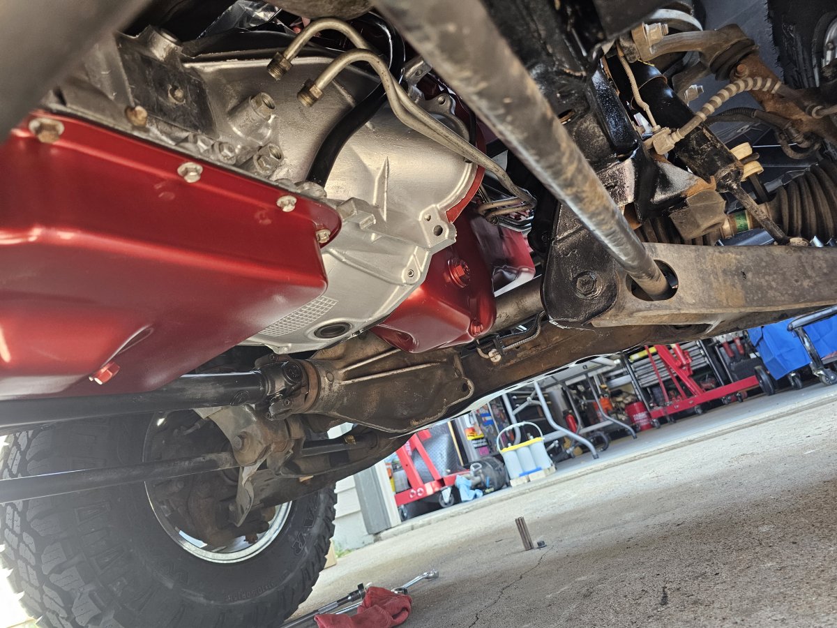

Attached the bw1354 and, no, the driveshafts did not fit. The front is 2 inches too short and the rear is, yup, 2 inches too long. They are at the shop now.

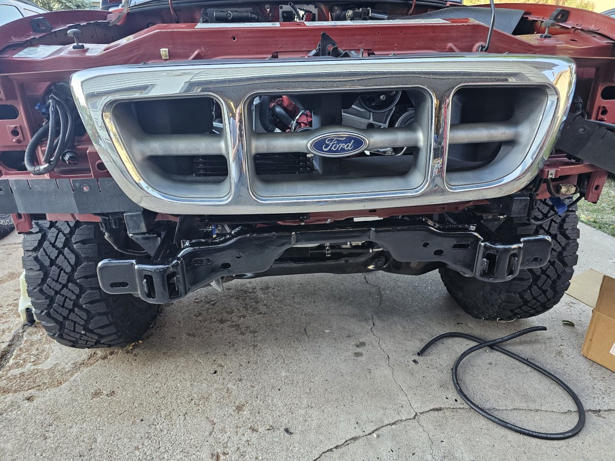

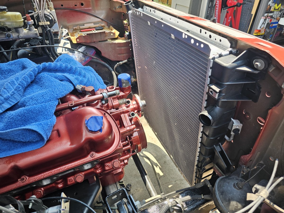

The new radiator and condenser fit well. Bought both for the Mountaineer, but they are a perfect fit for the Ranger.

The Mountaineer engine bay harness only had provisions for 1 turn signal/running light per side opposed to the Rangers 3 per side. My wicked smart neighbor is being kind enough to help me out here and has stripped the wiring for the lights and the pvh solenoid from the Ranger harness and is incorporating said wiring into the Mountaineer harness.

The undercarriage came out well, this is an older picture, prior to exhaust...

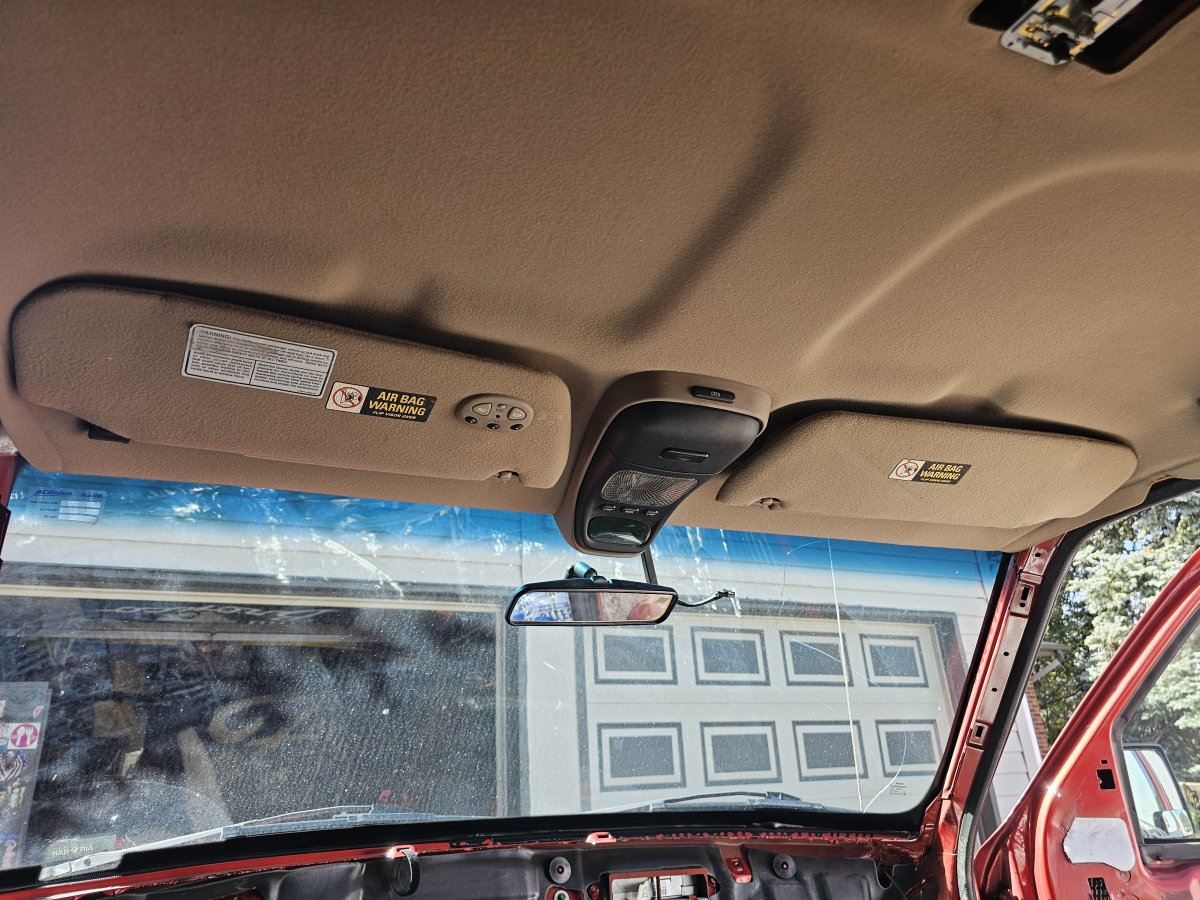

Anyway, the overhead console and lighted visors went in well. There are several write ups out there on this. Since I'm using 90% of the Mountaineer wiring, all I really needed to do was mount the physical pieces, then plug and play from there.

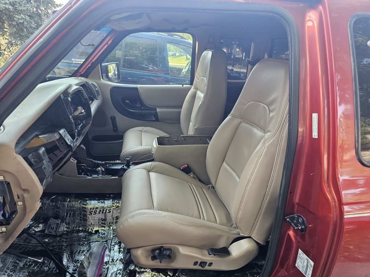

The interior is coming along. Got the seats to the shop for a face lift (ahem... $$$!!!, cough.) and picked them up the other day. The seat wiring had to be shortened up. As with the door power, they were routed all the way to the rear left quarter panel.
That's the old, bare Mountaineer dash set in place just so I could align the center console.

All radiator and heater hoses for the 5.0 fit fine. The 5.0 radiator is twice as thick as the Rangers, but fits like it was made to. The a/c condenser is completely different between the two vehicles. The SUV uses plastic brackets that mount the a/c condenser to the radiator. The Ranger condenser bolts to a bracket, mounted to the core support. This bracket can be removed and the plastic pieces from the SUV can be used in place of the Rangers. I'm not sure if the Ranger condenser would line up with the SUV a/c hoses.
