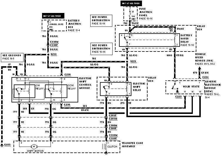

You need a 99 wiring diagram. I may have something for a 99. I'll check that out
Is this enough to sort it out?

Good to hear another positive about the 1354. Now I just need to know how the Mountaineer wiring will control the 4x4 functions. Not finding anything out there about the issue.
The Mtnr wiring will not control the 4x4 functions as all the V8 Mtnr were awd with no transfer case controls. If you want to use the Mtnr wiring, you will need manual control of the transfer case.

I have one for the 99 Explorer/Mountaineer but cannot get it to paste here
I thought the transfer case controller was separate? Did it get integrated?
The 4406 and 1354 are very similar in function, my Explorer (manual 4406) and Ranger (manual 1354) shift the same assuming you ignore the auto trans on the Explorer and manual on the Ranger. they both shift just fine between 4x2 and 4x4 high and back without doing anything dumb, assuming I shift to neutral I've gone from low to high on both just fine with the normal clinky clanking (don't make that one a habit). The 1354's don't have a bad reputation but I wouldn't pay more money to run a 1354 over a 4406...
From the description above, it sounds like the Mountaineer is not a true "AWD" in the sense most people think. The electronics are controlling the transfer case to make it "look" and "act" like AWD in certain modes. My Tahoe works like this. I never use the "auto" function, I feel like it's too much wear in the transfer case clutch.
I would use the mountaineer transfer case and drive on. Sounds like it would work for your purposes when you needed 4x4 in the pickup.
The V6's part time case may function that way, but the V8 gets a true AWD case with no external controls whatsoever (and no low range).
So he can use the mountaineer GEM with no problems? Use the mountaineer GEM with a manual lever transfer case?
At first glance I don't see why not? But I defer to people that know better.
You'd need to splice a couple of wires to make the 4wd lights work on the dash.
