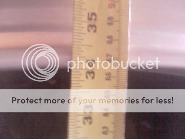

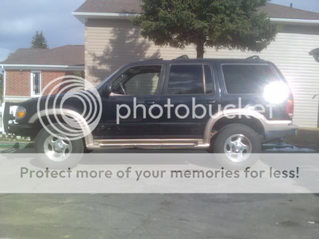

Here it is before...with measurements. Rear first then front.

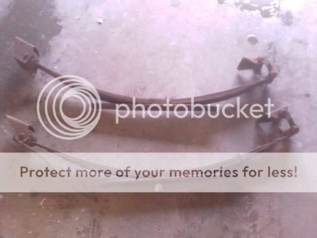

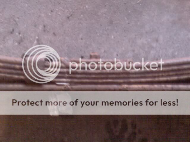

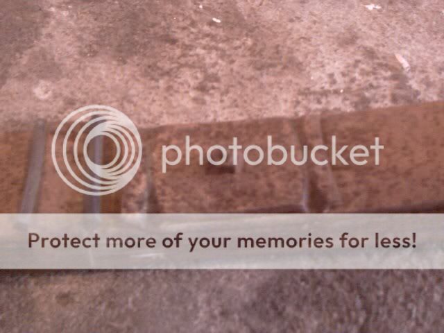

A pic of the F-150 leaf packs
You can see they came with 5 leafs

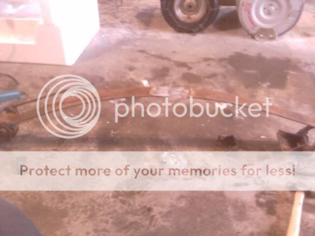

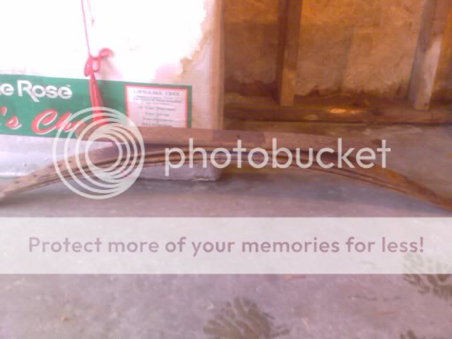

This little sucker had to go. Cut-off wheel made quick work of it.
Here it is with the main leaf separated from the rest

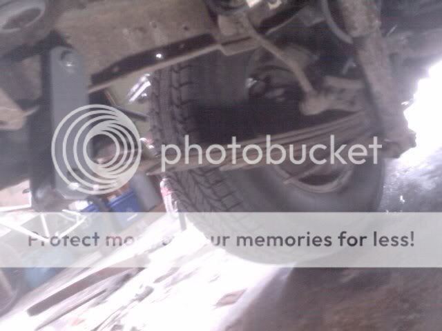

Here's what the driver's side looked like after completion.

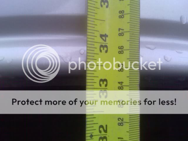

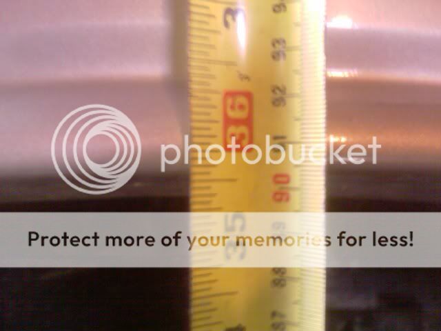

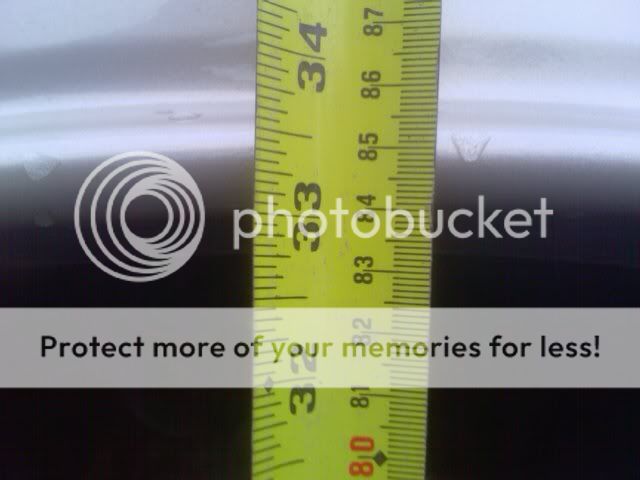

New measurement, rear then front
I could only lift the front 1" due to the drivers side torsion adjuster bolt bottoming out. So I'll have to go see if I can get a longer bolt that'll fit.

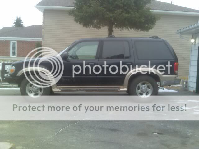

After pic.
