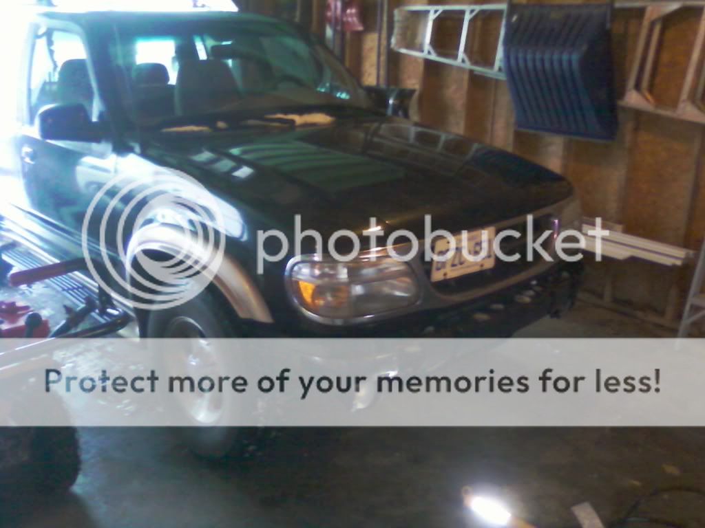

Factory bumper removal time...

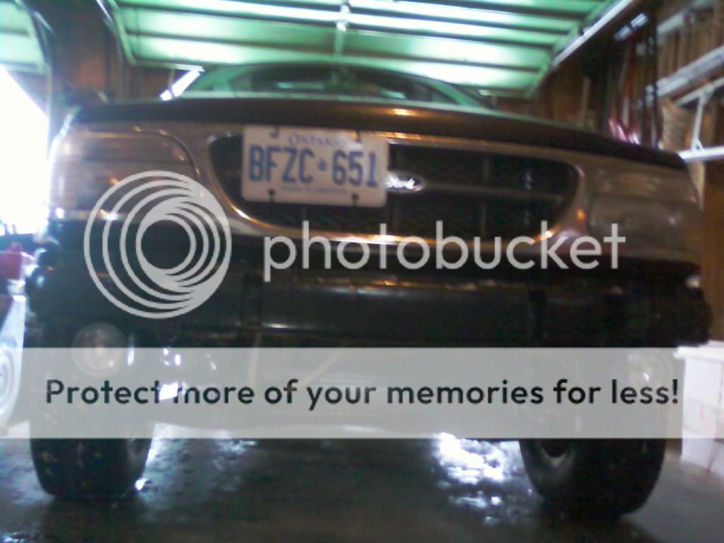

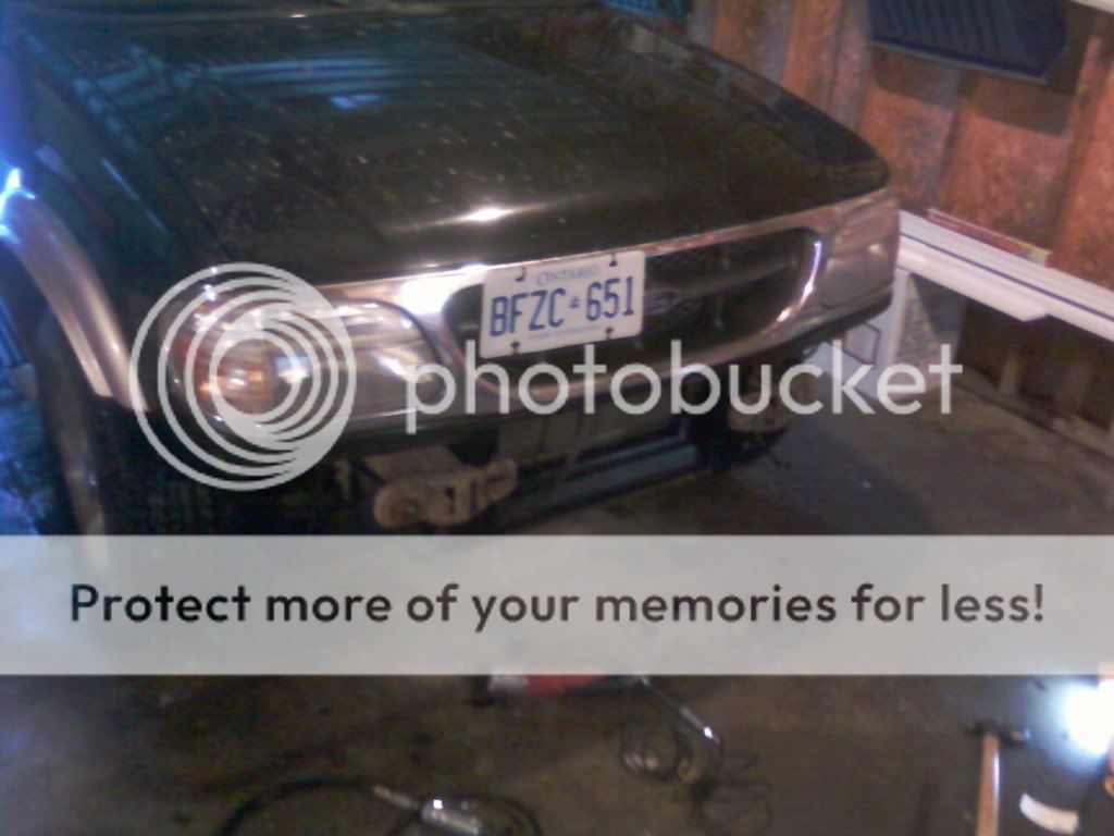

Here she is before surgery

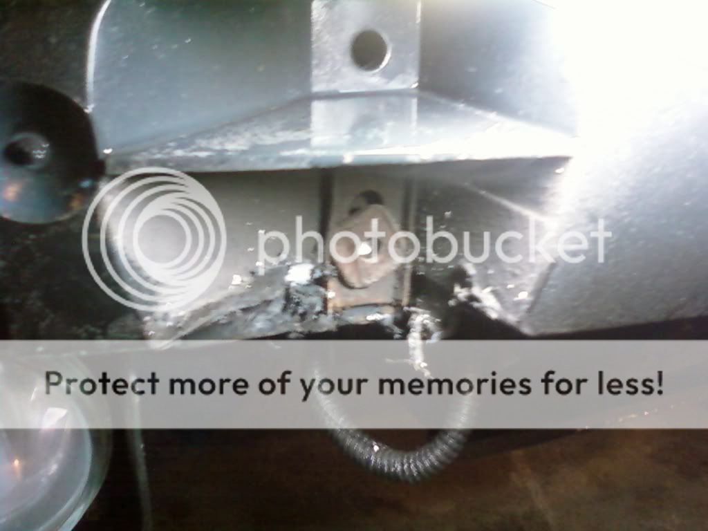

I tried getting behind the bumper with an impact to remove it the "nice" way, but the carrige bolts were stubbourn.
'99 EB Explorer Official Build Thread

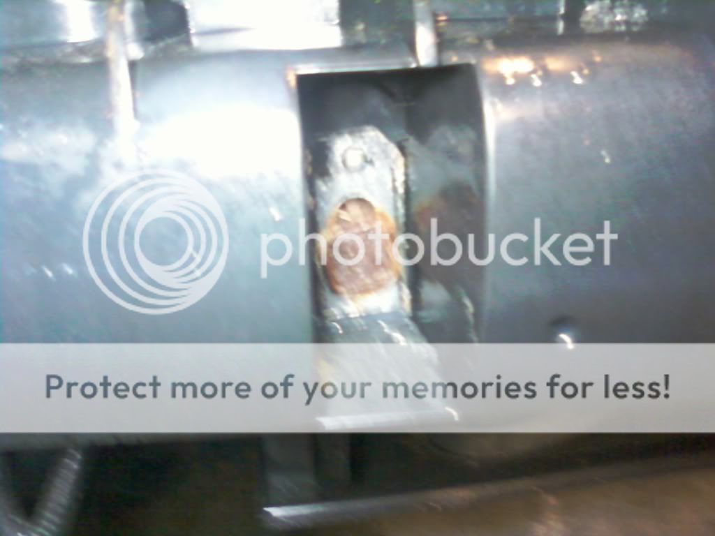

So I tried the air grinder with a cutoff wheel....couldn't get a good angle on it. Then I tried drilling them out...SUCCESS!! Well partially anyway. The first one came off with a few hits using the pry bar and hammer....the other three popped off when I went back in bind the bumper with the breaker bar. The drilling weakened the bolts enough to pop them off.
Here you can see the hole from drilling

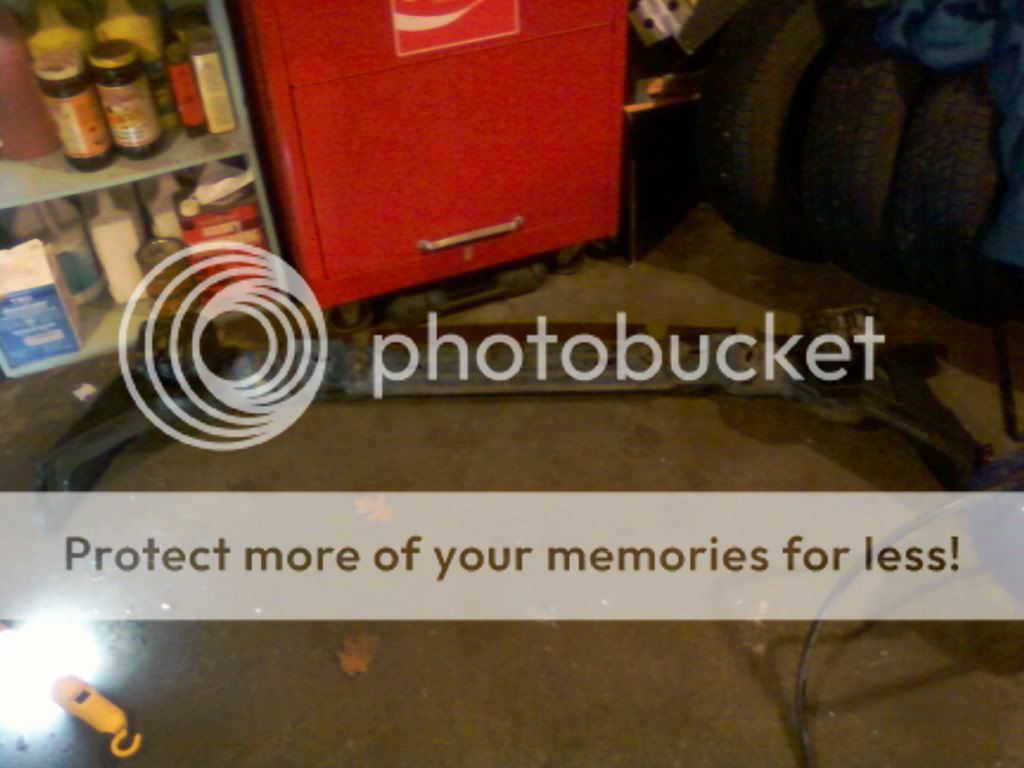

Here it is after removal

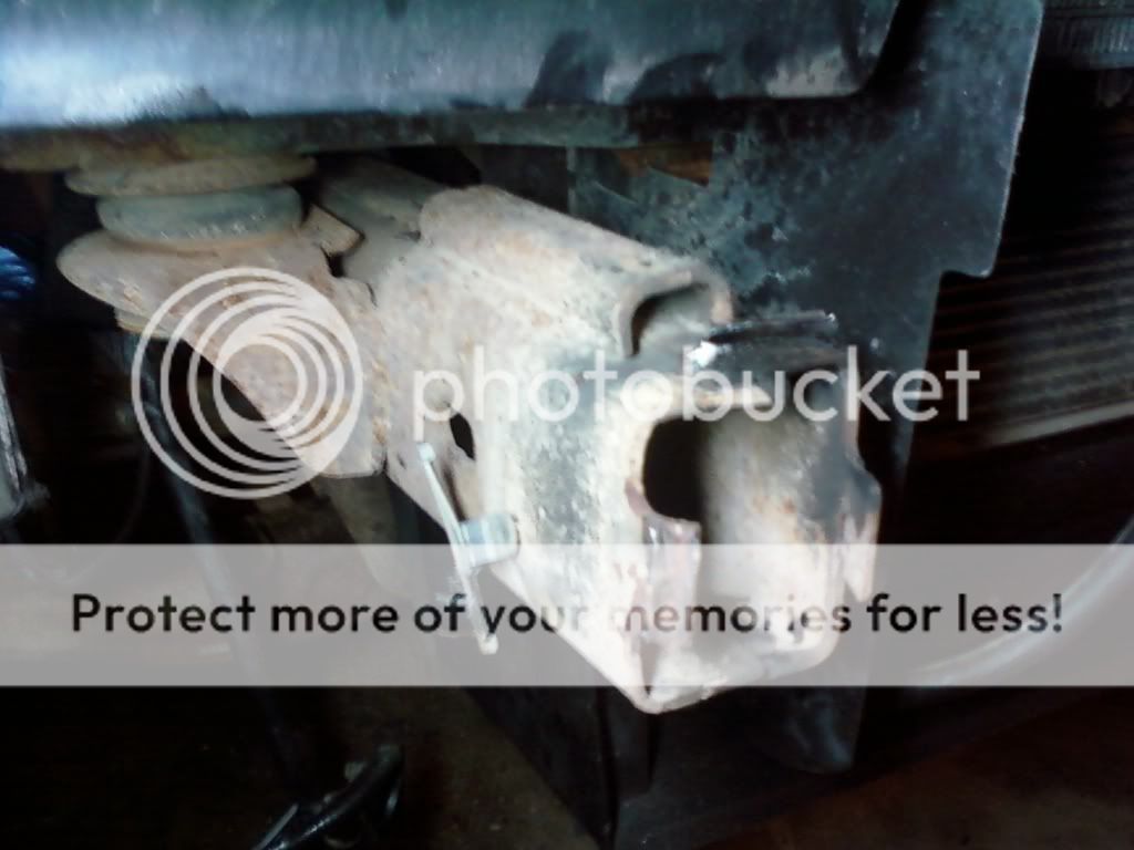

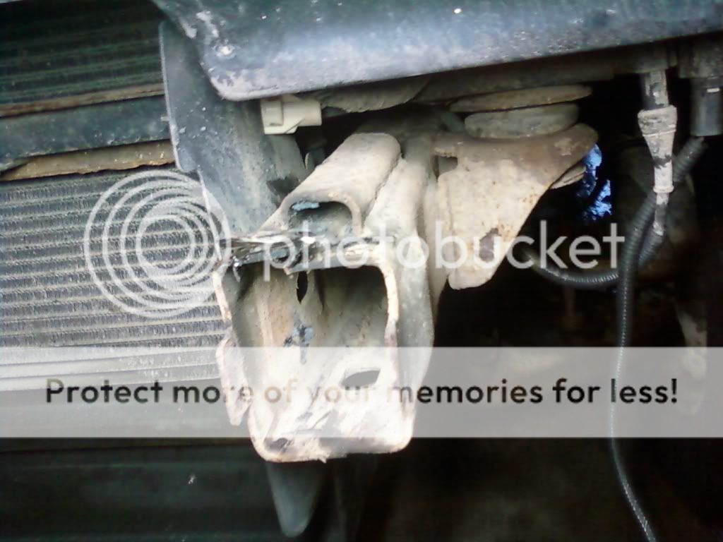

These bad boys were my next problem. They had to go! But by that time, my air line had frozen solid, so it was time to bust out the 4" electric grinder with cut off wheel.

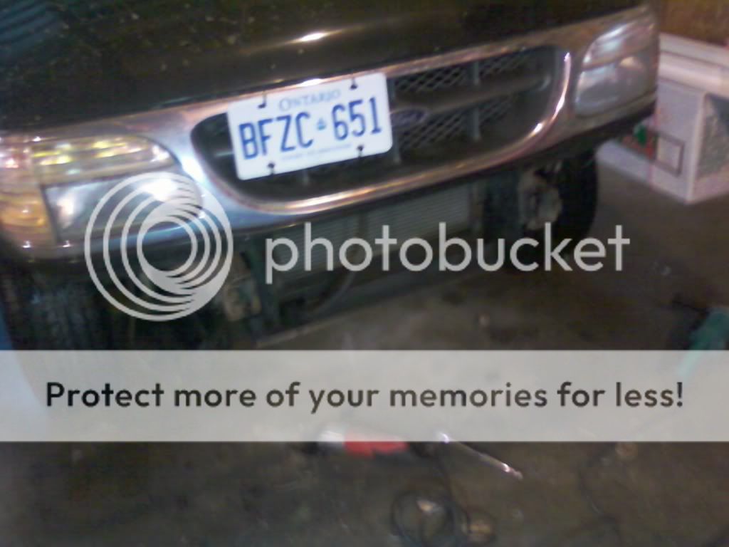

Here's a couple with the bumper off but the bracket still on
Each bracket had 4 welds holding it to the frame about 1" long. The cut off wheel made short work of that.

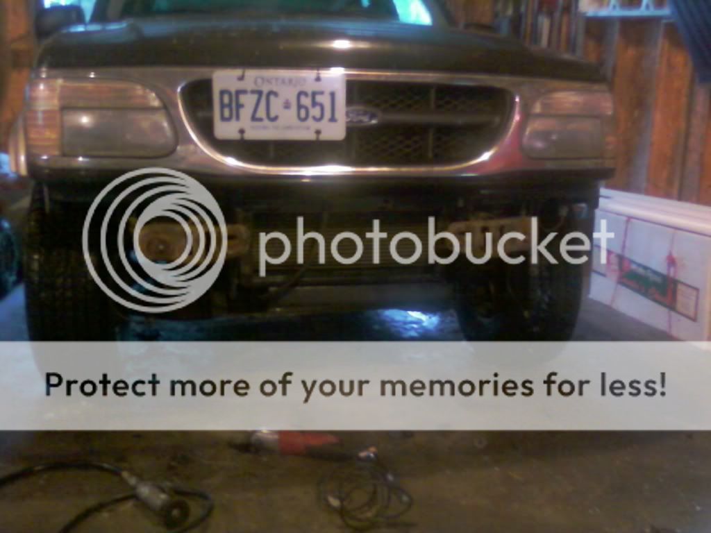

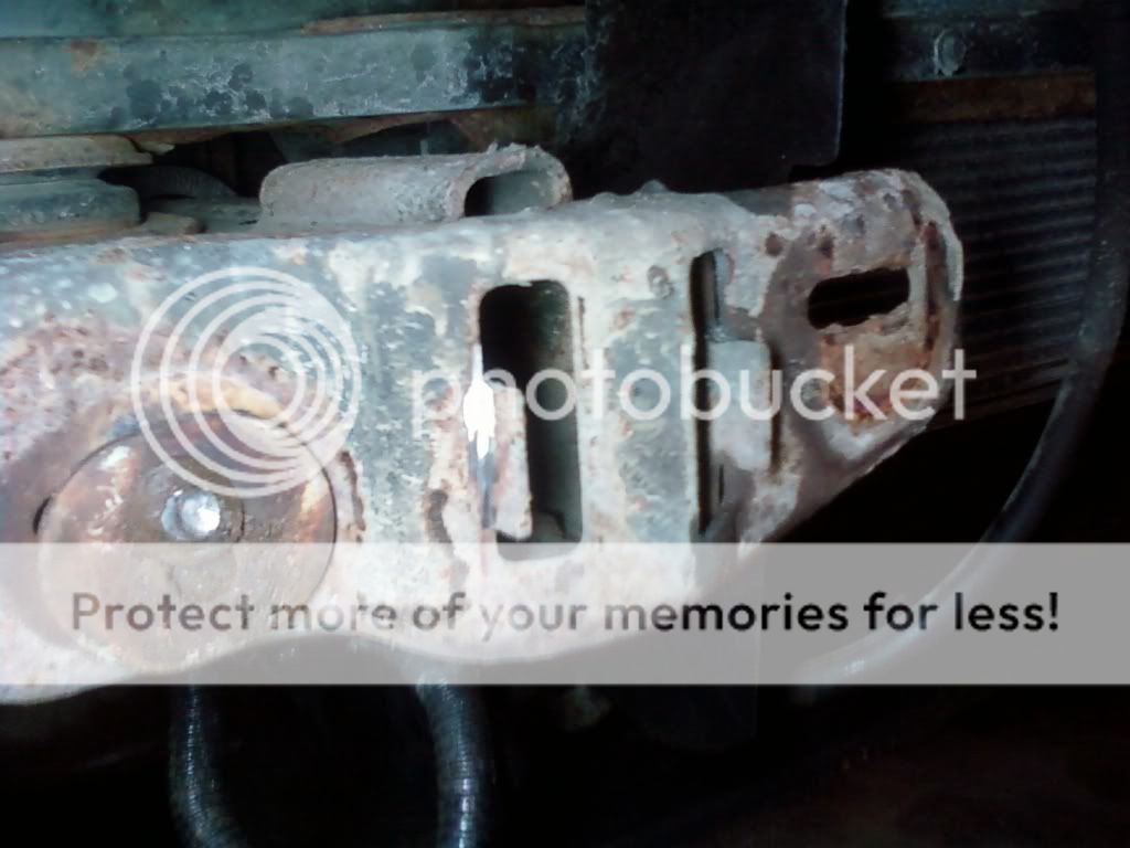

And here she is....bumper and bracket-less. Test fit for the new bumper is on Monday. My bodywork guy doesn't work weekends :annoyed: Oh well.

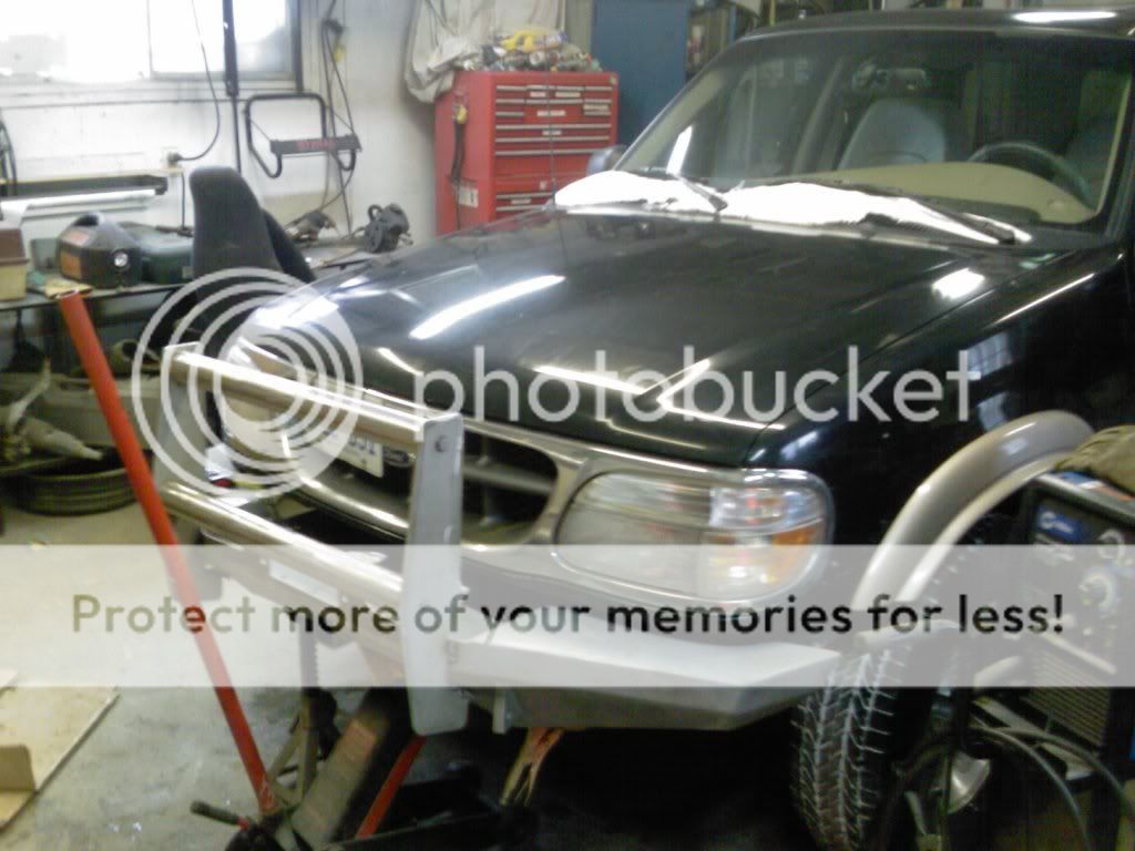

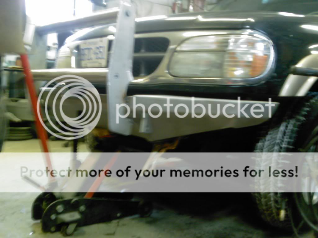

Alright....got the truck in today for the test fit! :yahoo:
Here's a couple pics...the bush bar is off a Suburban.
He had most of it welded before I left. It'll be sprayed in line-x tomorrow and will be ready for install by Thursday night. Just need to get those holes drilled in the frame now.
to each their own.. i'm going with a safari style bar of some sort. IMO yours would look better if the light bar matched the shape of the ex more.
I was back and forth about that...but you can't argue with FREE! lol
And it's not one of those cheap-ass wal mart bars either....it's actually made solid.
I pulled a chevy out of the ditch a few weeks ago and his "for looks only" push bar did more damage to the truck than anything else. It was directly responsible for pushing in his front end. Then as I pulled it out, the "skid plate" that's about as thick as a pop can got ripped off.
i say find someone with a bender and bend up some good tubing for a light bar... you won't be pulling on your light bar anyways... you have a hitch and clevis mounts right?? think about that... LIGHT BARS are made for LIGHTS, not pulling.. even grill guards are made for- well yeah, guarding your grill, not a tow point.. your d-rings and clevis mounts are for that...
cut that light bar off, go find someone with a bender and make one that matches your grill shape and covers the headlight area to is my opinion on it.
