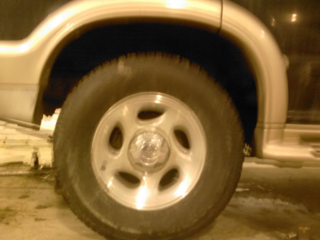

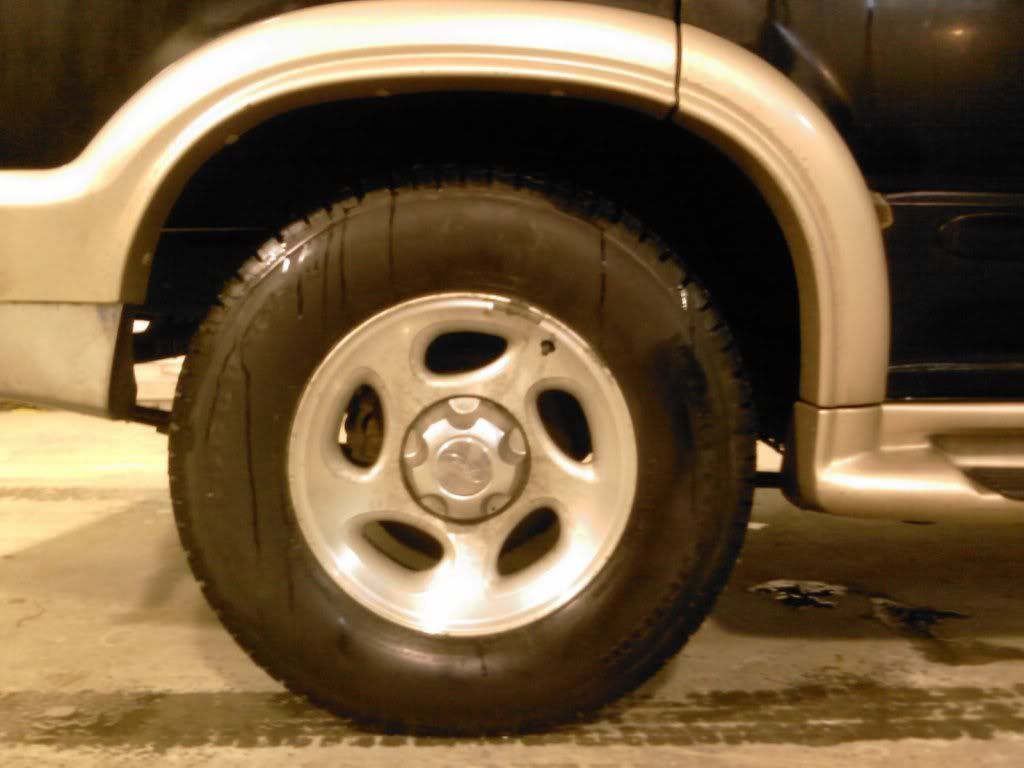

Last night I spent some time installing the Pro Comp add-a-leaf set.
Here's the proof. lol

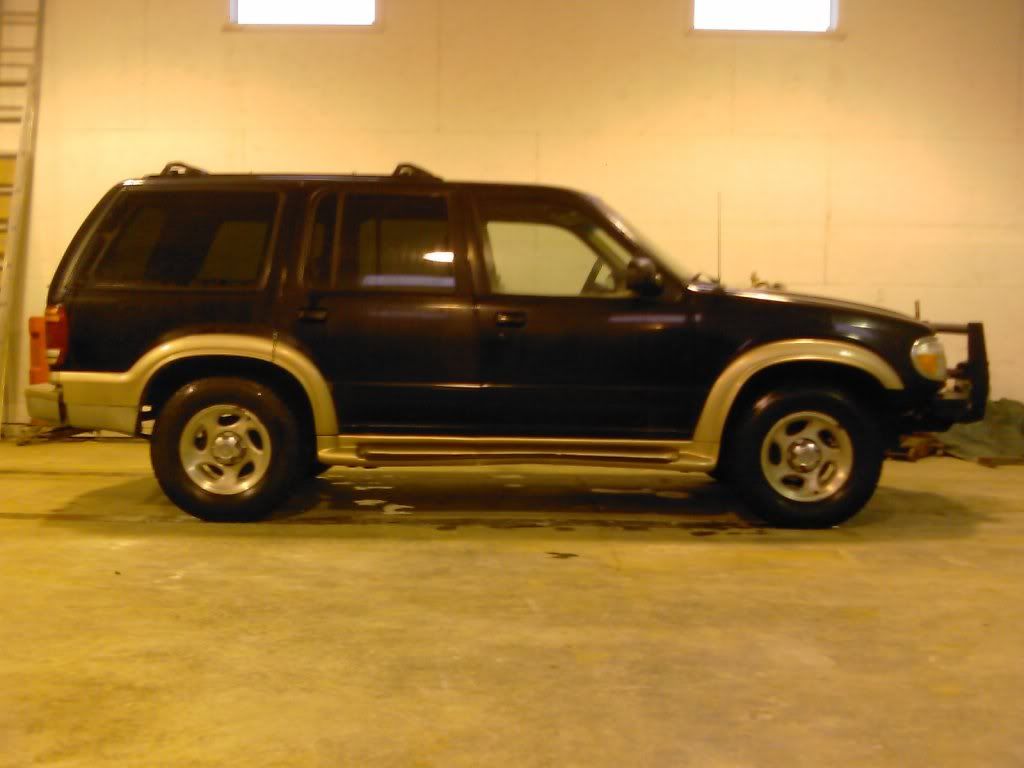

And here she is before the install.
And the ride height before...
Then the height after...sorry about the fuzzy measuring tape shot...
It's not much...I'm planning on installing Warrior shackles soon. Also going to do the TT in the next couple days too.
One thing I did notice is the incredible handling it has now. lol.
Thanks for looking
The sad thing is, is that that is the height a stock explorer should be...
Looks good!
Yeah...that was my thought too when I saw it. The shackles should make a big difference.
Also, I think it came up a bit more once I drove it a while.....I'll have to measure again to be sure.
