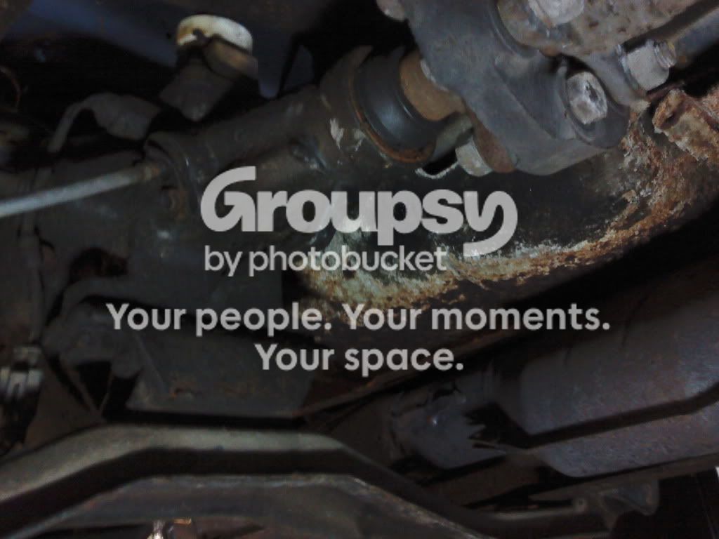

can anyone identify my trans?
Alright thanks. I just measured and it is about 73 inches from the axle flange to the trans. any help? haha
Ive never seen a tk-5 behind a 2.9.
I just saw this but what is in the bottom vent hole of the bellhousing (second picture)?
wow didnt even see that hah. most likely accorns. previous owner had it stored outside so im not suprised:annoyed:
so will the slip joint of a 98-newer ranger fit in a tk-5?
