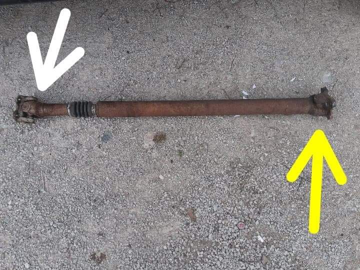

I haven't had a chance over the past week to work on the ranger. This afternoon I finally found the time to pull the rear shaft. I'm pretty sure that the rear shaft isn't phased correctly. Although I've had this truck for about 5 years and it's hard to believe that it has run for 5 years with the shaft not phased correctly and I haven't noticed any vibration.
There is no noticable slop in either u joint but since I have it out I'm going to replace them anyway. The shaft moves in and out on the splines just fine, no binding or sticking or anything.
I've included a picture of the shaft after I removed it. Can someone verify for me the phasing. All other rigs I have worked on with a slip style driveshaft had to be phased on each end. With the ear on the shaft on one end aligned with the ear on the opposing end.
Thanks in advance for the help!
