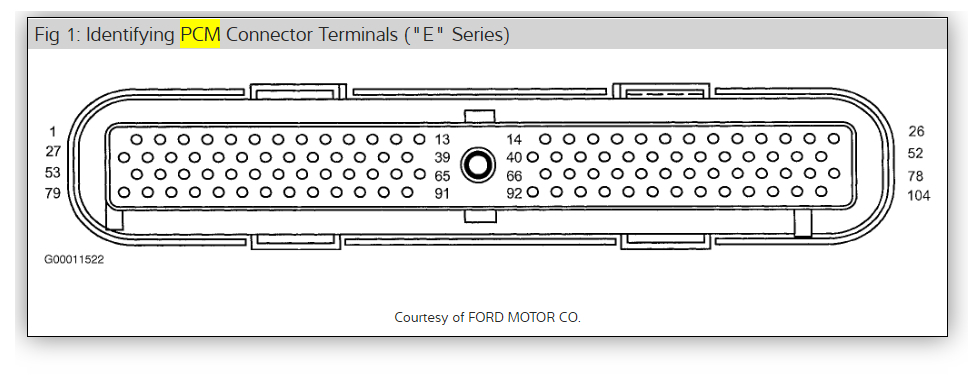

PCM is located in the upper firewall in engine bay, it has a larger 104 pin connector, can't miss it, lol
Has a bolt that holds on the connector
Disconnect one battery cable first
Remove that bolt and then pull off the connector, wiggle it back and forth, may need to remove some wire holders and/or tie straps
Pin numbers seen here when looking into the connector with the wires: https://www.2carpros.com/images/question_images/288731/original.jpg
Pin 2 should be a Pink/green wire just to confirm you are starting at the right place/orientation, this is the CEL bulb wire, just FYI
Pins 71 and 97 should be red wires, these are the 12volt wires that come from PCM Relay
Hook battery back up
Turn on the key
Test these pins/wires for 12volts
Pins 76, 77 and 103 are Grounds, test that these are 0 ohms to ground, black/white wires
If you have the 12v on 71 and 97
And 76, 77 and 103 grounds are good then PCM is a dead duck, failed, kaput :)
But unhook battery again
Plug connector back in
Hook up battery and turn key on to see if CEL comes on, if so the connector had corrosion on its pins, bad connections
Unhook battery
Pull off connector and spray connector and PCM slots with Contact Cleaner
