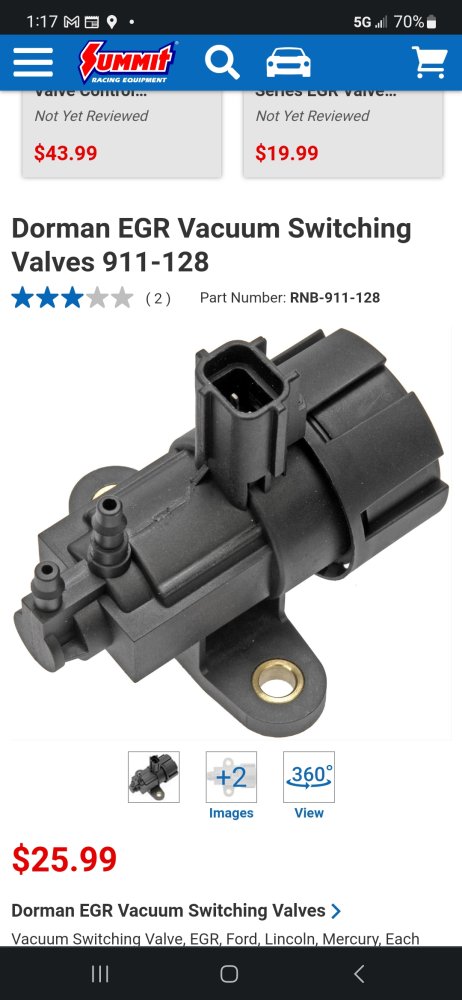

By "vacuum control valve" does that mean IAC? I would investigate that first on a rough/inconsistent idle... It's 2 wires that should just go to the ECM I believe, there could be something going on with one of them... I don't remember if '99 had a body module that interpreted the signal from the rear axle to get the vehicle speed but in that era the idle circuit in the computer took input from vehicle speed to smoothly transition to idle on decel if I understand correctly.

It does have a new IAC on it. I will check it and the wiring. I was told about the only thing they haven't "checked" is the under dash wiring. When the truck was body dropped some 15ish years ago they shoved the under hood fuse box under the dash somewhere, so that should be fun.
