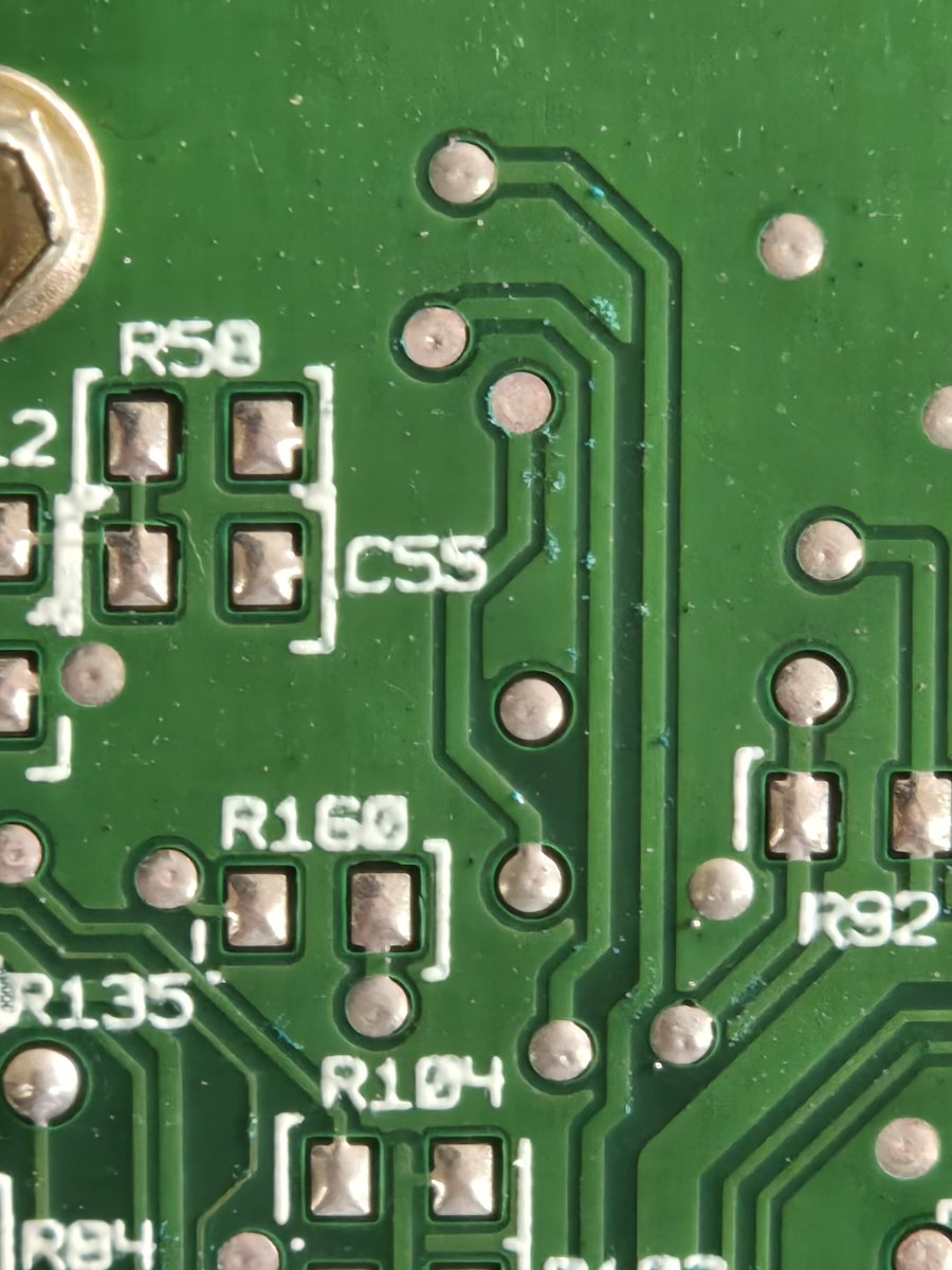

So, an update on my situation. Checked all junkyards in my area and had no luck finding the right model GEM for my truck. Took out the GEM and removed the circuit board hoping i could find someone to see if it was bad and could be repaired. No luck there either. So i took my phone camera and zoomed in and looked the circuit board over hoping i could find a break in the soldering or some sign of a bad resistor or something that tells me its bad. I did. I found very tiny flecks of blue green that looked like corrosion. I got me some electronic cleaner and a toothbrush and went to town on it. Cleaned it up real nice, checked all the connections and sprayed cleaner on them. Put it all back together and everything worked. Took it for a test drive using the wipers and running the windows up and down, got on a logging road and ran my 4wd. No problems at all. Everything worked just fine.
Hoping it stays that way, but for now, im happy i dont need to find a new used truck.
Thanks again for the help and pointing me towards the circuit board and connections. Saved me alot
