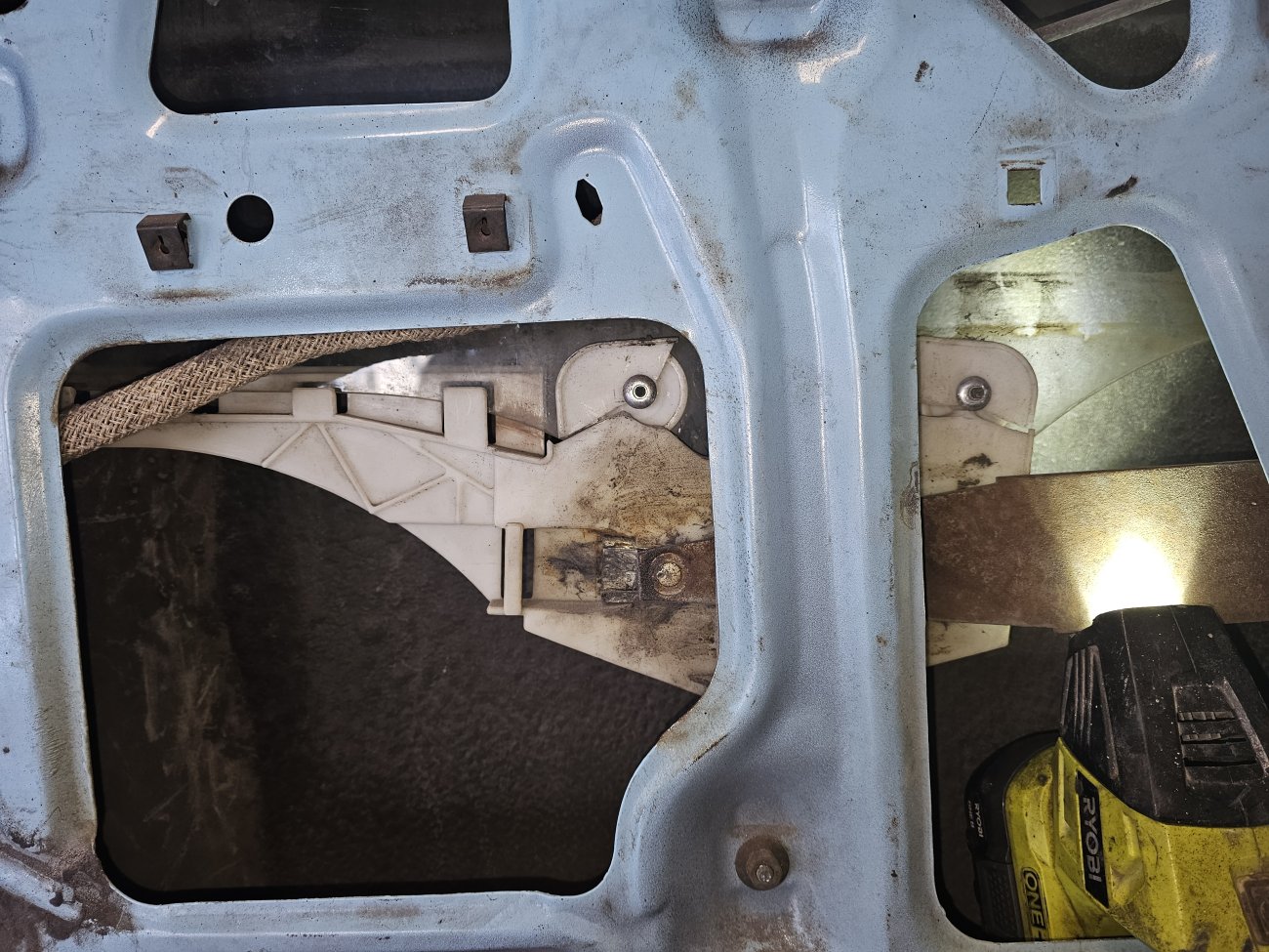

@hotoldsman sent me this photo... can anyone determine what's missing or needed here. My mind is drawing blanks.

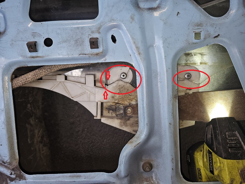

I had to look close, but I think that the white plastic window mounting piece is broken in his truck. See where I've marked his pic here:

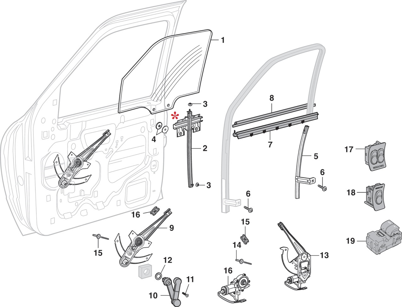

I took a quick look at LMC, and it looks like they don't have that part. It would go where the red asterisk is, here in the diagram from their website:
edit / add: I just noticed that I grabbed the wrong door diagram; it's for the '93-up, but the diagram for the '83-'92 door parts also show that the bracket isn't offered. Unless you find that part by itself somewhere, his best bet is to look into buying the window from a junkyard, as usually the bracket goes with the glass, and it'd probably be an easier R&R on the repair.

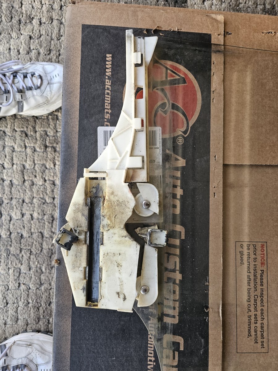

Does the window support bracket look like this? I'll take it! Drivers window and bracket? How much?
I'm not sure yet I'm missing some tools, I can get photos of it tomorrow when I have the correct tools. I do have the driver's window also. I'm in Montana, so whatever the price would be for shipping and 50$ for the bracket. As long as it's the correct one your looking for and I believe it's fully metal it does not have the side window vent on it.
No vent here either, $50 good shipping pay ok also, just blessed good part🤣😇
I sent ya a message, I'll get back to you tomorrow the bracket with photos. And I sent ya a message.
I think this bracket was updated after 84ish to a metal version. I don't know if the glass is the same or if you would have swap the whole deal over window and all.
